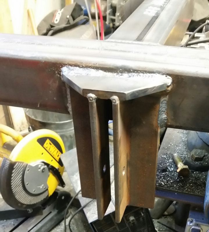

Got it put together yesterday, but I've been working on the power SSQA upgrade and parked is as far as the subsoiler got.

Put the SS to work Saturday.
First cut (hard to drive straight looking behind you)
Found some rocks
Lots of roots
Several stumps
Which eventually bent my cutting point
But that didn't seem to slow it down all that much. Then I tried tugging an oak stump that wasn't ground down, and wasn't all that rotten, and it broke the blade at the lower bolt hole. After that it didn't dive well at all, so I gave up trying.
I managed to bend my hydraulic top link cylinder eye during the pulling, so I'll need to fix that and as such, I left the SS up North this week. I'm probably going to get a ripper tooth for a excavator bucket to replace the cheap cutting edge. I had a feeling that one needed more support, more mass, or both.

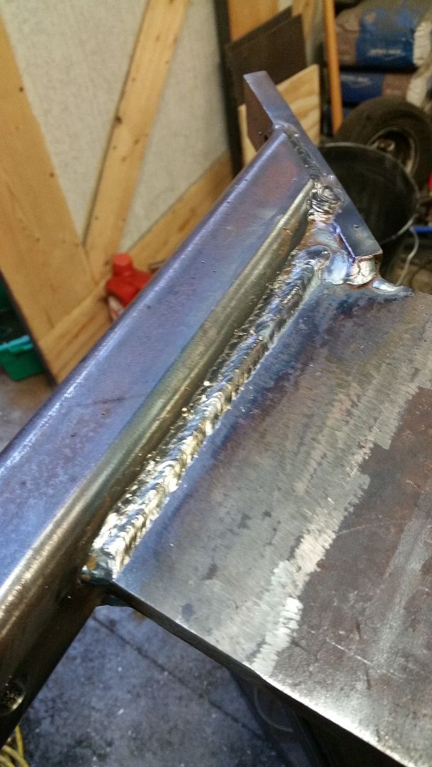

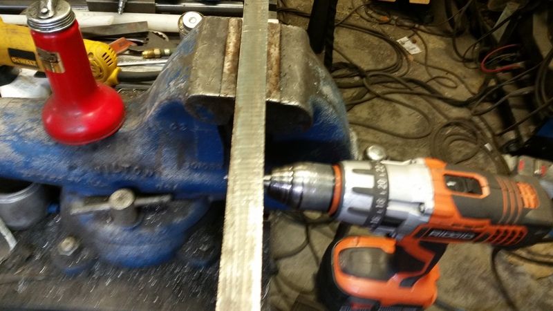

I'm going to see if Zeigler has any used excavator teeth I can grab, and if not I've got a good bit of 1/2" AR400 drops from cutting out IPSC targets that I can use to fab up a new one.

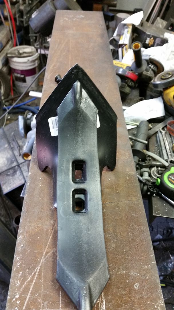

Stopped by the local Cat dealer hoping to do some dumpster diving, and instead was given these after I explained what'd happened and what I was looking for to fix it. :D
   / Subsoiler build #35
You would be shocked how much those things cost new. $200 to $300 each is a wild guess, maybe more.
   / Subsoiler build
#37
SD, I'm sure they're north of $100, but even a whole ripper shank for a D5 is only $300 (which I thought was remarkably reasonable considering it's only $2/lb). I was offered more points, but I wasn't there to take advantage of them - I really only wanted a peek in their scrap dumpster to see if there was one I could weld up. :laughing: I didn't even get dirty. :D
Jacain, first, thanks! As to spray: I have in the past but it's been several years for my personal stuff. Getting up into globular is as hot as I run most of the time. I've done pulsed spray at a job briefly, but not enough to be any kind of expert on it.
I still have my 98/2 bottle, but it's stuffed in a corner behind a bunch of brake rotors I've been holding onto for target stand bases (I should clean those out and put them in a ballast box). One of these days I'll mess around with the pulser on my MIG and work on that. I've always been more of a "I know I can make a good weld with short arc, so I'm using that" kind of guy. Getting fancy isn't as important as a good job that'll hold up to me.

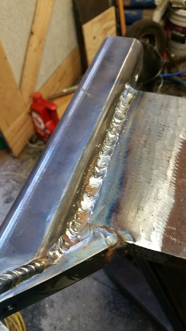

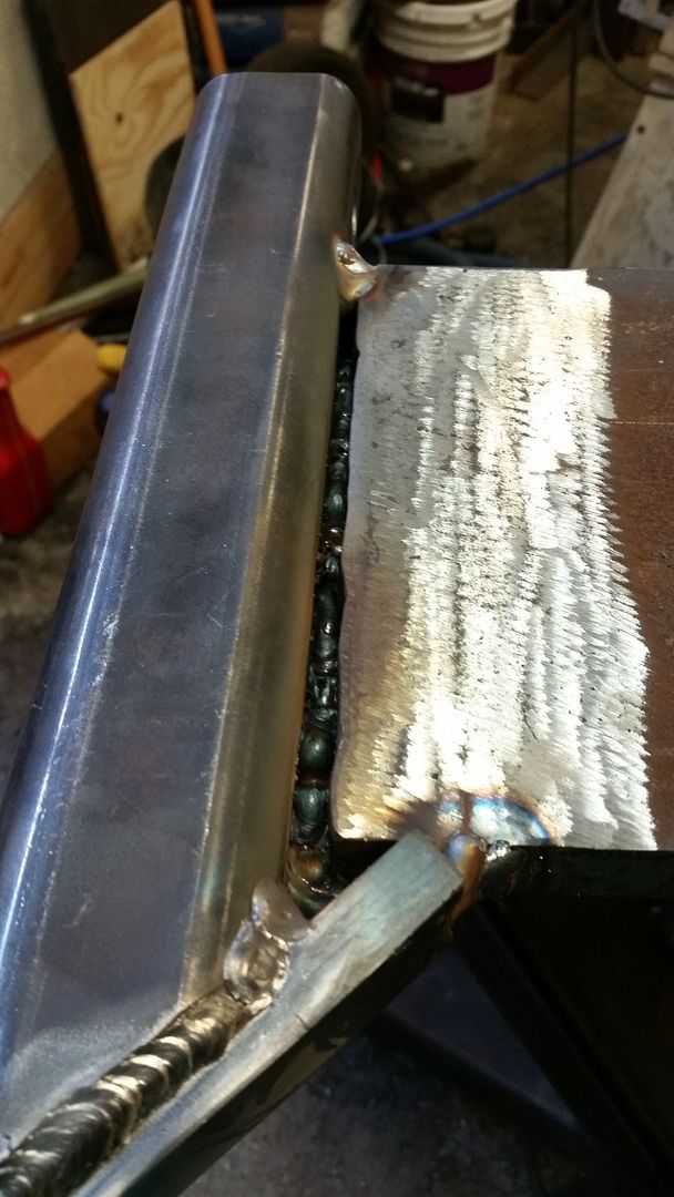

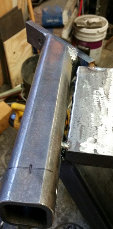

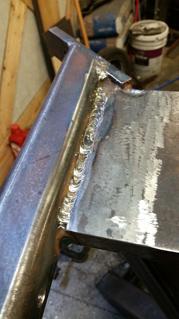

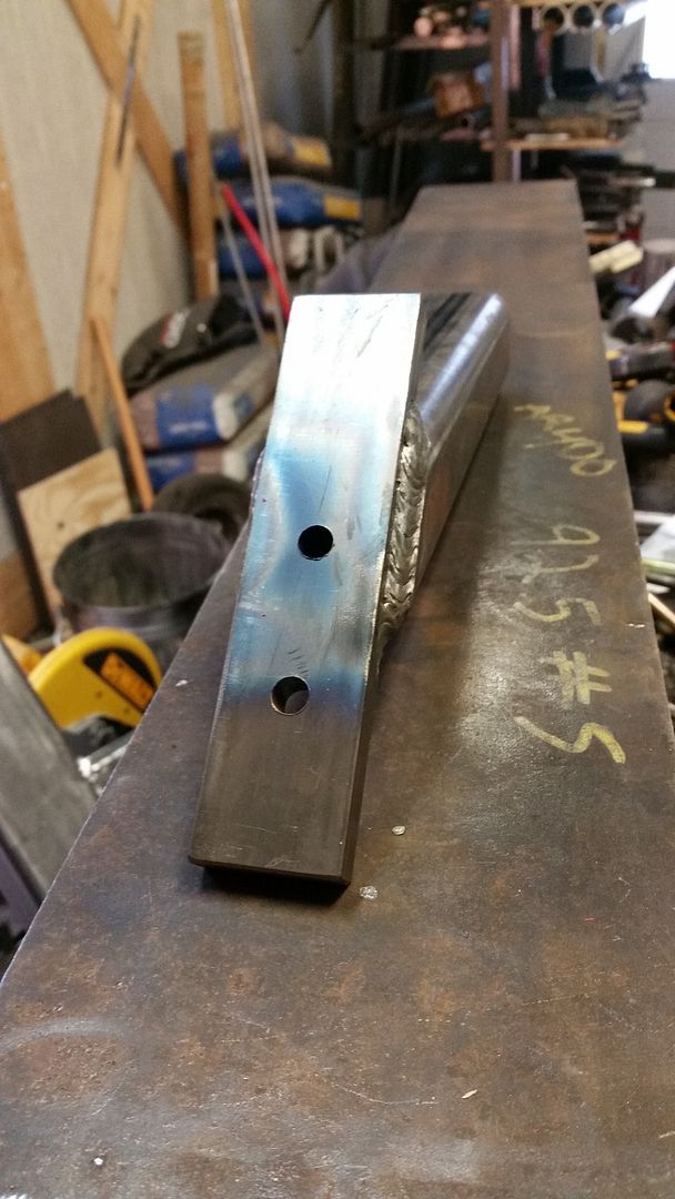

Got the shank home and modified. Ready to go back up and get back to work. :)
