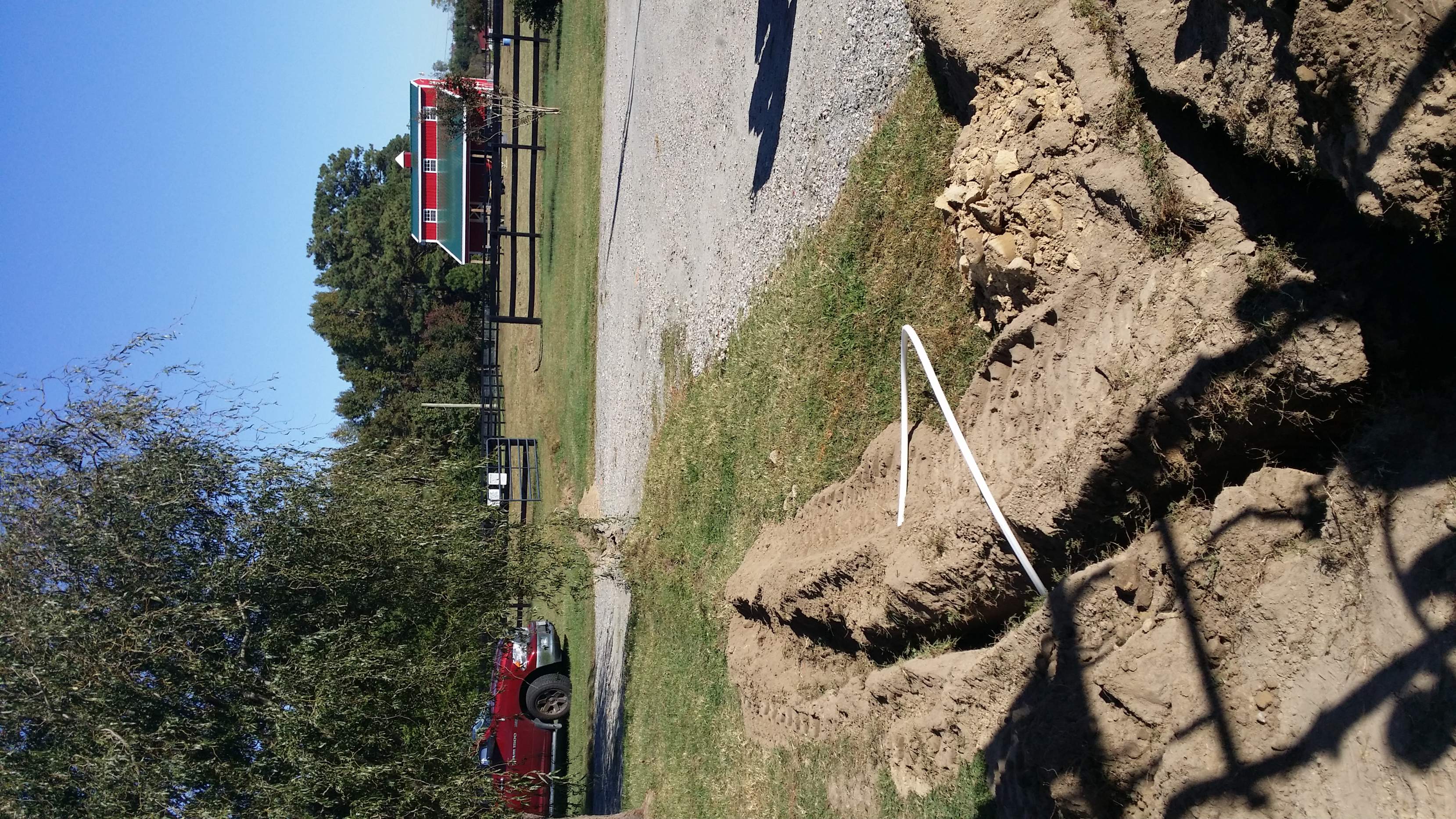

Works great. Made a few passes first and then pulled. Only hard spot was the first 10 feet and keeping the pex and wire from just pulling down the trench. Once I figured out to tie it off, it was fine.

Nice job, Atono. Curious how far down your rig buries the tubing and cable, and whether the depth stays consistent. Is it below the frost line where you're located? Around here, electrical cable other than low-voltage must be 24", and the water pipe 36", so I went with a track hoe for the 300 ft to our barn and frost-free hydrant. I have a sub-soiler that I no longer have any other use for, so this is an interesting idea. Here it would be great for low-voltage runs, and for irrigation pipe that's drained for the winter.
   / Subsoiler for burying PEX #28
I've been keeping an eye on this for that reason as well. I doubt my subsoiler would quite make the wiring depth, much less clear the Colorado freezing depth.

Frost line doesn't ever get below 18" here, so I am pretty comfortable that it won't freeze. Matter of fact, most hydrants folks install around here are at 24".

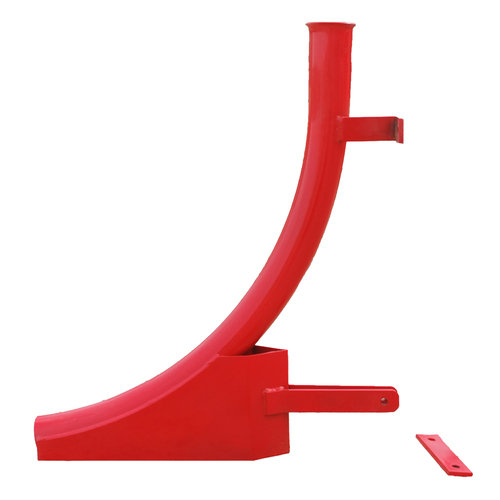

It works, but Agri supply sells them for around $80, not including subsoiler. Hooked it up to my old tractor supply Company subsoiler without much problem pulled in a bunch of sprinkler lines
   / Subsoiler for burying PEX #36
Also I haven't really been able to bury below 6 inches starting from Grade, which is fine for sprinklers but.. On the other hand I think I could get it lower by digging a starting hole down so I'm not trying to pull down, just straight.
I was originally going to pull pex but decided 160psi poly was cheaper and made more sense.
#37
Looks good, but I'm not sure it would bolt up to the Fred Cain subsoiler I found. ASC says it works with 3 Point Subsoiler-Subsoiler Attachment | Agri Supply #73410
Anyhoo, finished up all the backfill today. All the water connections are dry and all the electrical works fine. I did take the added precaution of putting GFI plugs in both circuits.
