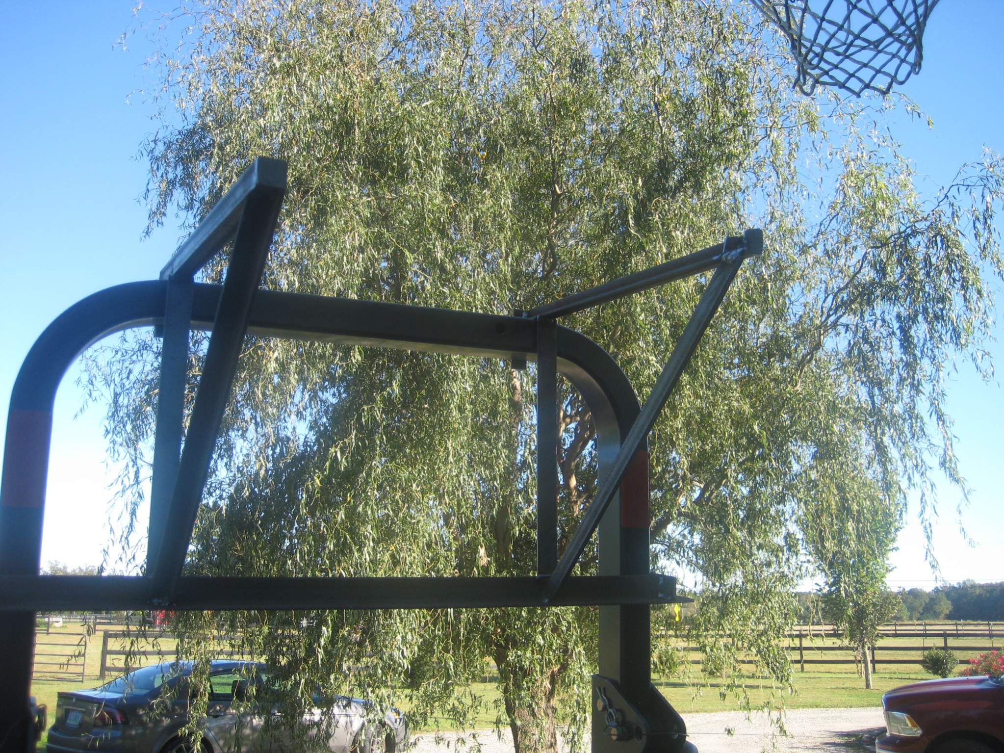

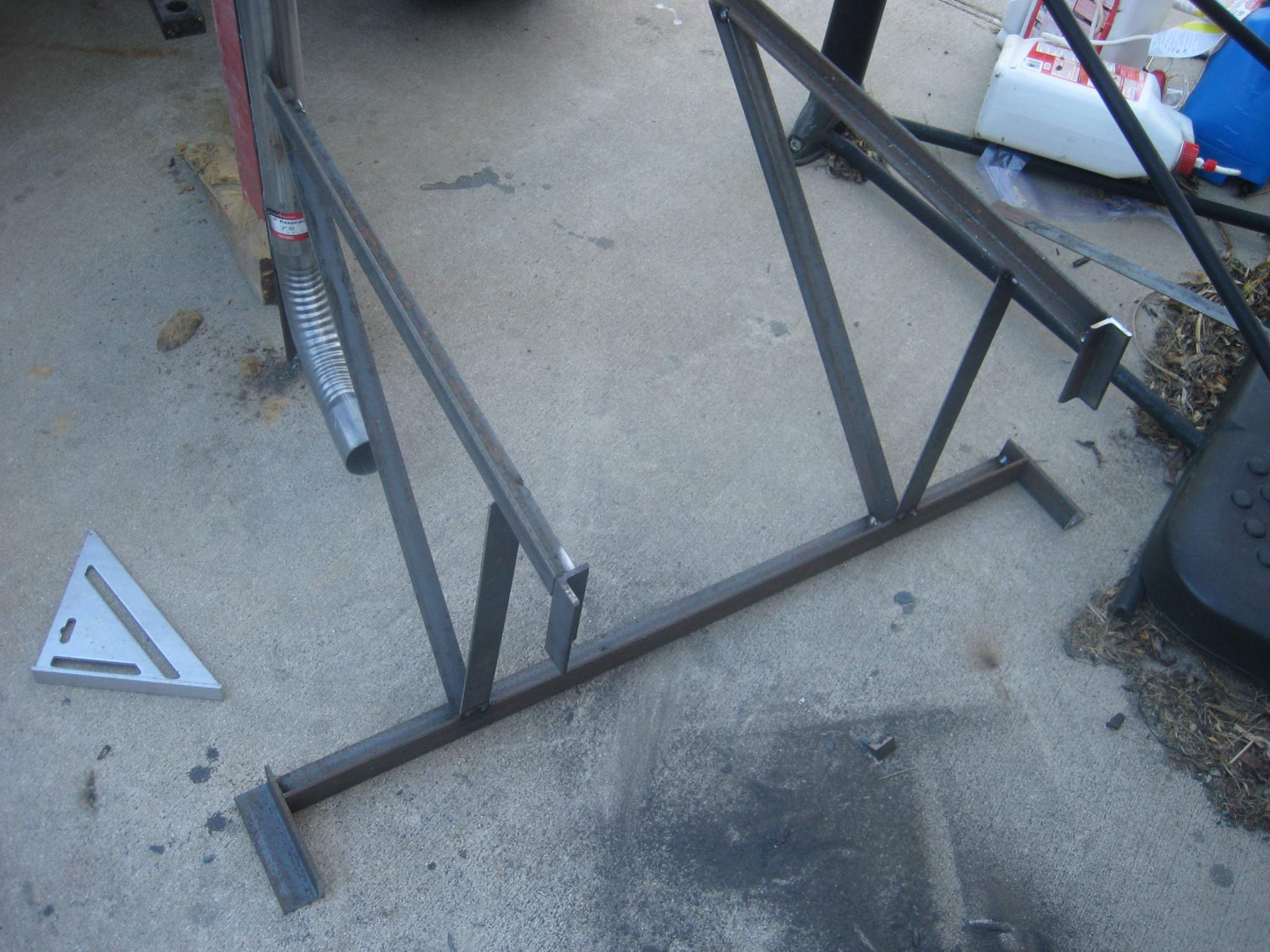

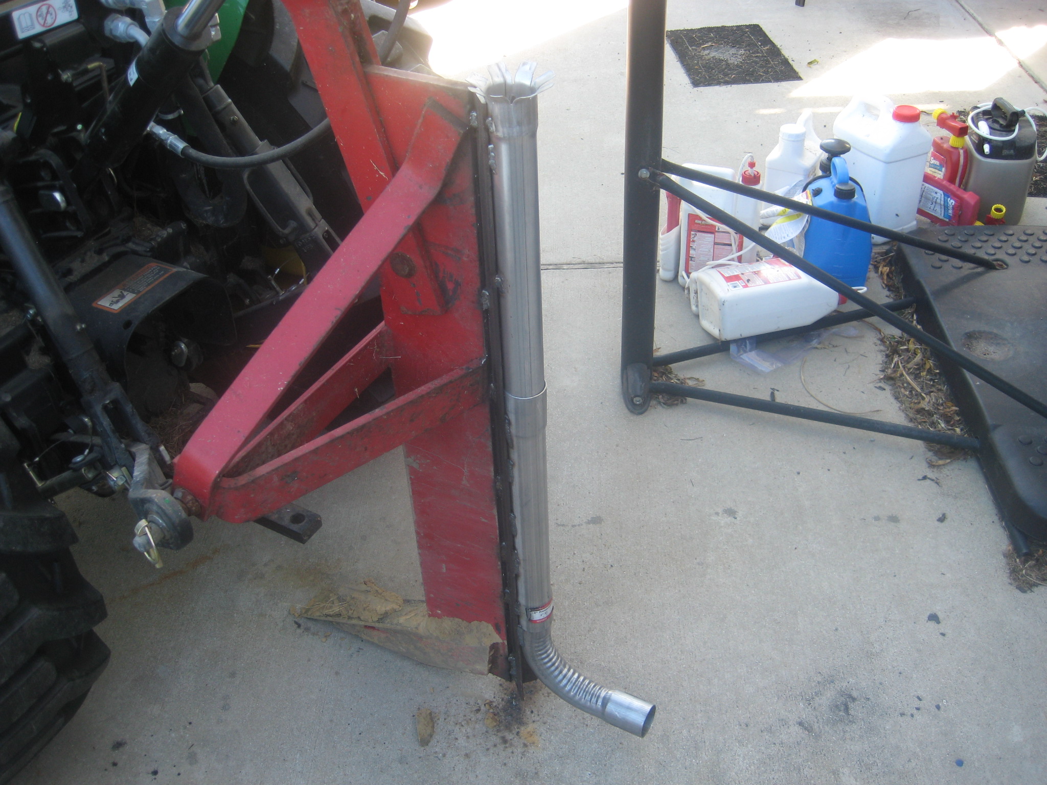

Found this subsoiler on Craigslist listed as a "1 row planter". Talked them down to $80. $20 worth of exhaust pipe from Autozone and I am hope to bury about 750' of 3/4 pex and about 500' of 12/2 UF with it. I will let you know how it works.

That's what the thing hanging from the ROPS is for. The crossbar comes off and the roll of pex will hang from it. Are you saying the roll of pex won't spool off?

When burying electrical cable or Tylene water hose, you need to either have a wheel in the pipe to put the hose down into the furrow, OR you need a man walking beside the subsoiler to push down the hose or cable into the guidance pipe, otherwise you'll get so much friction that it will rip off the cable or hose.

One thing I have learned is to make two or maybe 3 passes BEFORE you insert the cable/tube for this type of plowing in. That way it loosens up the soil in the first pass and it is easy to follow your wheel path to keep the sub soiler in the same trench. The person who said no Ts underground is the way I say too, sometimes ya have to but avoid it like plague if ya can...
