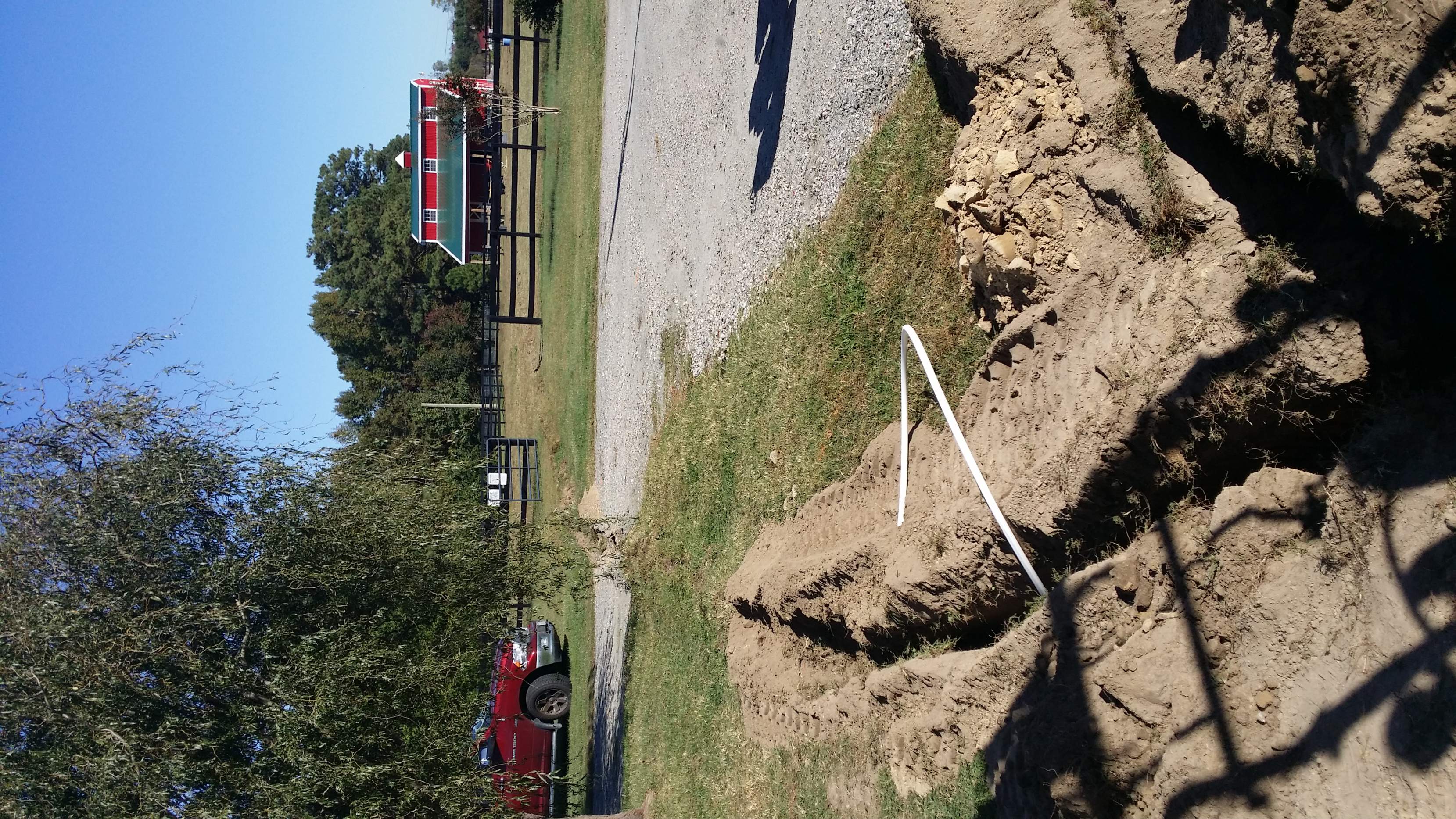

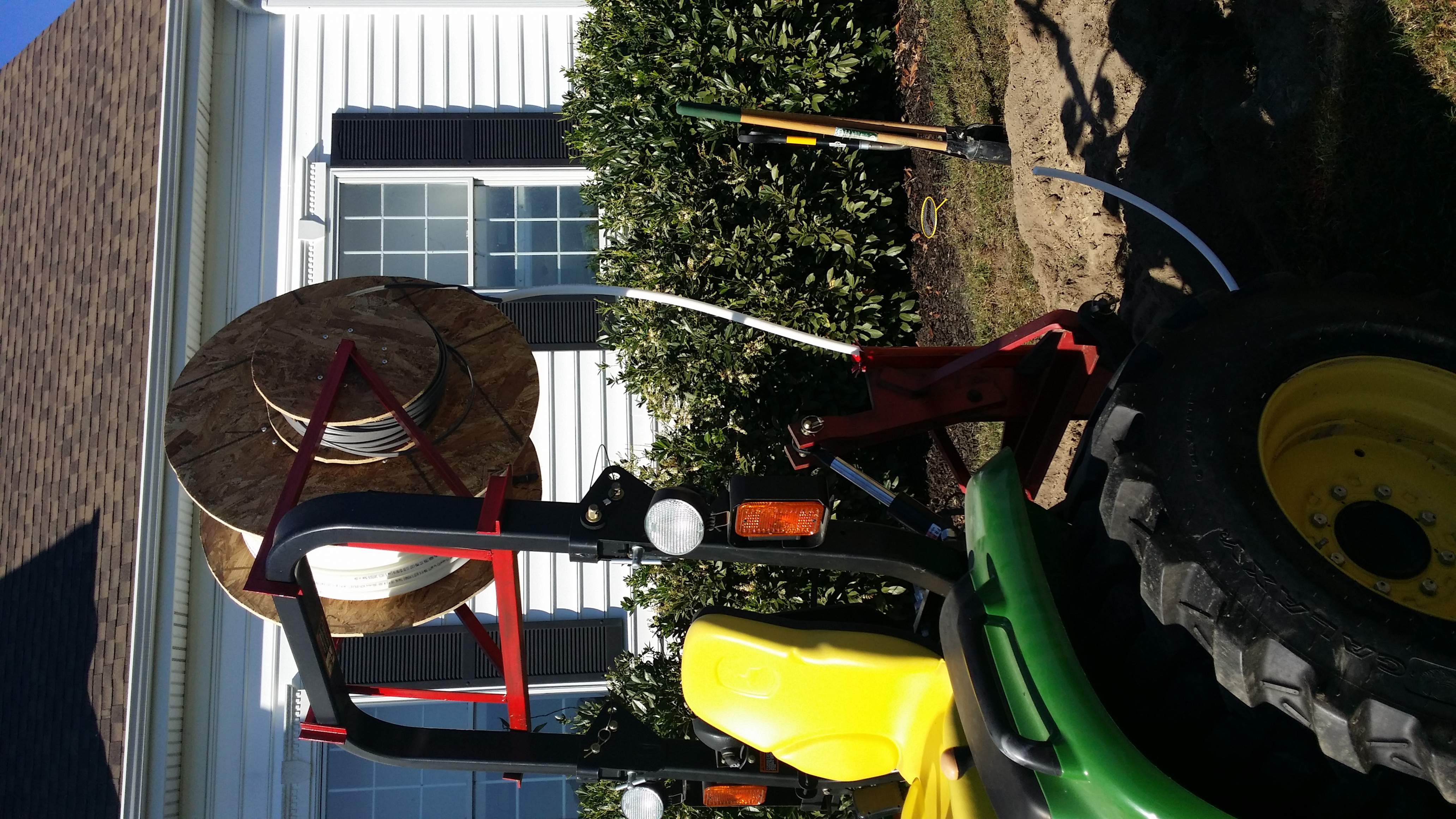

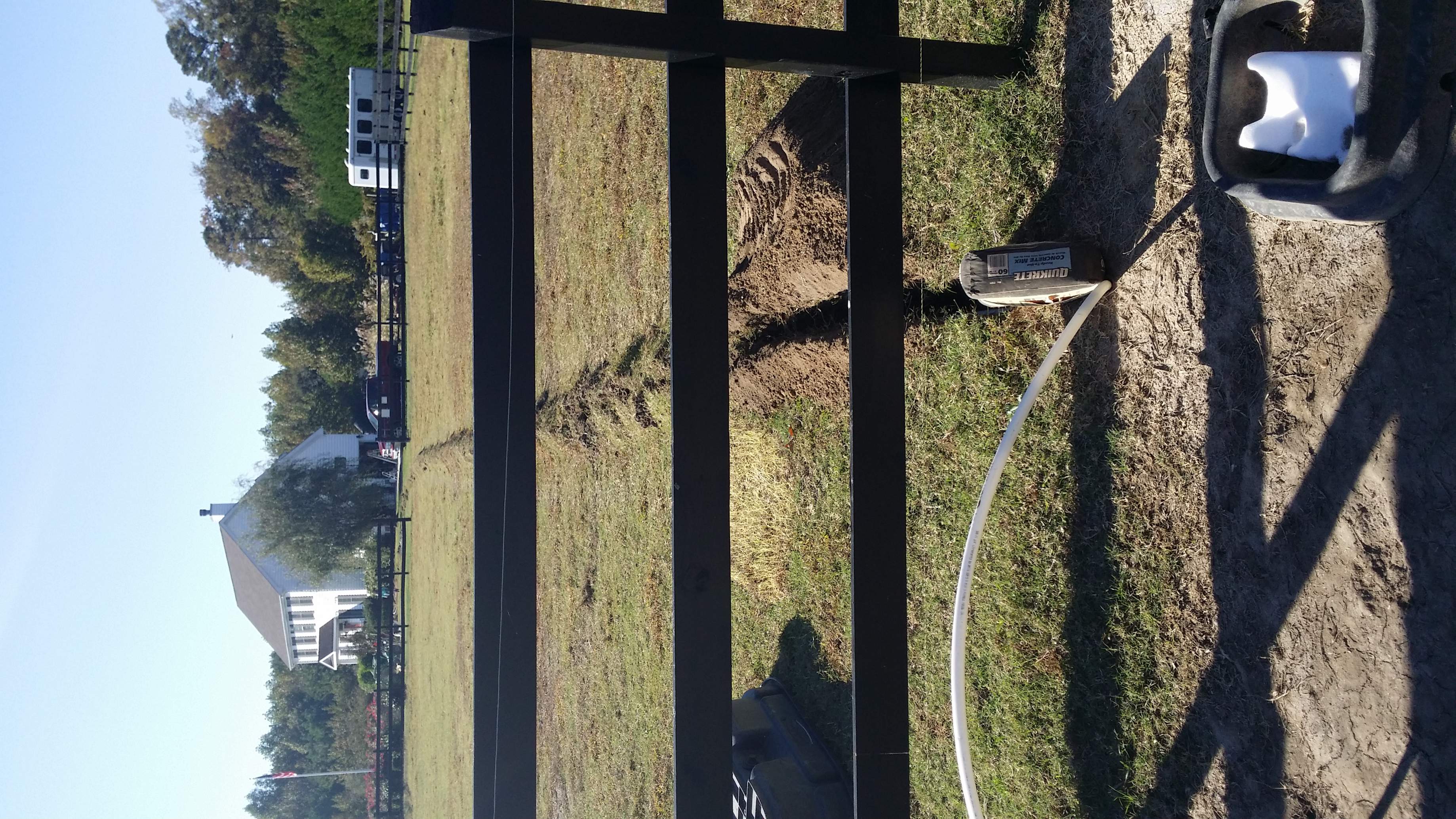

Works great. Made a few passes first and then pulled. Only hard spot was the first 10 feet and keeping the pex and wire from just pulling down the trench. Once I figured out to tie it off, it was fine.
   / Subsoiler for burying PEX #25
Looks great. Remember to keep it out of the sunlight while you are working on the rest of the install.

Nice job, Atono. Curious how far down your rig buries the tubing and cable, and whether the depth stays consistent. Is it below the frost line where you're located? Around here, electrical cable other than low-voltage must be 24", and the water pipe 36", so I went with a track hoe for the 300 ft to our barn and frost-free hydrant. I have a sub-soiler that I no longer have any other use for, so this is an interesting idea. Here it would be great for low-voltage runs, and for irrigation pipe that's drained for the winter.
