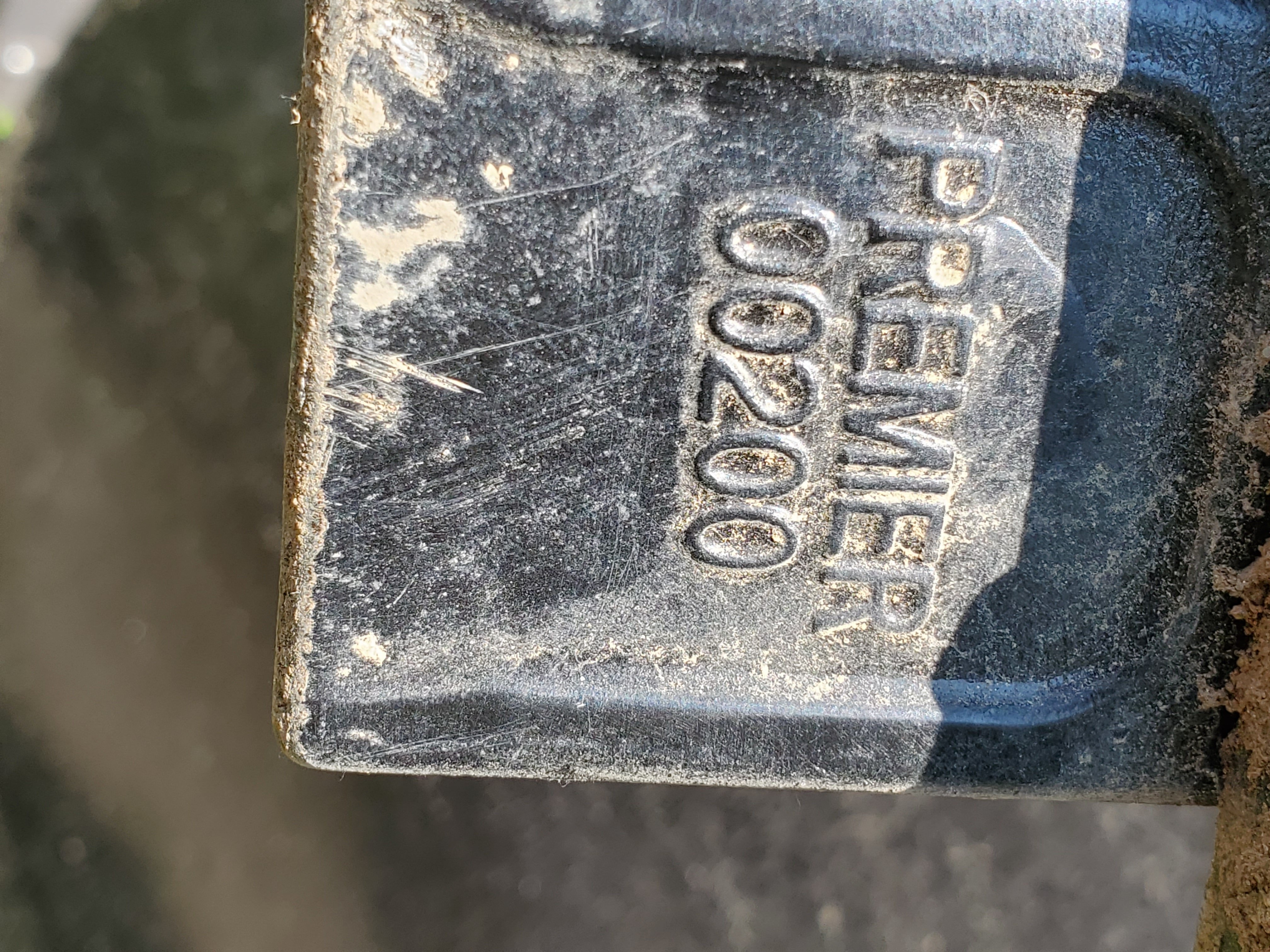

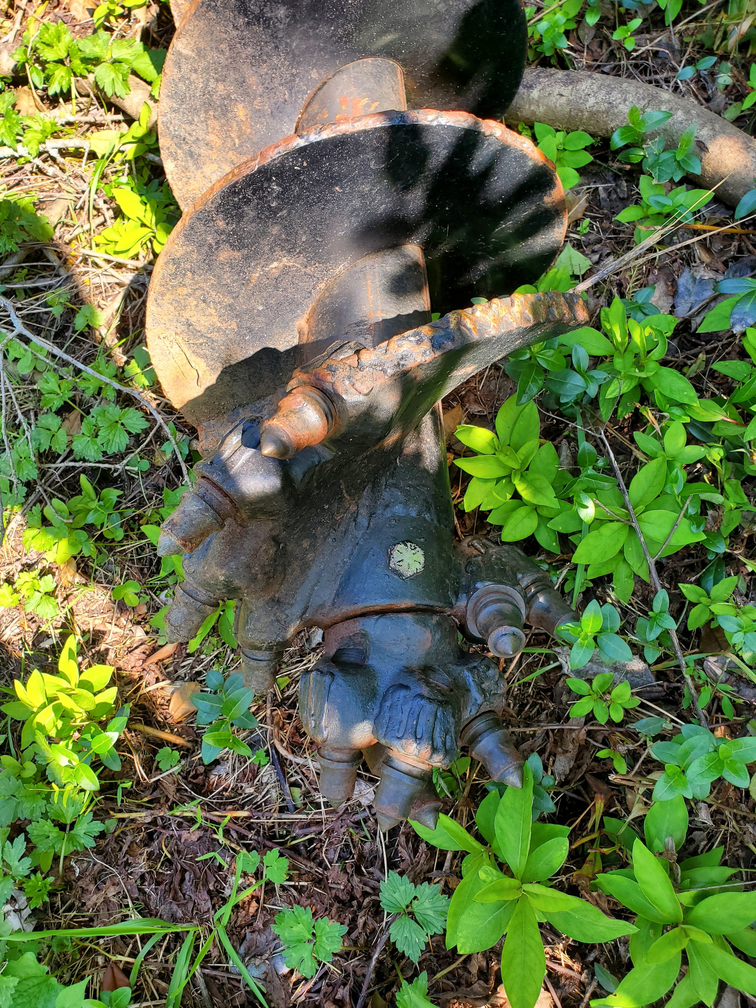

A SSQA mounted hydraulic auger either on tractor or on skidsteer/tracked loader works really well in rocky soil. I have two different styles of auger bits. One with spade teeth on leading flute edge and others called rock frost bits with carbide tipped cutting edge flutes along with hard edging added to flutes to minimize wear when operating in rocky and sandy soils.
Yes, they can jam but reversing them out is a breeze and NEVER got auger stuck in a hole and my N. Carolina soil is filthy with rocks.

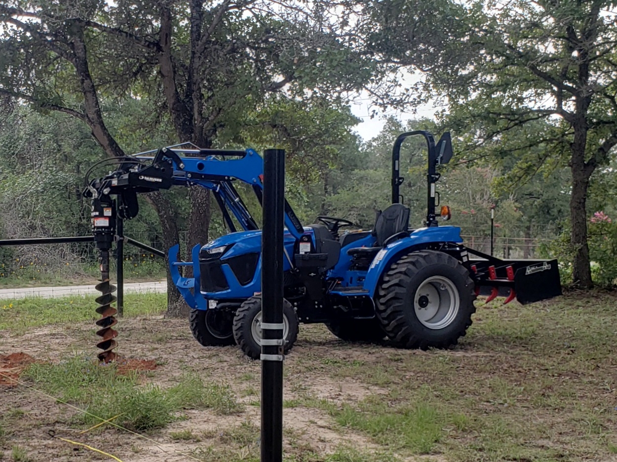

   / Suggestions for a post hole digger? #26
that's a nice big tractor you have, have you though about a hydraulic auger?
Made in USA Digga 2DSS Auger Drive Unit
Been working great for me. Easy hook up, reversible, visibility, etc.
When I first looked at your pictures, I immediately though of AL soil; looking at your avatar confirmed my assumption.
That IMO is a great way to dig post holes. My 3-pt auger is a pain in the neck to use_literally.
