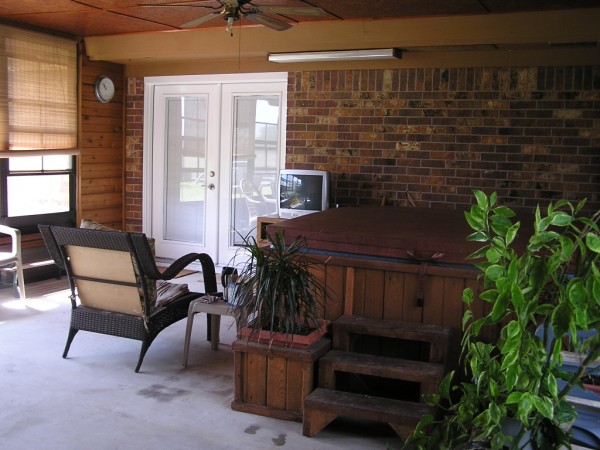

We have a hot tub/spa in a screen room now. The room is 18x20, The spa is 8x8 -- unless you plan on having spa parties you can do with a smaller spa - our next one will be a 3 seater instead of this 5-6 seater. AND I want to add a sauna -- around $1500 -- You want 2-3 feet of space around the spa- at least 2 sides - 3 is better. This is for access and tables/shelves to sit your drinks.

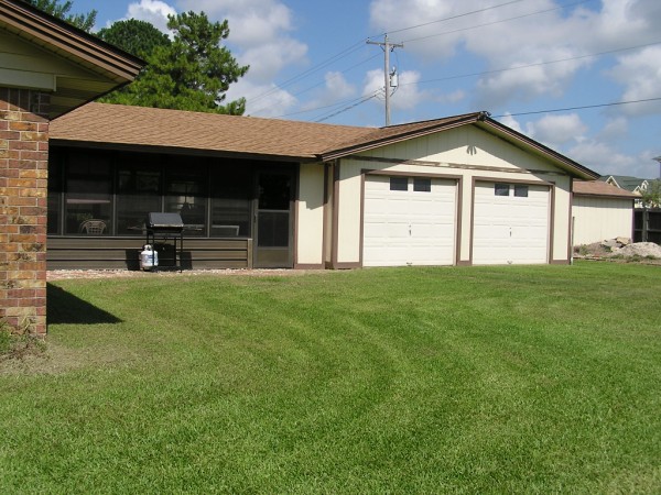

Do you find that you have sufficient ventilation through the screens?
plenty -- the screen room is between the house and garage so is only screened on 2 sides -- I kept a close eye on the ceiling for awhile for moisture as the ceiling is particle board -- but there has been no problem. The screens are from 18" from the floor to the ceiling -- It's made like those Florida rooms with the plastic windows that slide up and down. The spa sits in a corner with shelves on the 2 corner sides.

   / Sunroom ideas - Help! #19
on the sauna -- I saw one at the Houston home show last week that they wanted $2000 for -- a quick search on the internet shows you can buy one for around $1500 --- All are the IR type that I was looking at. -- 2 seaters - Takes 115v 15 amp and reaches 140 degrees. AND that's all I know about that .:).... other than using a commercial one several times at different places .... I've never seen a private one other than that one at the home show.
