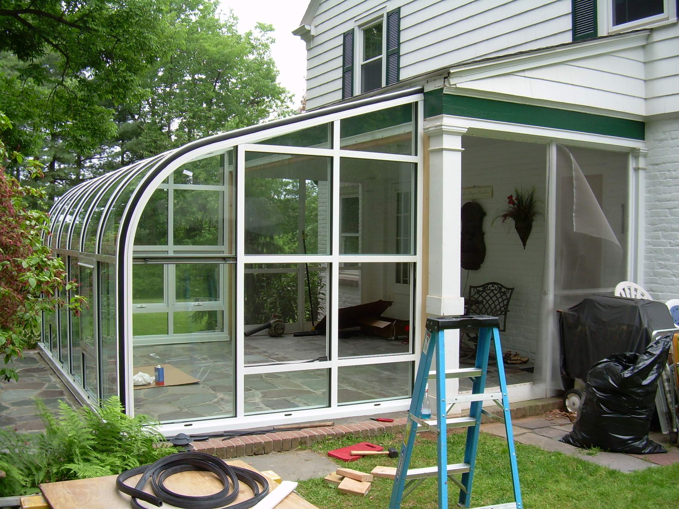

I have always liked that style. But, due to the particular layout and style of this house, it appears that I will be limited to something added at this gable end of the house.
Yeah I saw your picture, that will be a nice space when you close it in. I thought maybe that company offered gable end fill ins?
That's alot of glass you'll need there, will get pricey.

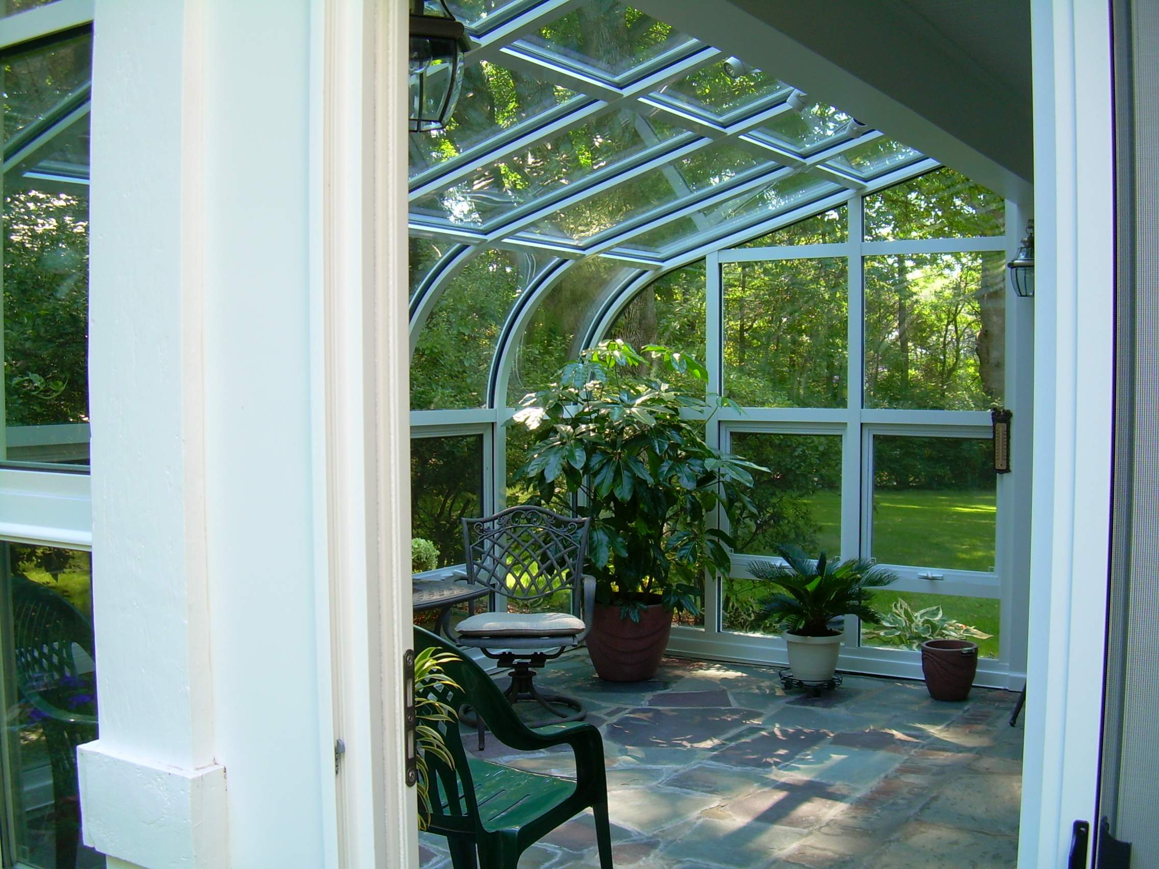

I got a good bang for the buck with mine, makes my first floor seem bigger now, I have a door from the living room and one from the dining room. made that narrow screen porch that got crowded with 3 people, now we had 20 people seated at 2 banquet tables at thanksgiving and room for serving table as well.
Mine was simple to spec, it was a standard size and fit with little rough in, even the roof angles are close.

/ Sunroom ideas - Help! #14
I would go with low-E glass. Big glass means it should (probably has to) be tempered too. This will keep the temperature moderate. Want to make it seem bigger? Knock down the whole wall and make it a year round space. You'll be glad you did. Heat and cool it with a mini split heat pump and maybe a stove or gas fireplace.
There are a lot of ways to get a "Sun" room. Consider true floor to ceiling windows and fixed, but ventable skylights. Casements give you the best view, but have to allow for space opening outward. Nice full length screens can either be left in year round or taken out.
I did a similar project 3 years ago. Took out 26' of load bearing wall to add a 16 x 26' addition. Used 9' walls on new part with cathedral ceilings (scissor trusses). 7' tall windows and matching doors all around. Four fixed skylights with shades. Heat it with direct vent propane fireplace (furnace rated). Cool it with mini split and one giant ceiling fan. Beautiful! Absolutely love it. My smotheringly small 9 x 10 kitchen now feels 4 times as big.
