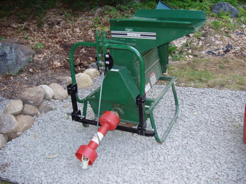

I went to a local dealer this afternoon and they had the smaller DR Chipper in stock - for just under $2k!
I'm sure it's a very nice unit, but at about 3x what I paid for mine (even with the machine shop work I had done).
One of the things they did was to add a lower bracket so that the draw pins could be moved down, which gives me a lot more ground clearance. The parts painted in black are the ones added.
I've probably got about 12 hours on this unit and really like it a lot. Over the next couple of months I'm going to make a dolley for this (and another for my BH) so that I can easily move it into position for winter storage.
