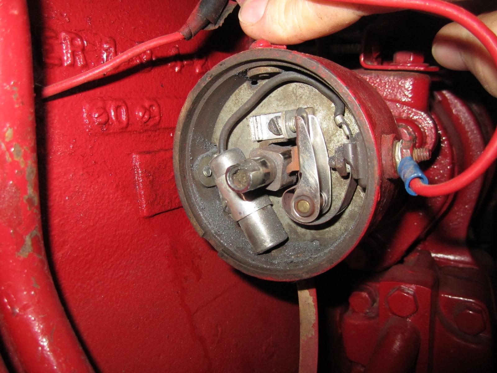

I mentioned in another post that my SC would cut out a bit sometimes idling and under a load...pulling my 2-12" moldboard plow. Another symptom was the SC exhaust was very sooty. It spat black specks all over the hood especially when I first cranked it. The Zenith up-draft carburetor has only one tuning screw. I monkeyed with that a bit with no success. I surmised that the timing was off and that it wasn't efficiently burning the fuel. The problem I had was that at some point in this tractor's lifetime, the TDC "pointer" had been removed. I could see the marks on the crankshaft fanbelt pully but there was no reference marker on the frame of the tractor. I was told that this "pionter" consisted of a bracket that was bolted to the front of the block near the hydraulic pump. I finally asked a retired IH mechanic to take a look at it. He noted that my distributor had some "play" in the shaft which was typical. In order to compensate for this, the previous owner had to open the points a good bit...in fact way outside what the service manual calls for. He also noted that inside the distributor, there was a good bit of metal shavings. He recommended that I replace the points first and see how well we could tune it. I should note that my SC has been converted from a 6V to a 12V system...and it does not have the magneto system. The distributor is purely stock (same as when it was a 6V). Here is a photo of the inside of the distributor with the shavings.
I'll update you on the outcome.

ifthe dizzy bushing are wore so that points gap is irregular.. it's gonna be a bear. incorrect points gap leads to lots of other issues.
those shavings will cause problems of their own.
i se ethe rubbing block and cam are desert bone dry.. they should have some cam lobe lube on them.. and I'd find out whats been rubbing the shaft where it's polished shiney..

Could very well be, that under the breaker plate, and governor weight guard, one of the springs could be broken, on the dist. gov. weights, making the shavings. If that is all the damage that would be done, it would be a somewhat inexpensive repair. A new set of springs run about $24.00. That could very well explain some sluggish response also. I found rebuilt distributors online for $259.00 and up, with a $100.00 core charge.

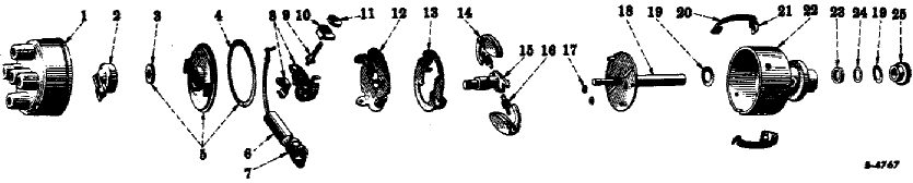

/ Super C Distributor/Ignition #4
Here is an exploded view of that distributor. Note part #15, which they call the cam, the rotor button attaches to. It slips down over the (#18) distributor drive shaft. And it doesn't show any bushings in the housing to be replaced.
I'm guessing the shiny spot, is just where the bottom of the rotor button has been riding.
And, yeah, I looks plenty dry. Guess they didn't know what that little red capsule (or used to be) was for.

You are dead on the money! I took the distributor out and tinkered with it most of the morning. Yes, one of the spings had come off (looks like many years ago) and was totally demolished. All the metal flakes came from the under-side of the breaker plate where the mangled sping had no where to go. The "play" we saw in the cam shaft was "rotational play" due to the lack of spring tension on the weight arms. I am very surprised at how well this tractor ran with this major failure in the distributor.
No wonder the tractor ran so inconsistently!
I scored a used distributor from a bone yard up the road for $50. The housing is not as good as mine, but is in good condition for a 60 year-old part, and good enough to run :thumbsup:. I'll give it a try tomorrow.

yep.. that 'play' rotation is your advance.
looks like a cheap fix, and it will take load better now!
DO clean and lube the rubbing block.
