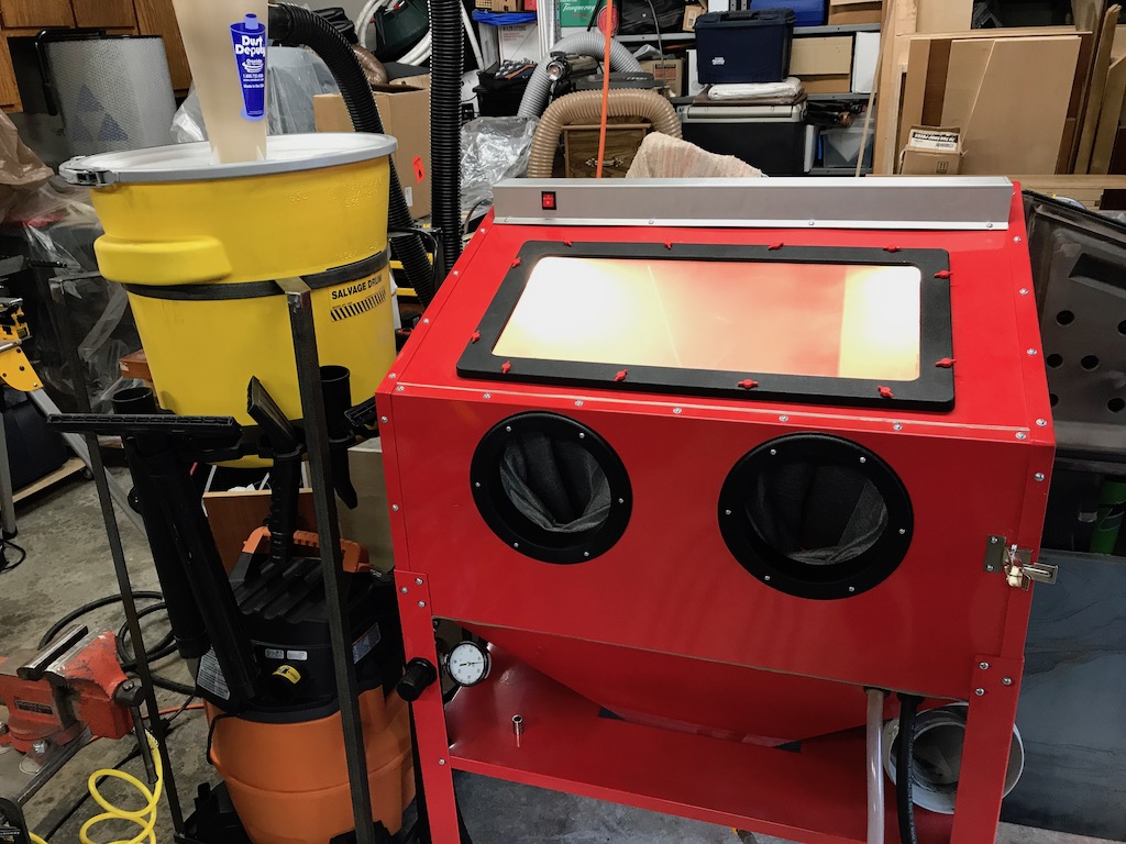

Would be interested in your blast cabinet setup, I have a HF cabinet that I've never used, hope to get it online once I get the new shop built but I know it'll need some help.
Trying to figure out a cost effective dust evac system.

Here is a pic of my setup. Lots of mods to the HF cabinet thanks to Tacoma Company. But overall idea is portable and transferrable dust collection. The dust deputy mounted on a sealed bin above my shop vac. Welded up a light weight support frame and all on casters. Basically a pre filter before my vac. Probably worth a separate thread if folks interested but I can move this between tools. Blast cabinet, miter saw, router table, etc. I also have a dust collector (in the background) that is soft plumbed to my table saw and jointer, and with a bit of finesse, my wood planer.

I'm not sure the pic worked.
oops!
It is a sweet setup.

Interesting setup, I'll have to look into that. I've had the cabinet for almost 6 years I think and never used it
I am interested in seeing how you did your dust collection system!
