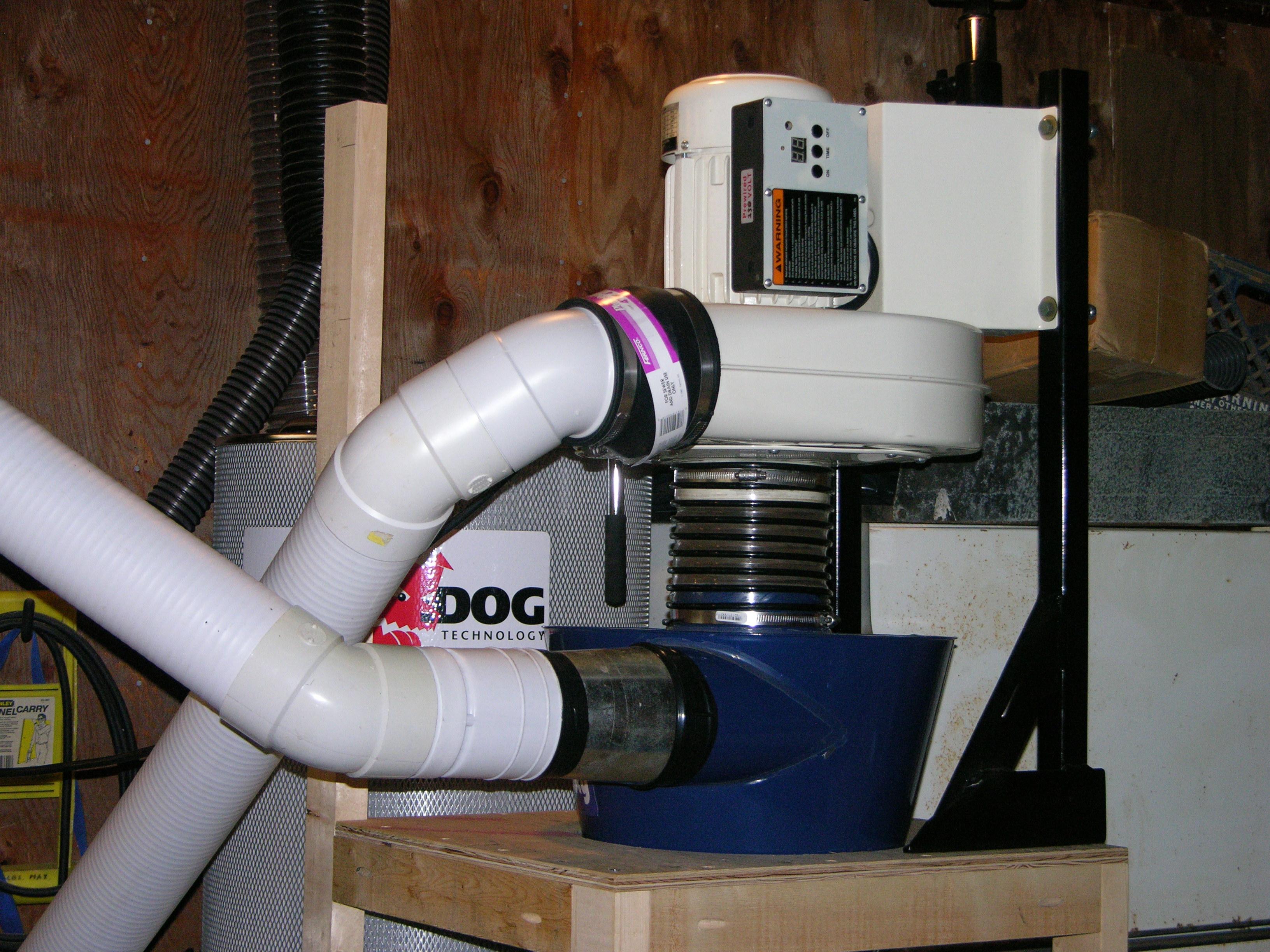

Another cyclone convert here, I have 2 of the plastic ones in service and a small steel one in (delayed) process for "grind shack" duty, plus I modded my Jet dust collector with their larger "super dust deputy" - I haven't changed a filter (or even LOOKED into either shop vac) in a few YEARS. I figure I'll KNOW when that's necessary when I DON'T have suction...
I did, however, learn one important caveat on the FIRST cyclone/shop vac - do NOT try to suck up styrofoam packing peanuts or you WILL be opening the vacuum itself :confused: - anything that has more surface area than mass is NOT your friend here...

Anyway, here's a few pics of the cyclones I'm using ATM; sorry for the "semi-hi-jack"... Steve
