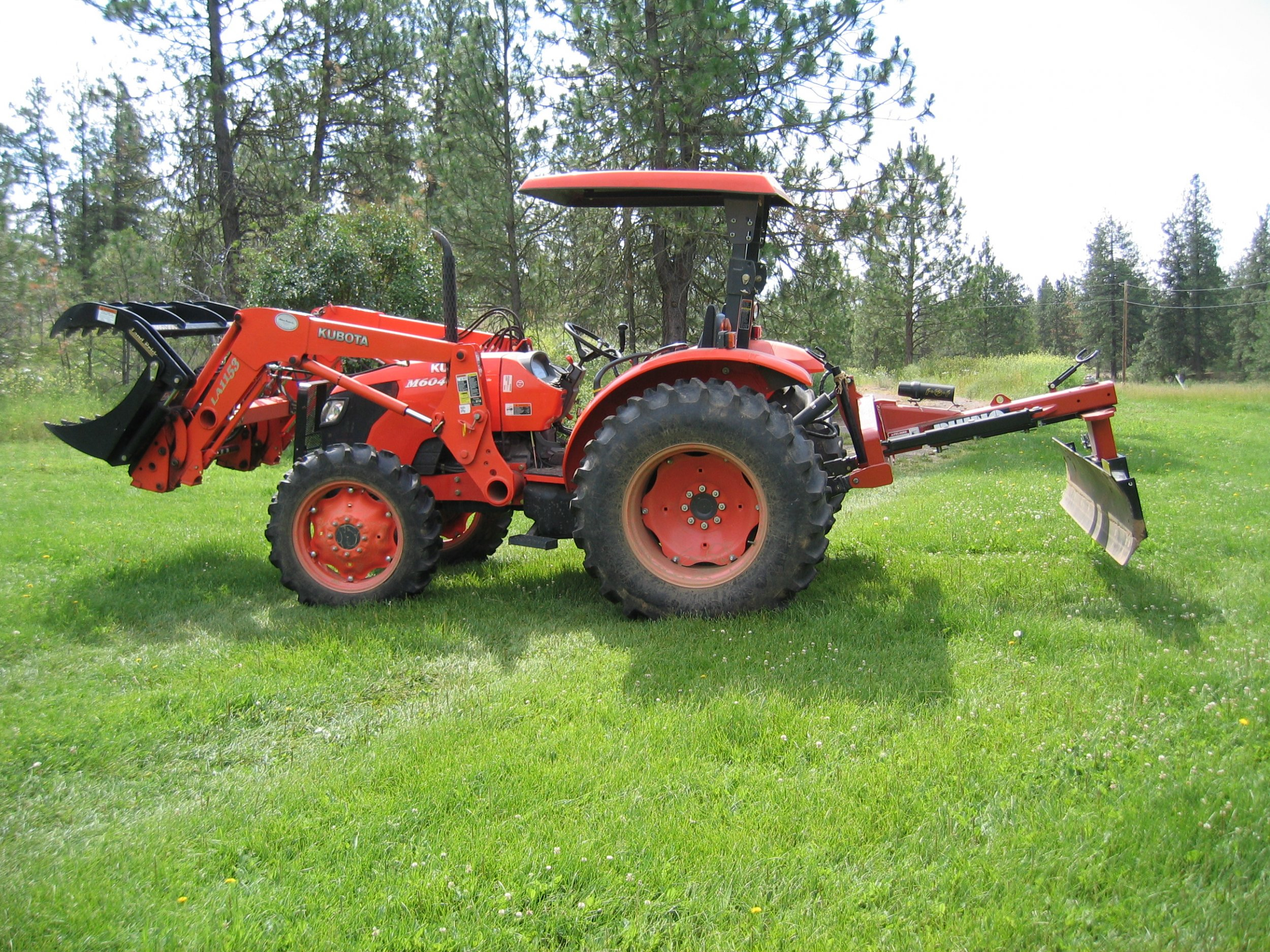

With my heavy duty grapple, RimGuard loaded rear tires & really heavy Rhino rear blade - my M6040 weighs 10,100 pounds. I can STILL get "light in the loafers" if lifting a really big rock or chunk of pine tree trunk.
My Op Manual warns to NEVER attempt to lift with the FEL without adequate ballast on the 3-point.
You might have been very lucky - get your tractor set up correctly.
BTW - my Rhino rear blade weighs - 1050# and sticks way out back.
