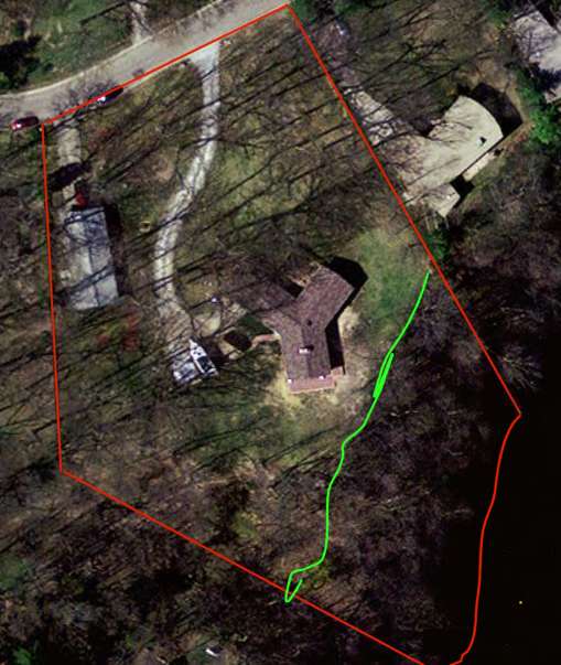

Yeah. My dad owned a piece of property that was a little over an acre if surveyed looking straight down from the sky. The city tried to tell him it was over two acres if they measured the surface areas. There was an escarpment that was on a slope. From the top of the "hill" if you walked straight forward 40 feet to the property line you would have about 90 feet air under your feet! :eek:
In the attached photo you can see that from the air, the area below the green line doesn't look too large. But when you get on it, it is well over an acre of surface area and almost the same size as the "flat" land above it!
Yes, on that steep slope the aerial view would be incredibly different from that on the ground...
