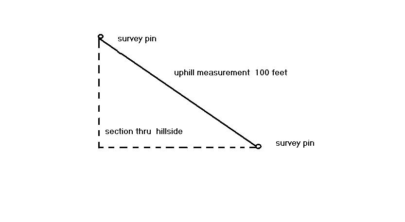

Question, When survey and plat/deed shows 100 feet and the line is up a slope, how is that land measured when the bulldozers finish leveling the area?
Without having the original elevation shown I can't understand how the new plat is calculated.
See attachment.

I can't answer the question as to how a surveyor would make the measurements, but you only have 100' in depth, and it doesn't matter if it is a hill or not. If you remove the hill, the measurements of the underlying surface are still going to be the same. Survey measurements are adjusted for hight and the map shows the ground as if there were no change of elevation. I can understand how they can do it with modern equipment, but how it was done with the old manual tools, is the question.

<font color="blue"> I can understand how they can do it with modern equipment, but how it was done with the old manual tools, is the question. </font>
3-4-5 right triangle process is one way.
Measure the distance between 2 points along the slope, determine the elevation change (using the same telescoping measurment pole used to do a topographic survey) between the same 2 points. You now have the length of two sides of a right triangle so you can solve for the horizontal distance.
In the case of very steep slopes, it required several set ups with the transit to complete this process.

Good old time surveying and accuracy. Equals a Wild T1 and interpolating six place log tables with recipies that distribute discrepencies over all the obsevation points.
Egon
   / Surveyors #40
It's all about angles measured by theodalite, distances measured horizontally and calculations. Course I'm talking 40 year ago.
