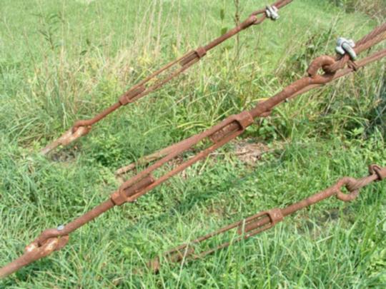

   / Suspension bridge
#32
This shows the anchors at the south end with the turnbuckles connecting the cables to the anchors. A quarter is lying on the end of a turnbuckle for scale.

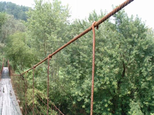

   / Suspension bridge
#33
This a view from the creek looking east. this gives you and idea of the height of the walkway above the water.

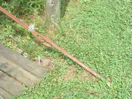

   / Suspension bridge
#34
These are the anchors on the north end. The walkway is level with a path around the hillside on this end. There are no turnbuckles on this side.

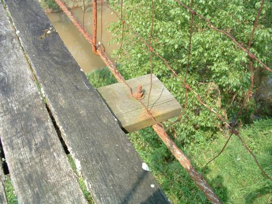

   / Suspension bridge
#36
This shows one of the support boards that is attached to the lower main cables with "J" bolts. You can see the nut on the exposed threaded end of one of the bolts in the center of the picture. There are about fifty of these boards on which the walkway is fastened.

   / Suspension bridge #37
Interesting bridge. Who built it and when was it built? I am not sure that I would want to cross it, it seems like a long way down if a board was to fail. I wonder what those turnbuckles are anchored into?
