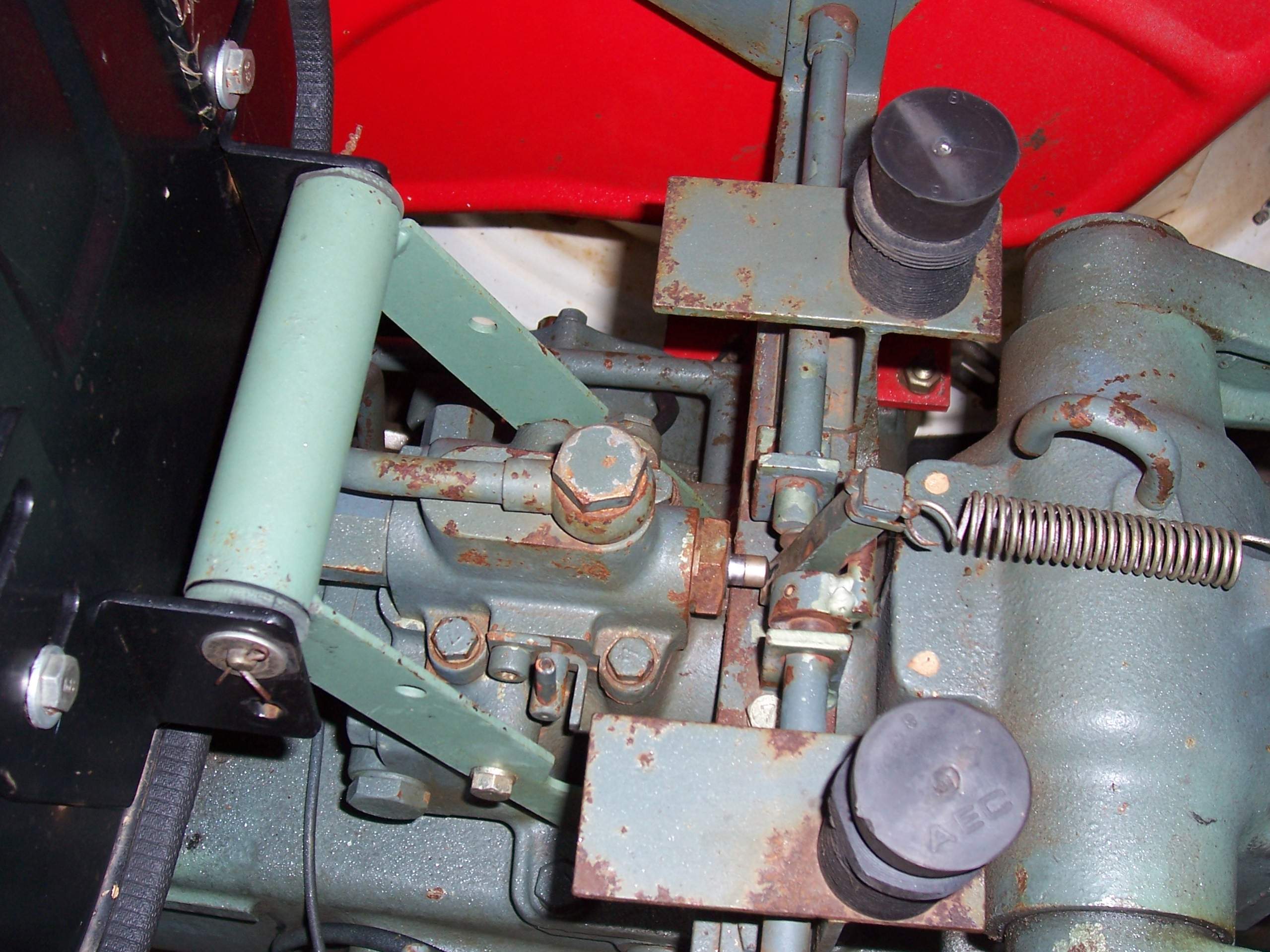

5 bucks at Home Depot. My seat was a little to laid back and stiff. Easy fix 1 1/2" Freeze plugs from home depot. Just put the screws in upside down and screwd the plugs on. Cheap,Easy and Absorbs Alot of Shock. No kidding it works great. :thumbsup:
