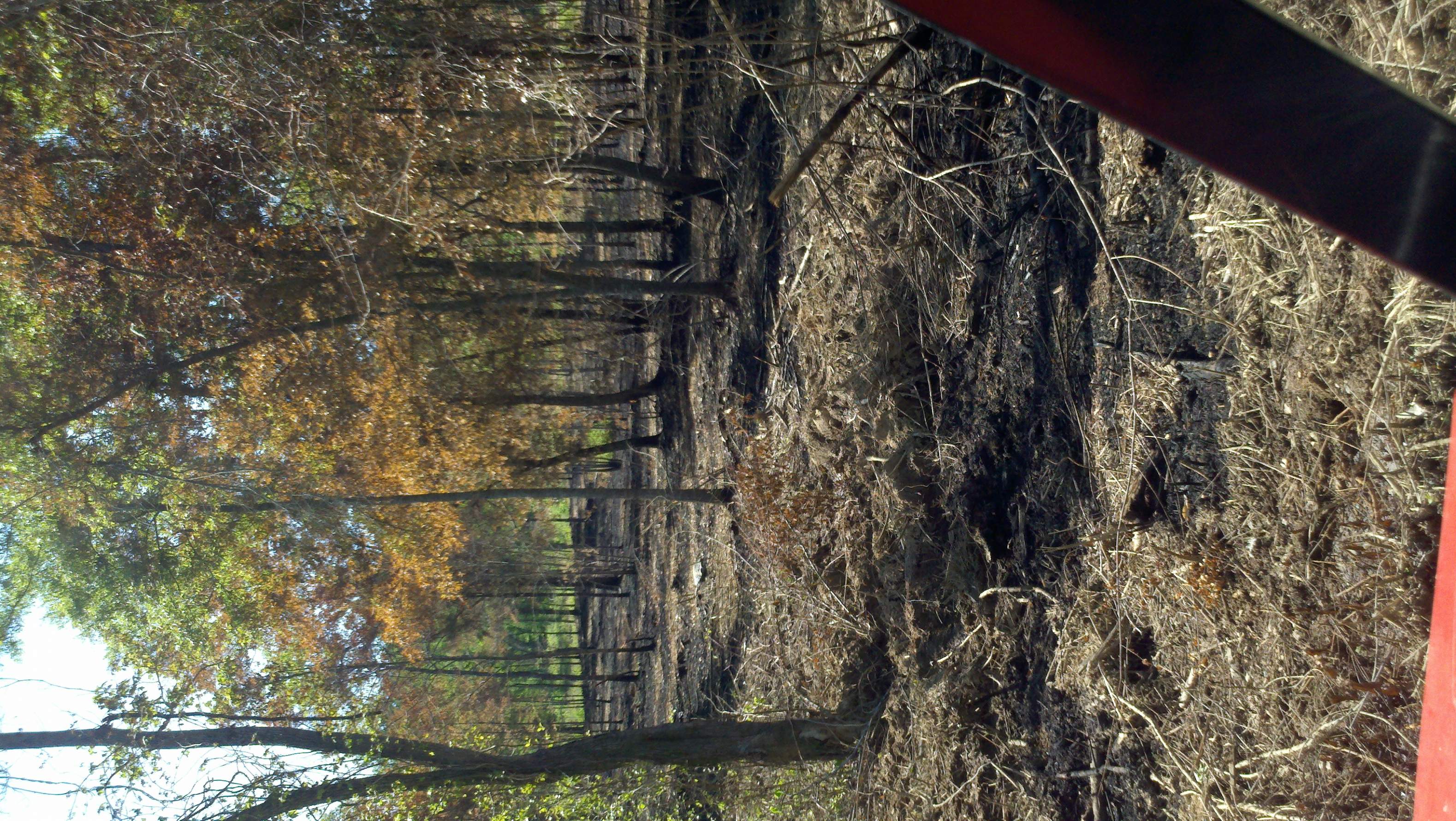

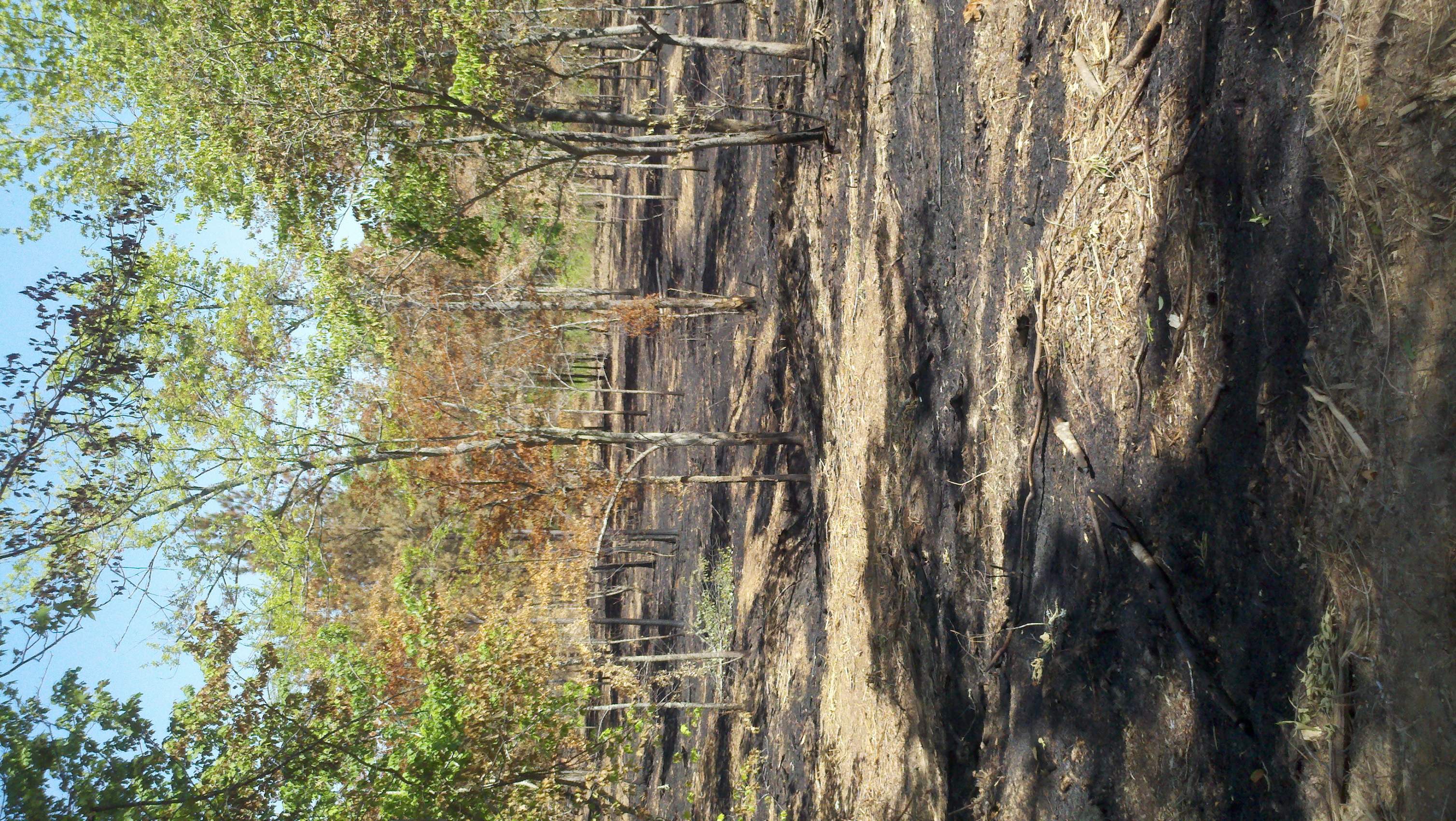

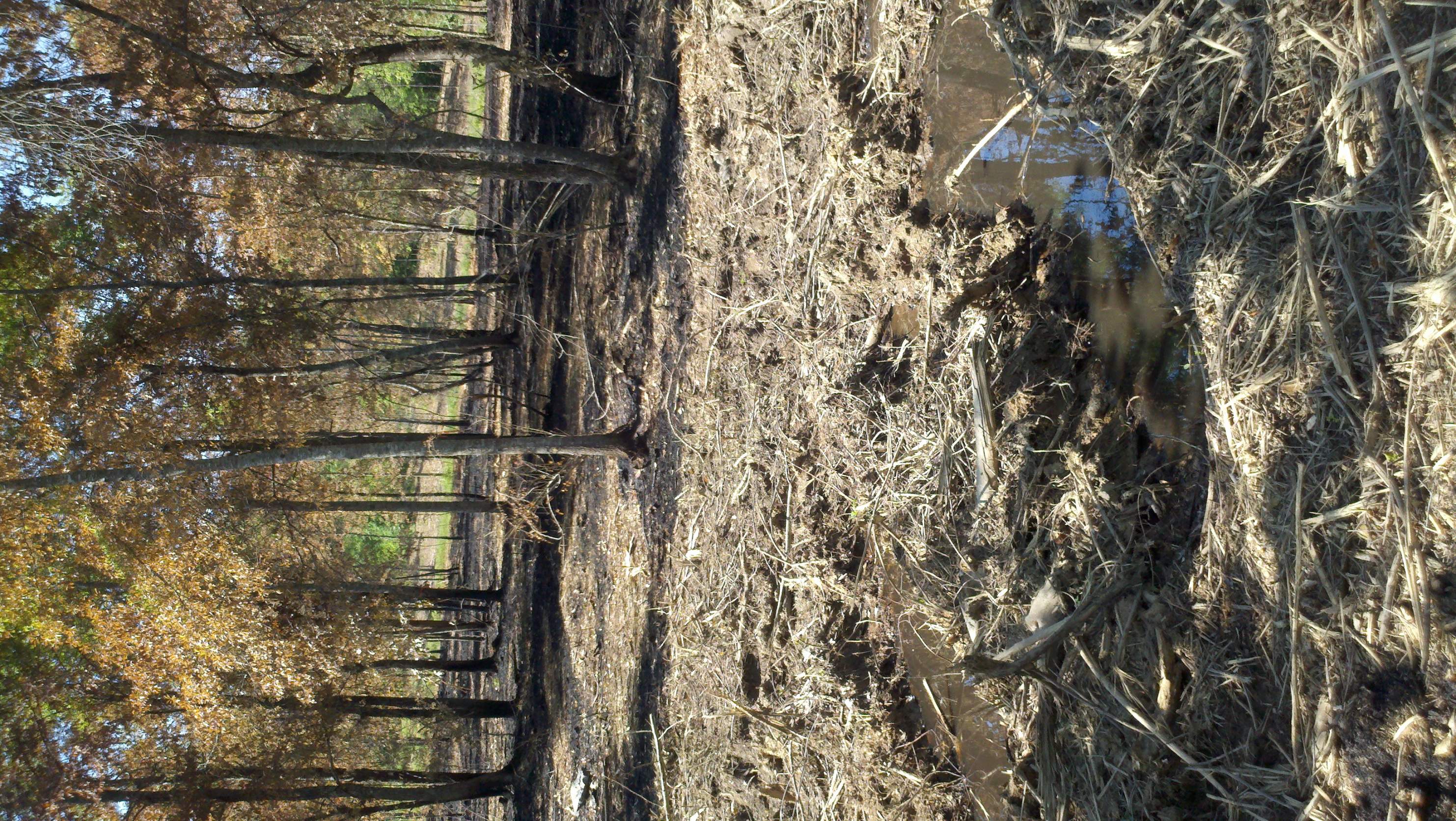

#16
Here are some pictures from the area I am speaking of.
