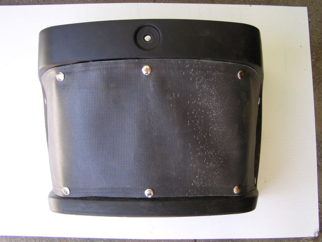

At the bottom of the grill there are 2 plastics just under the battery that you have to remove, so the air will come from there and not from the cab trough the grill.
