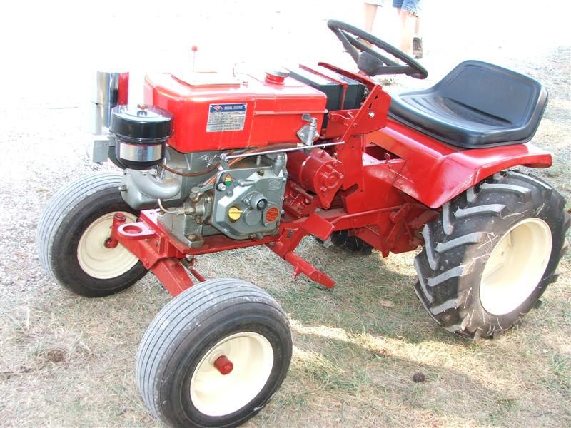

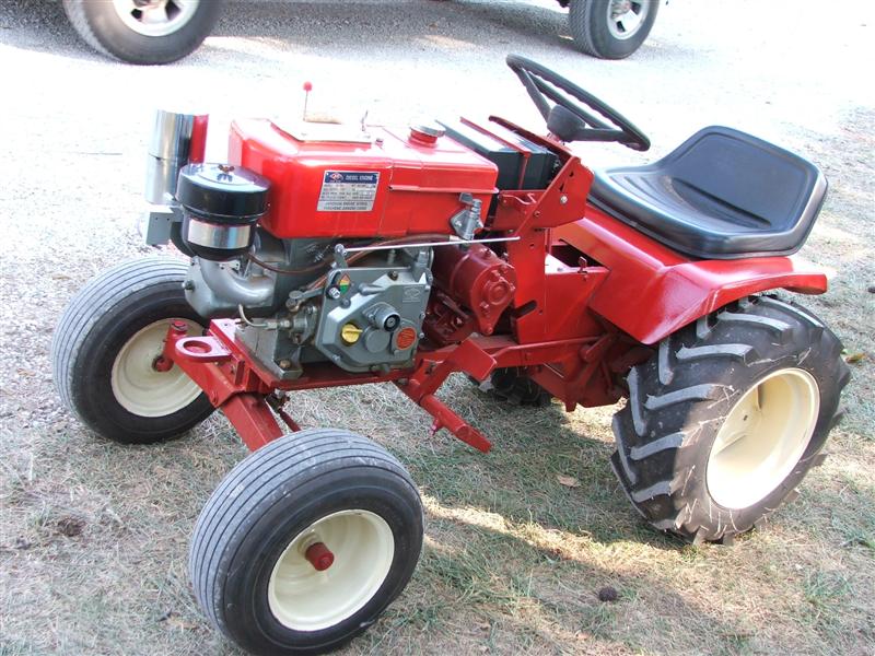

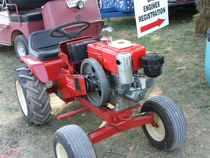

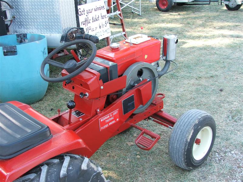

billbill1 said:
If it's worth it to you, then go for it. I think you'll be plesantly surprised and have more power than ever. Plus you have a project to work on. I have thought of doing the same on my Wheel Horse but I have a horizontal engine that uses two shafts. I like diesel engines better. Is the engine you bought water cooled? I look forward to following your progress, please keep us informed.
I saw this at an antique tractor show last year, neat install and the guy was driving it around and said it had tons of torque, he ordered the engine from Canada, Chinese diesel engine shipped in as generator parts. Here's a few pics.
