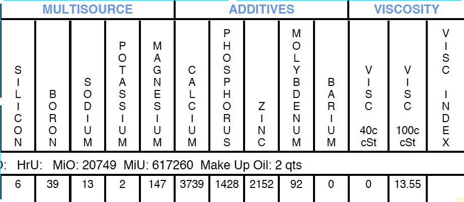

Here is a snap of the the additive package on a Schaeffer 5w40 synthetic I have been trying for a while in my Series 60 Detroit. One stout add pack in it.
   / Switch back to dino oil from synthetic?
#12
I recognize the high phosphorus number but need help with understanding the other numbers. I'm a newbie but it looks pretty good.
   / Switch back to dino oil from synthetic? #13
Calcium is basically Tums for your motor and part of what controls acids. It is all part of the detergency of a oil to keep things clean. Magnesium and sodium compliment that. This oil has a boat load of calcium, one of the highest levels I have seen in an oil.
Zinc, in conjunction with the phosphorus is a extreme pressure modifier. A very good load of both in this oil. Zinc and phosphorus combined are the ZDDP you read about in oils.
Moly and boron are friction modifiers. Molybdenum has a platelet style structure. Kinda like spreading a bunch of new playing cards across a surface and sliding a box on them. Moly does not build up, the plates spread along. Boron is actually boric acid, that is very inexpensive to make but is a great friction modifier as well. Titanium, in some oils like Kendall, performs a similar service as moly.

Copperhead---Many thanks for your very informative reply.
So when the new labelled CK-4 oils start showing up, they are OK to use in 20 year old Kubota diesels?
Second, if I found a dino oil labelled as CJ-4 and I would switch to that over the synthetic I have been using, would you expect any material operational difference since I use equipment in warm weather and have short oil change intervals? I use synthetic partly because I feel I get better start-up protection, especially if the equipment has been sitting for a month or so. Does synthetic protect this way? Do you use dino or synthetic ?
