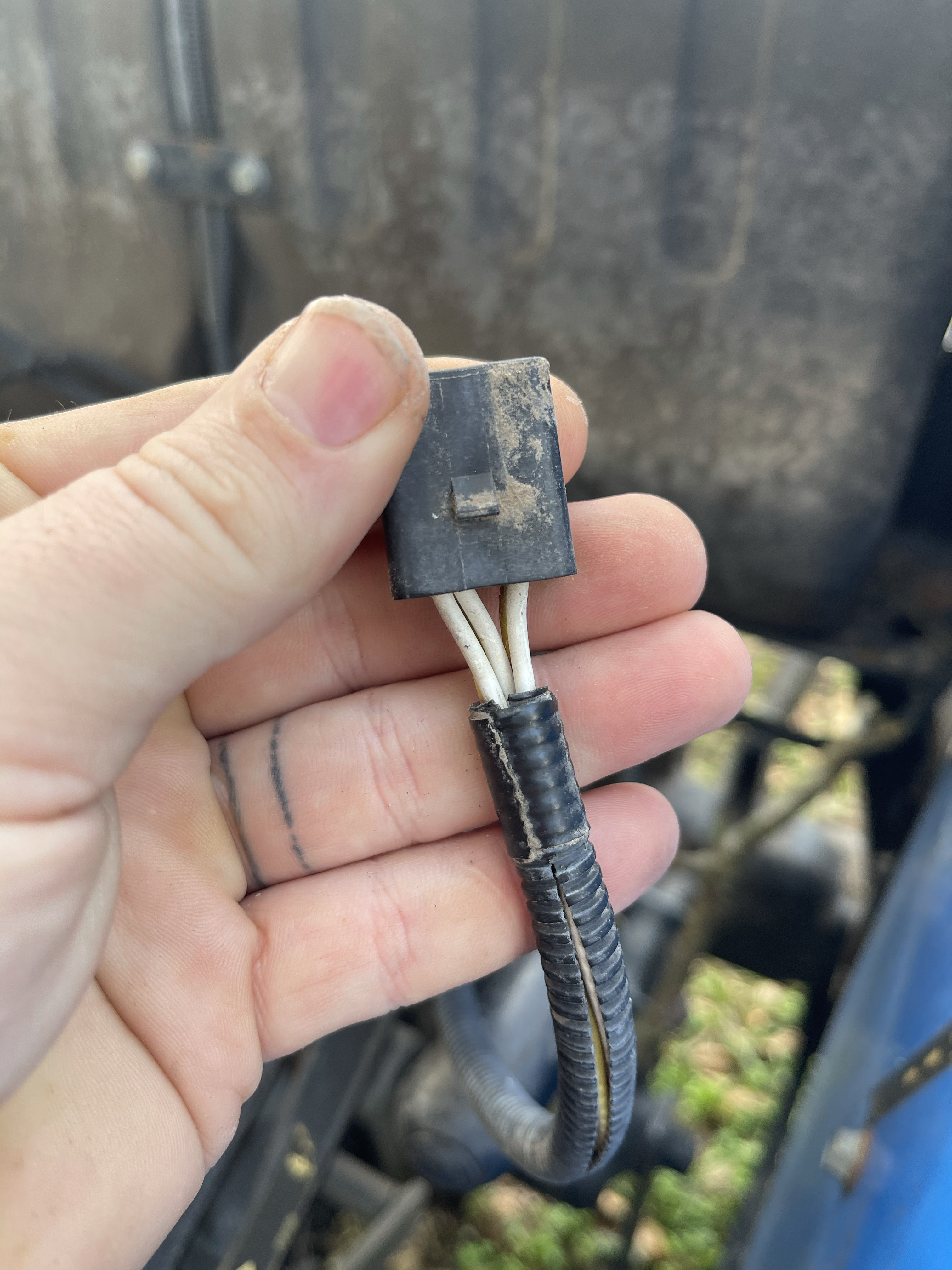

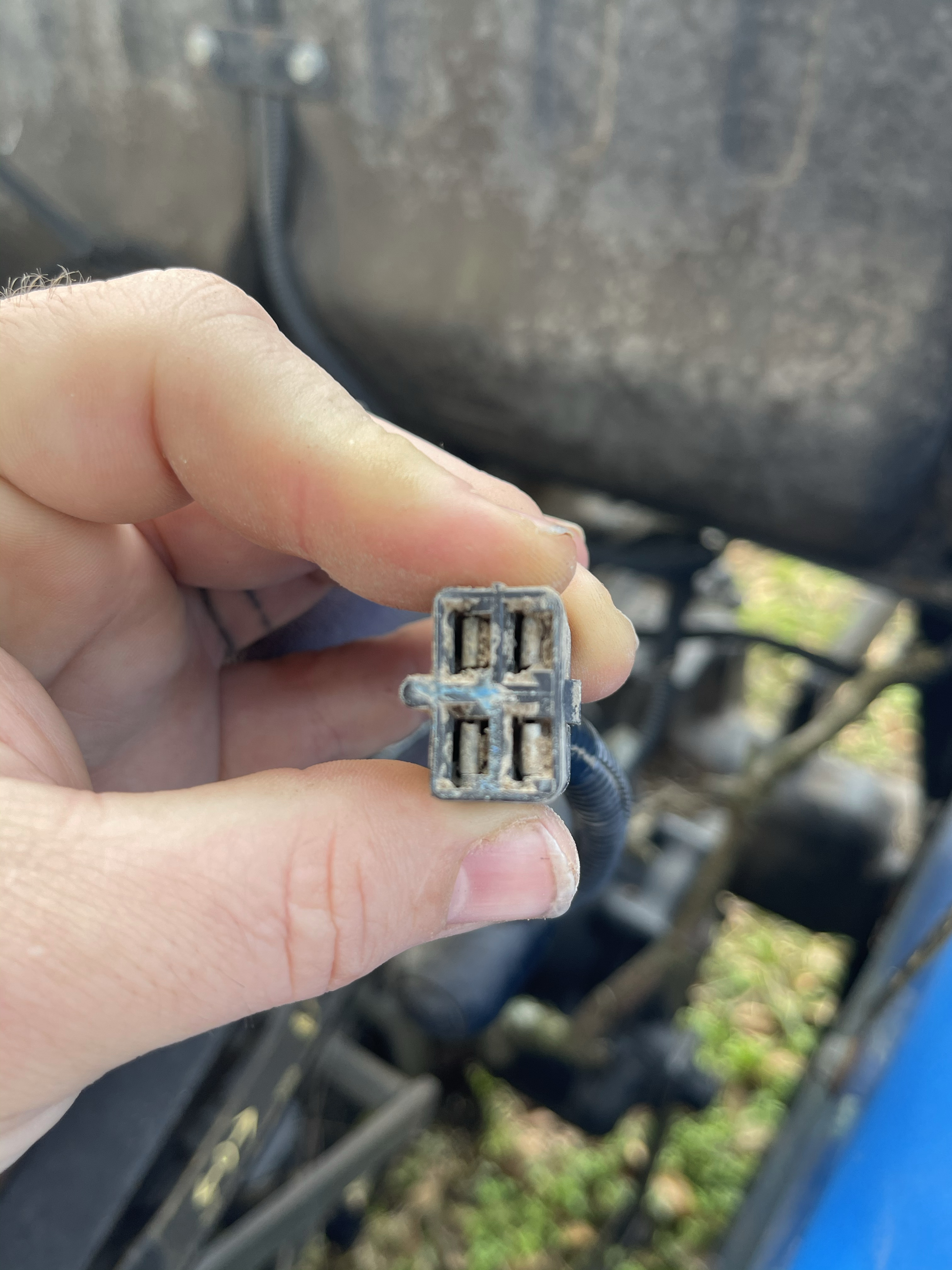

Doing some trouble shooting , need a hand with a switch . How should I jump this switch ? IMG_8369.JPGIMG_8368.JPGIMG_8373.JPG

You need to find the wires that go to the normally open contacts in the switch.

It’s the seat switch . Trying to trouble shoot my intermittent starting/ not starting issue

If that's the pigtail that goes to the switch and you are asking how you would jump it out after you determine it is your problem....if you can't find a mating connector like that to make a jumper harness you can get some crimp on disconnect lugs and jump the terminals out that would normally be the switch legs.

I want to jump it out to see if it’s my problem. If it is I will replace the switch.
