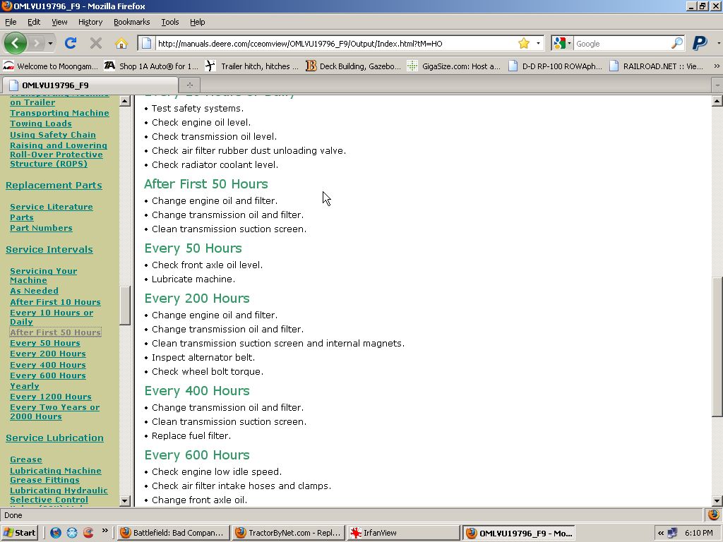

Greg - if you can find it please tell me exactly where you found this in your manual? Maybe I missed it in my 4120 manual. The motors in our tractors are vastly different, though, so there may be a difference in break-in.

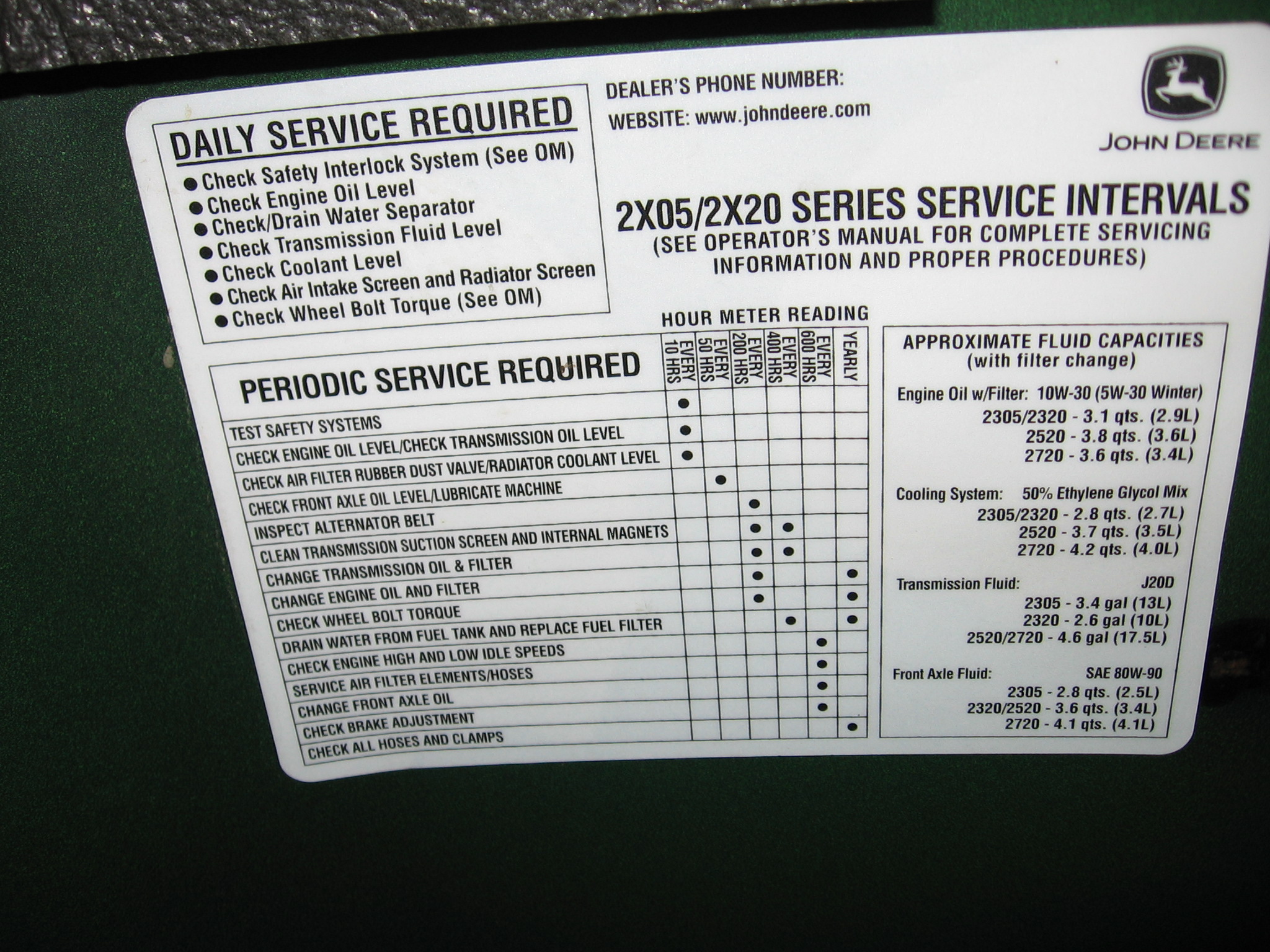

Sorry I didn't post earlier,I was working. I figured I'd post anyway.
Funny thing these manuals. Hood sticker and manual don't jive!
Don't know what to do:confused2:
Maybe I'll just drop back and punt:)
Greg

   / Syntheic oil at 50hr service? Old topic, but want fresh ideas #32
Greg
Greg, printed manuals are printed in bulk, at a great price. When they get superceded, the OEMs continue to ship them out with outdated info. Sometimes they place an update sticker, as they did on your tractor, or they just allow the confusion to reign. Short and sweet? Go with the sticker, as it is new information, no doubt. Stickers are cheap and if they need updating, it isn't as expensive for the OEMs.

Well, actually they might. Depends on how you look at it.
Your hood sticker doesnt have a "First 50 Hours" column....it has a "Every 50 Hours"...2 totally different things...
Very true - frustrating! :mad:
The best info I have been able to gather so far it so use break-in oil for the first 100 hrs, then run anything you want. Not sure if I will swap out now - at 50 hrs - for fresh break-in oil or just go the full 100. :confused2:
Too bad Deere can't get theor act together and print a manual that is accurate and clearly states the requirements. This is ridiculous, really.

Just to muddy things up some more, this is a copy of part of JD3520 owner manual. There is no mention of oil change until 200 hrs.
After First 10 Hours
Check wheel bolt torque.
Check cab rollover protection system mounting hardware torque.
Check windshield wiper arm mounting hardware torque.
Every 10 Hours or Daily
Test safety systems.
Check engine oil level.
Check transmission oil level.
Check air filter rubber dust unloading valve.
Check radiator coolant level.
Every 50 Hours
Check front axle oil level.
Lubricate machine.
Check cab protection system mounting hardware torque.
Clean or replace cab air filters.
Every 200 Hours
Change engine oil and filter.
Inspect alternator belt.
Check air restriction indicator light.
Yep - my 4120 manual says the same thing. Back in this thread I posted a link and some others posted a couple more that are a little more informative. Check 'em out if you haven't already.
