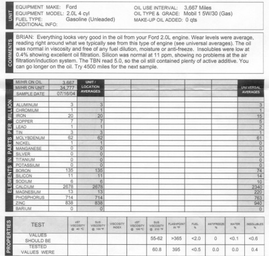

I have used synthetic since the early 90's. I always changed @ 3k.
I recently started sending oil to Blackstone and now am beginning to extend drain times.
You seem to have much more experience than I do, with oil sampling. Attached is a copy of one of my test results. Why is the TBN soo low. Using Mobil 1 5w40.
Bird brought up an interesting point in his last post. Having been a Mechanic most of my life. I always remember many old timers when I was younger telling me that the oil and filter you use doesn't mater as much as how often you change it. I still think their is a lot of truth to this if using Dino.

Without seeing oxidation and nitration I would GUESS your TBN is going down to it fighting some elements.
Also TBN drops then goes back up slightly over time/miles. Nevermind I do not know what it starts with. Also your engine has many miles so that is also adding some elements.

Here is another test, different car.
Less miles on oil
less miles on engine
oil in car much longer (8 months +or-)
mostly short trip driving (wife works 3 miles from home and comes home for lunch every day) bad for oil. This is one reason Why I use synthetic, and oil pan heater during the winter.
The other test I posted, That car gets 100 mi per day 4 days per week.
TBN is similar.
Does any one know the TBN on Mobil 1 so I don't have to pay $30 to find out.

But here is my last test with Amosil 5w-30.
My TBN is 3.33 with over 12K miles. I wonder if M1 package does not hold up well and thus there TBN drops like a rock! weird.
http://home.comcast.net/%7E94gsxr1100/lexus/oil/oil_test.pdf
Oh, the short trips might mess with the old viscosity and sheer stress but not anothing else. If it did you would see fuel and water in oil...but then again it looks like Blackstone does not test below 2.0%
Lastly, look at the ph and the Zn..Very low.
