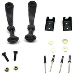

So far the only problem is the hood latch not catching securely and allowing hood to pop up. Purchased a couple rubber hood latches (Rubber Ball in socket type) to mount to the hood and chassis. I've already tried sliding the catch as close to the pin as possible. I read a post about drilling the receiving hole a size bigger to allow latch pin to slide deeper in to catch, will try that while home next time. Mean while hood is held down by a length of 550 Paracord tied across it until I can fix it.:confused3:

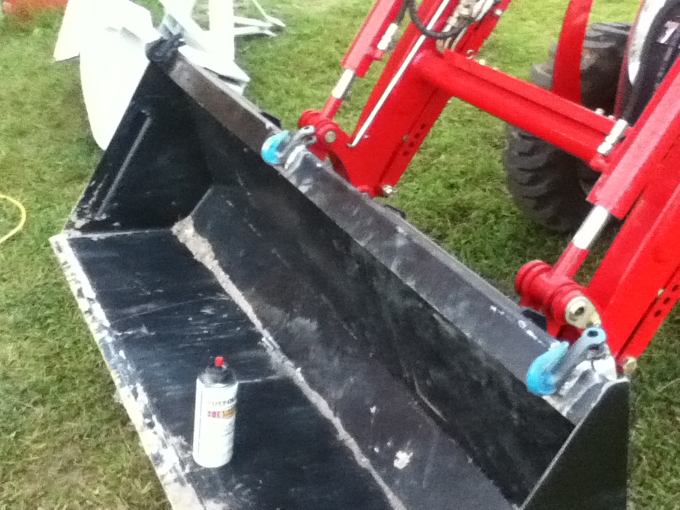

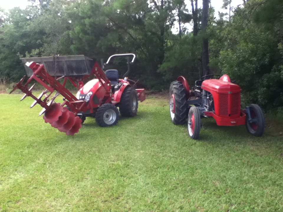

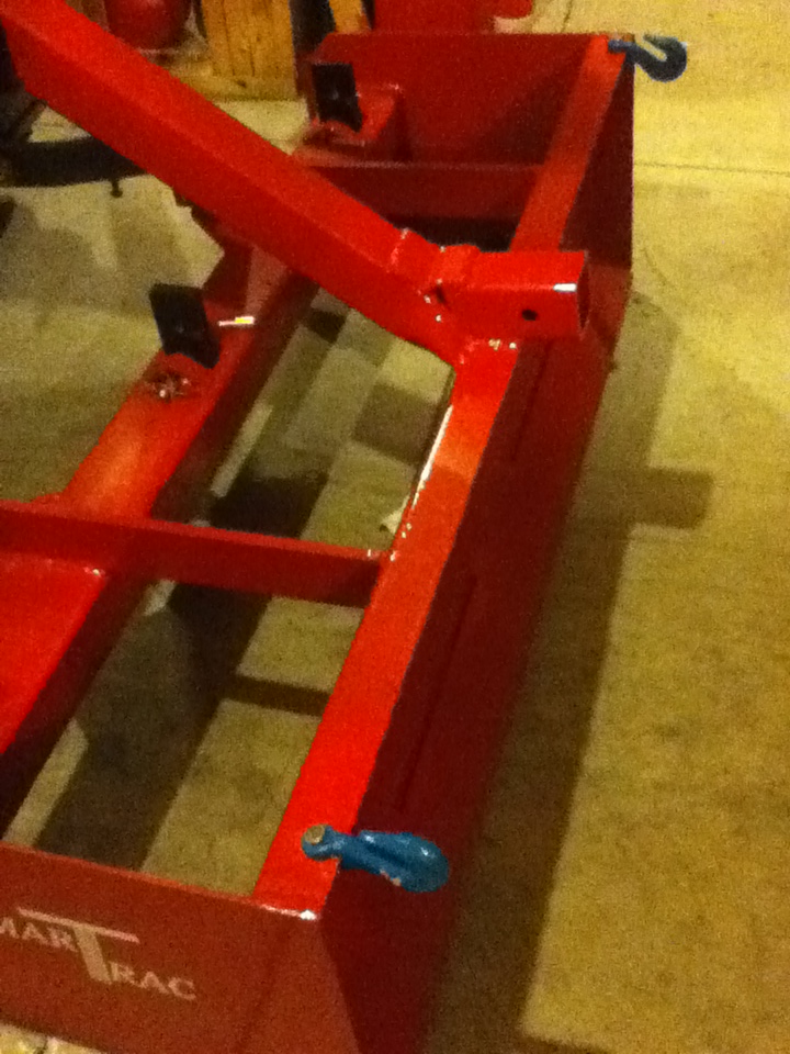

Here are some pics of my tractors and a few mods made to the FEL bucket and boxblade to improve their usability.

I just purchased rubber hood latches to put on each side of the hood to lock it down. I'll have to wait until I get home to figure out how to mount the latches.
I'll try drilling out the hole in the pin recieving bracket on the hood first and see if that will allow the lock pin to slide completely into the latch.

/ T-233 Owner #18
Look in local stores for the rubber latches with no luck, found a pair of rubber latches for marine applications similar to yours in the internet and bought them,I installed them this afternoon they look (much better than the bungee cords)and work great.
That's good to know, thanks! Got a few more weeks until my R&R, I'll fix mine when I get home.
