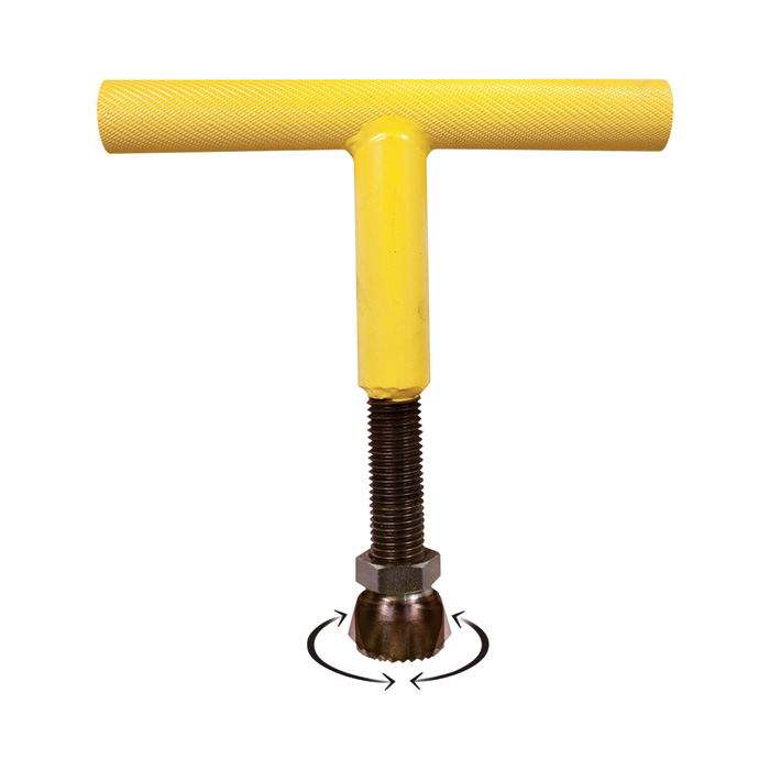

on these debris forks by Northern tool, they have the T-handle clamp. See LINK: Load-Quip Steel Debris Forks — 1400-Lb. Capacity, Model# 29211774 | Bucket Accessories| Northern Tool + Equipment
Does anyone know if there's something commercially available that includes the swivel pad at the bottom?
Can fabricate it I suppose but was curious if there's a source.

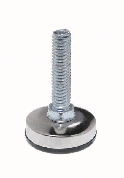

McMaster Carr has "replacement swivel pads" for C-clamps but they require a ball end. They also have "mounting feet" that are threaded female for threaded rod, but generally the bottom of those is smooth and "non-serrated" like the one used on those debris forks.

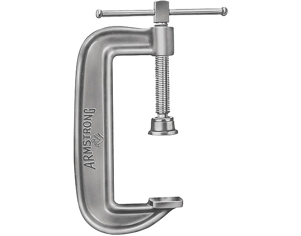

Go to a Pawn Shop, buy two big C clamps, cut the sliding pin and make it look like Northern's

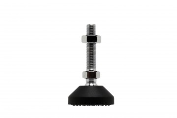

Or get an adjustable foot.

Your C-Clamp idea isn't half bad.
I kinda wanted to use an ACME thread anyway because that's what it's for, and good heavy duty clamps use acme.
I've spec'd mounting feet many times, the female-threaded type would work well, but most of the time they are smooth and for the size screw I'll use, they'll be quite big around. Not that it's a problem per se. But when you figure the surface area of the foot, the bigger the foot the more the clamping force is spread out. This might have an effect of reducing the friction which causes it to stay put.

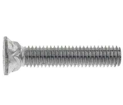

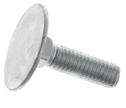

For a flat head to clamp with, you could use a plow bolt
or an elevator bolt
if you can get them in a useful size.
Or just weld a pad on the end of a regular bolt, after you run it through the nut.
