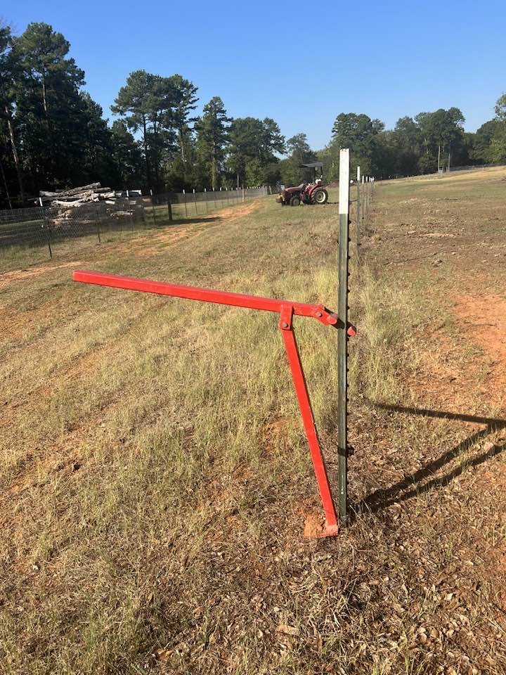

I used to use a fabricated device. Mostly it's a chain wrapped around the post, and a stand the right height to pry the chain and the post out. It always worked.
A couple of years ago, I decided to buy an actual "T post puller". It's faster, and easy to use.
Search Amazon, or E-bay for examples. $50-$90

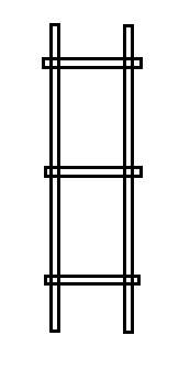

I made one. Works good.
Two flat metal plates or angle . I used 1 1/2 angle I had. Three 3/8 cross bolts for about 1 1/2 inch between plates. and about 2 inches between bolts
Drop either end over the post and pull up or jack up on the 3rd bolt.
Bruce

I have a Speeco t-post puller plate that works good with the loader and chain. Mostly I use it with the high-lift jack though.
https://www.amazon.com/SpeeCo-S16110400-Removed-Handyman-Different/dp/B0042U6DBY
I also use the Speeco puller except I got mine at TSC for $13.99. Coupled it to a short piece of chain to my SSQA receiver hitch plate. I just have to get off the tractor to hook it up to each post if I am by myself. With 2 people pulling posts goes fast.

I paid $50 for a T post puller from Tractor supply to take out a bunch of T posts. I tried using my loader to pull them with a chain, but they always bend, and it takes too long getting on and off f the tractor when doing it by yourself. If you have a helper, and you don't want to use the T posts again, then the tractor would be faster.
I just did them a few at a time after work. It makes a huge difference if the ground has some moisture in it. Dry ground and they don't come out at all. Couple of rains later, and they come out easy!!!!!

My experience is that when the ground is soft, it's a lot faster to walk from T post to T post, and pull them out with the T Post Puller, then it is to drive the tractor to the post, get off the tractor and attach the chain, then pull the post, untie the chain, and then get back on the tractor and drive to the next T post.
So far, I haven't bent a single T post using the manual puller. I think I've bent every one that I pulled with my loader.
   / T post removal #20
If the ground is really soft, I use a wooden plank underneath the puller's foot, so that it doesn't sink into the ground.
