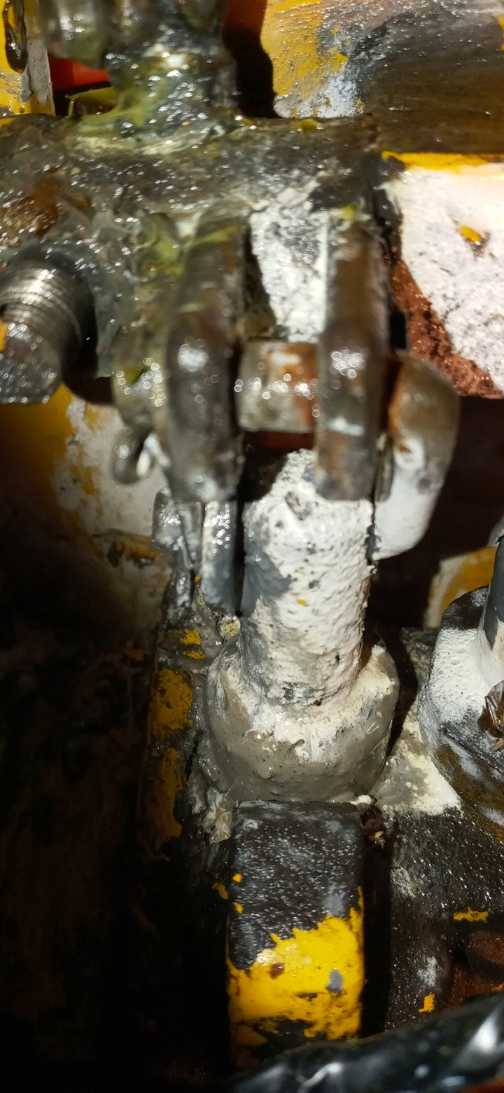

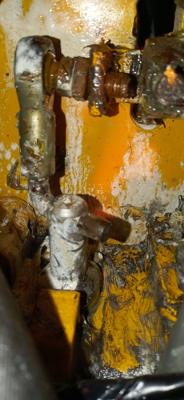

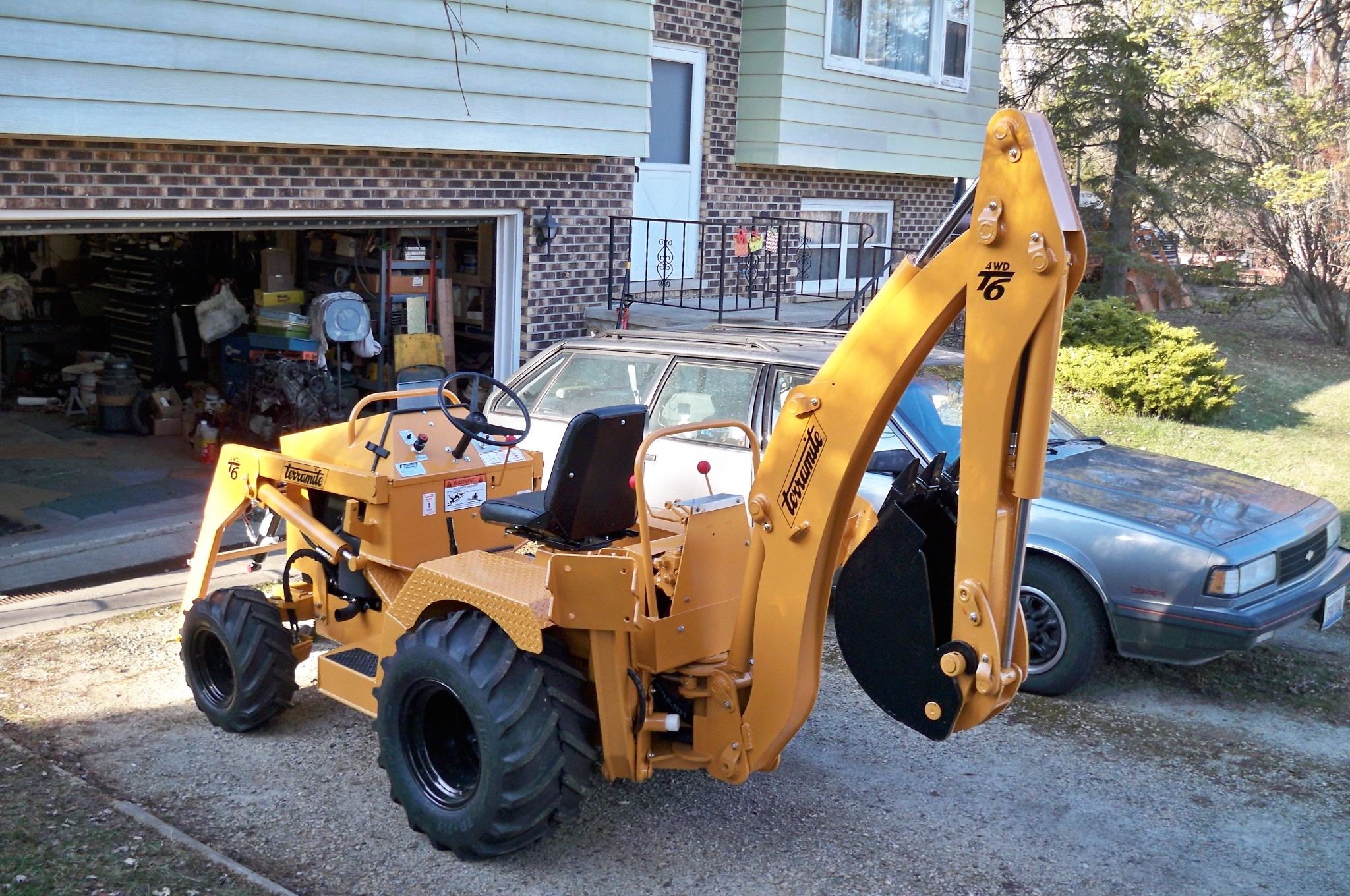

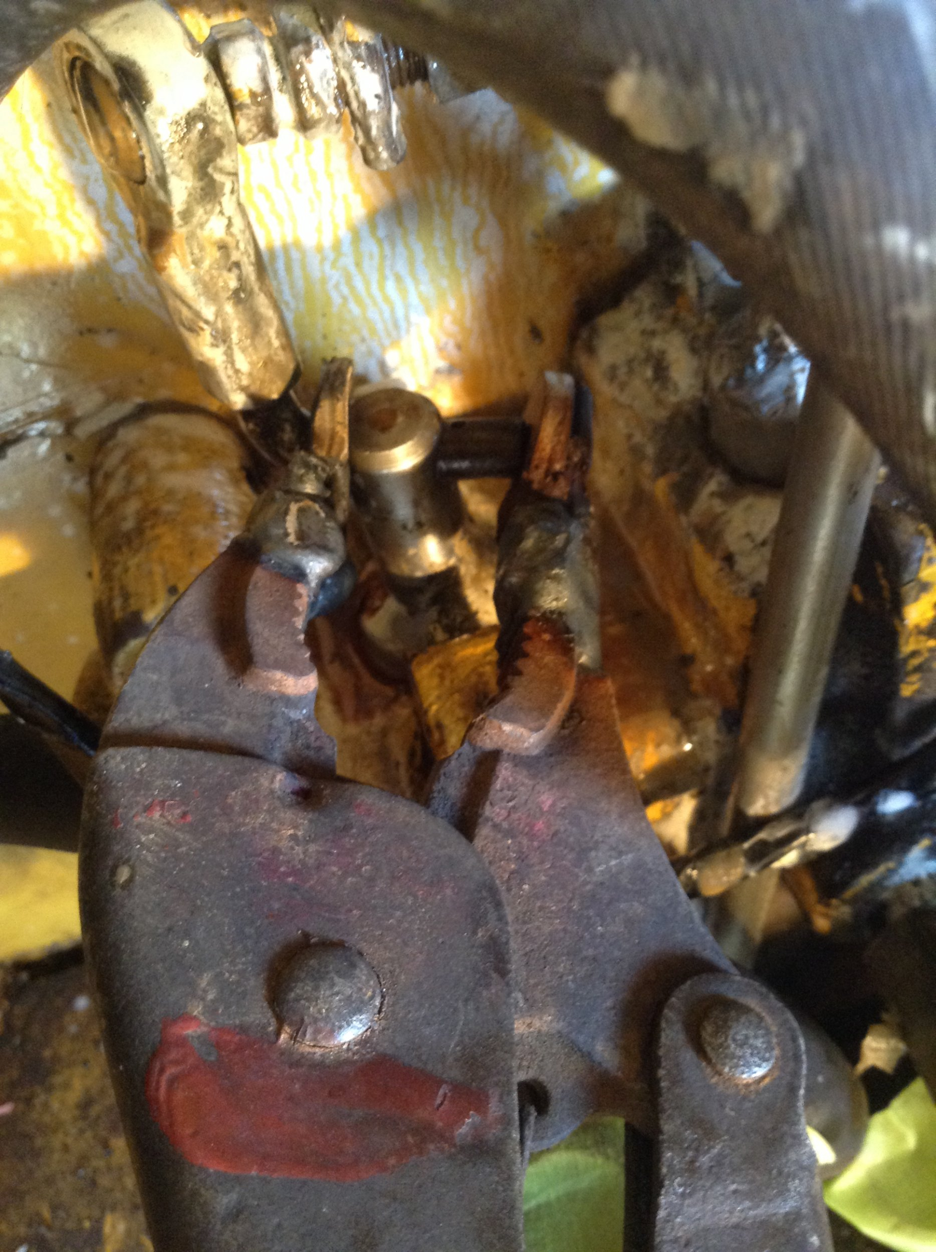

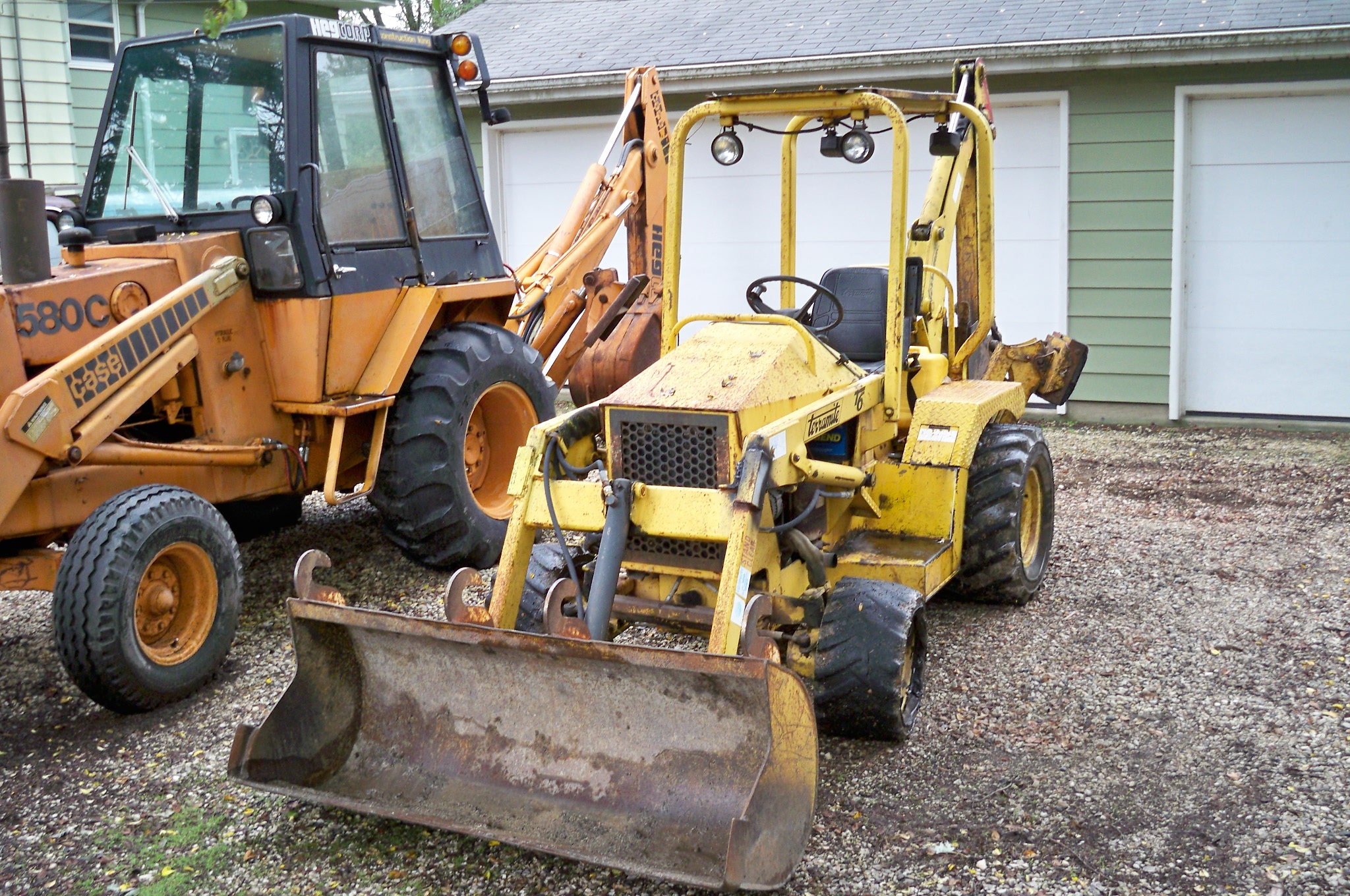

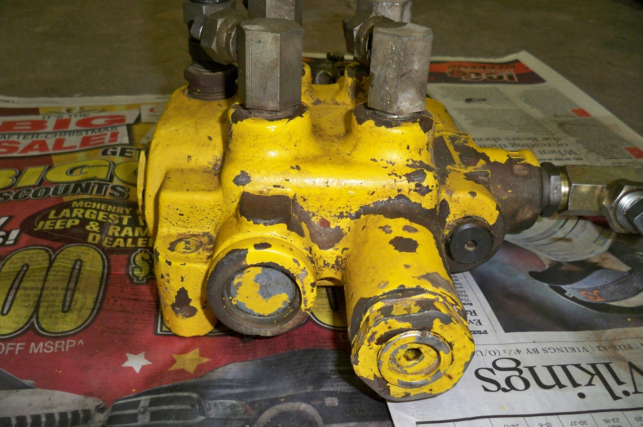

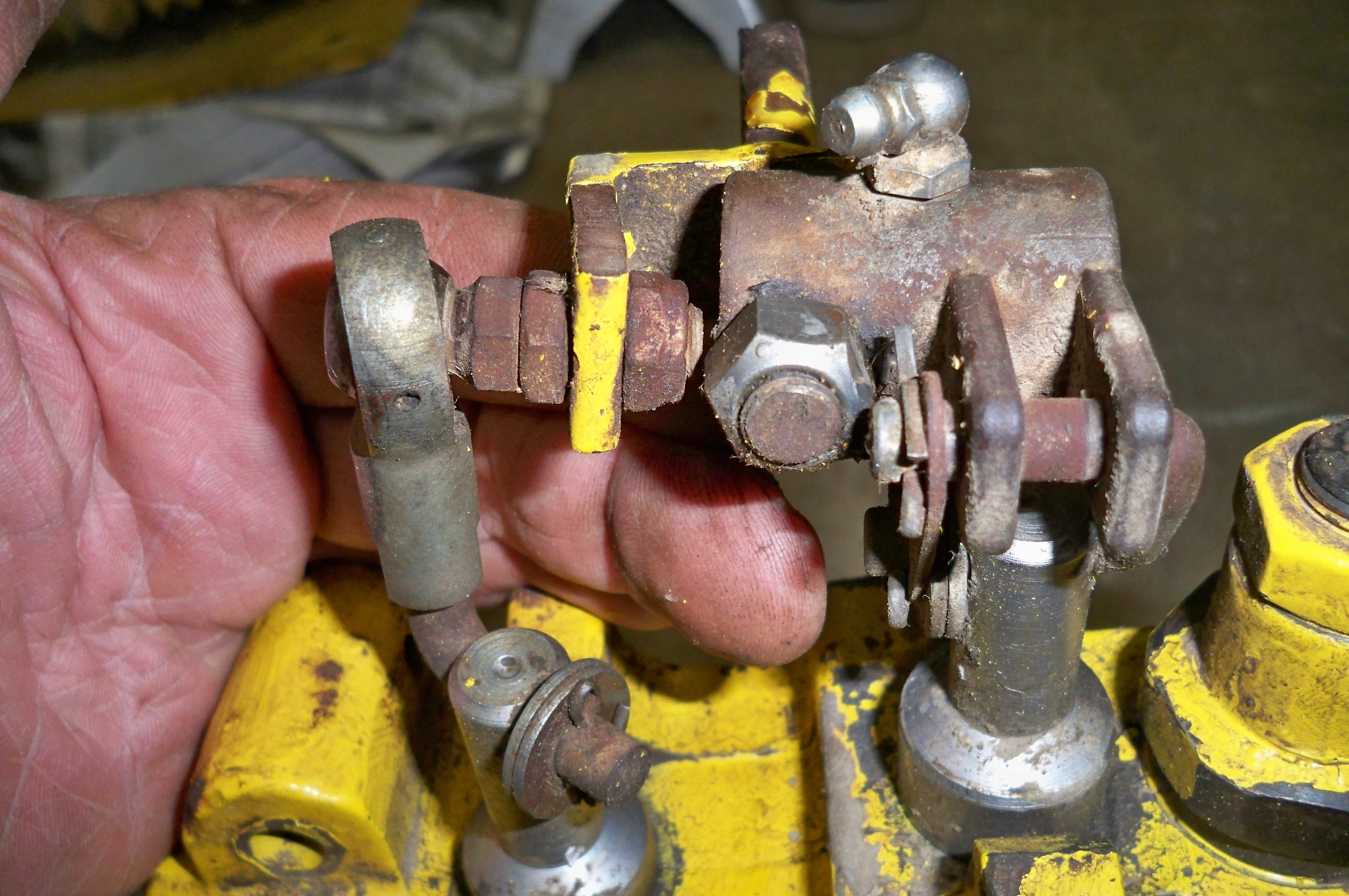

Will your front bucket preform two movements at the same time? I was just moving the gravel back up from the heavy rain we had last night, with new to me T6. Found out when in float the bucket will move to dump but not roll back. More experimenting shows it doesn't seem to want to curl going up or dump when moving down. My old T5 was great at multi tasking. While back dragging the bucket was quickly responsive and allowed rolling back as a pile was being finished out smooth in float. As I approached my dump trailer I could be dumping and lowering at the same time and the reverse as backing away, quick and nimble. The valve on the T6 is buried behind a bunch of hydraulic lines and a handful of electrical wires as well as covered in new grease. So I can't see what is happening enough to figure it out. The main question is this beast designed this way or might it have a linkage issue? I would hate to start moving lines and wires to find out it's meant to be clumsy. A friend had a Yanmar with FEL that by design would only make one movement at a time and I hated it.
