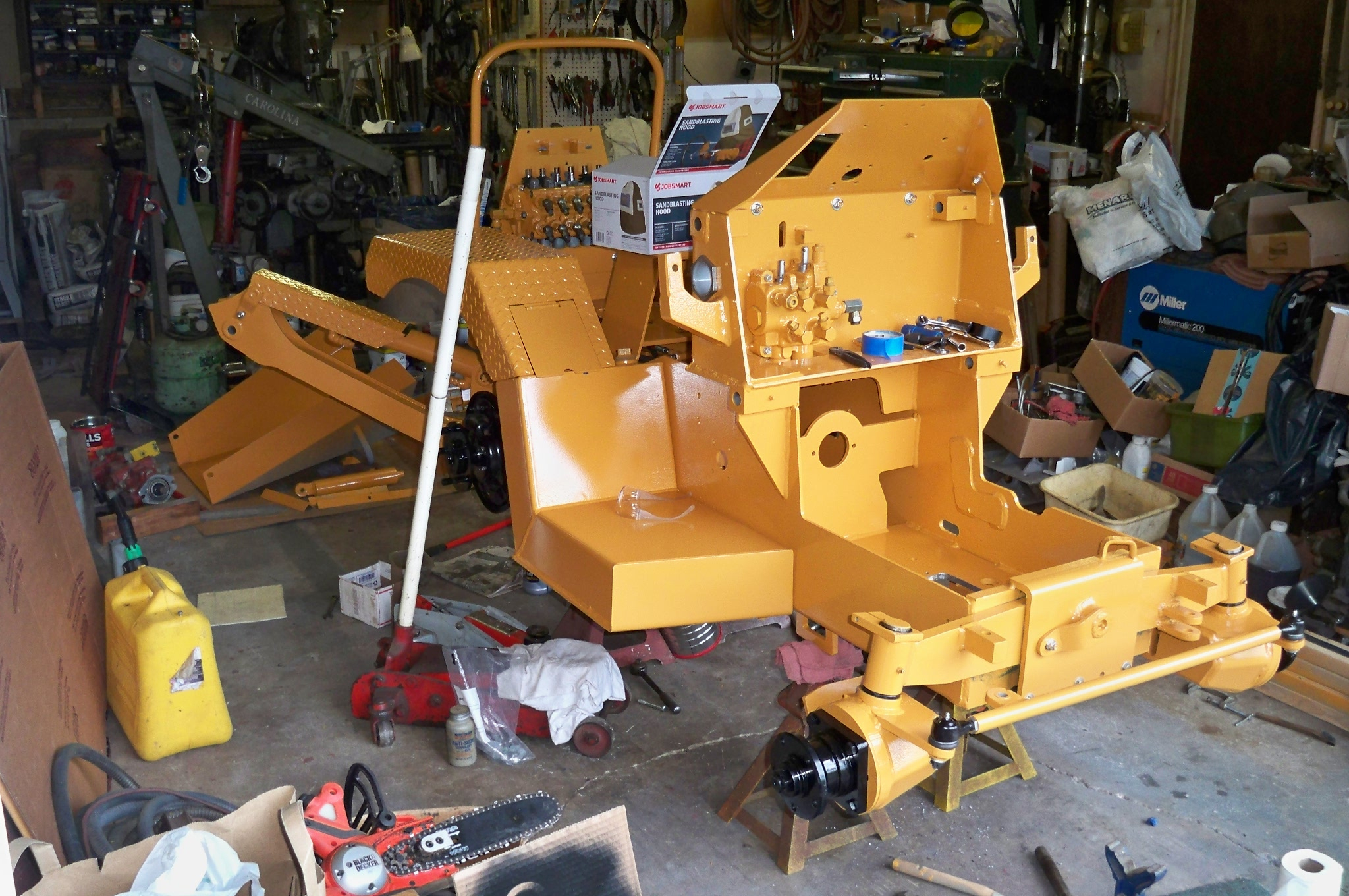

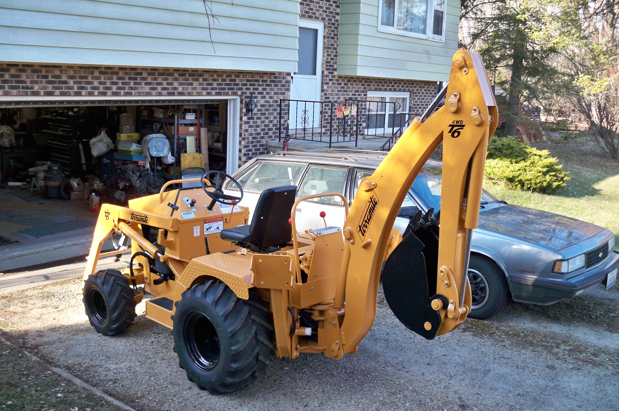

Glad to see you got it and it fixed the problem. Finally got to poke around your website a bit- Nice setup you got there. Always thought I'd like to try forging but I know I don't have the time to take my time and learn it the right way. That's a whole different skill set, knowing when the temps right, what materials work well together, etc. I watch Forged in Fire sometimes and being under the clock like that doesn't seem like a good way for an artist to work.
I did end up with a complete "restoration" of my T6. Still have to finish the ROPS, but everything else is done. Started out just wanting to go through it, clean it up, replace hoses, rebuild cylinders, etc. but the project grew until I had a bare chassis sitting there. I found other sources for parts, it helps that most of the mechanicals are commercial components. Things like that $100 plus timer relay for the glow plugs can be had from Rock auto for about $20 (Standard Motor Parts RY53) and it's the same made in Germany part just repackaged.

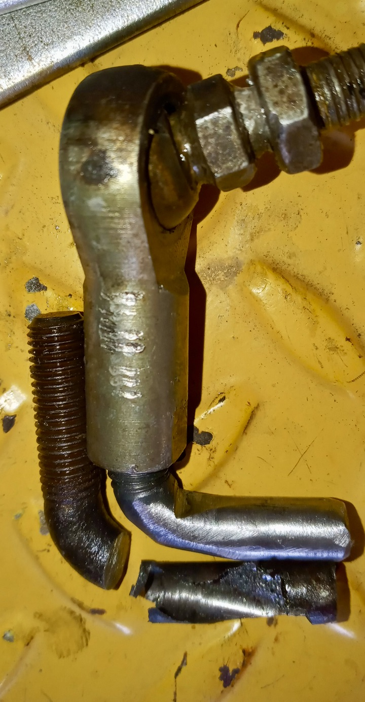

I'll store away that bit of valuable info on the timer, thanks. Any others would be appreciated! My machine is absolutely useable now but the next little project will be fixing a goofed up tie rod. Some genius broke one of the ends off and left the threaded part in the tie rod, their fix was to weld another tie rod end to the outside of the rod :(. No sign of attempting to remove the broken piece. It's out of line enough to have pretty much ruined one tire already, so no rush in dealing with it. Looks like he could make a decent weld at least. So if you have one of those magic numbers for T6 tie rod ends that would be great. I've seen a couple of numbers floating around for T5s but not sure if the same was used on our machines?

I bought ES323R tie rod ends for mine. I bought off brand (Ultra Power) from Rock auto for a whopping $4.47 each. The taper stuck through the arm just enough that the nut didn't really pull the end tight in the hole so I used a washer big enough to go over the taper and then a smaller one on the threaded part.
