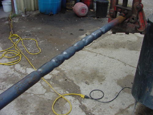

#21
This is after I've wire brushed it.
Keep in mind this is what the whole frame will look like when it's been sandblasted and then powder coated a clear finish.

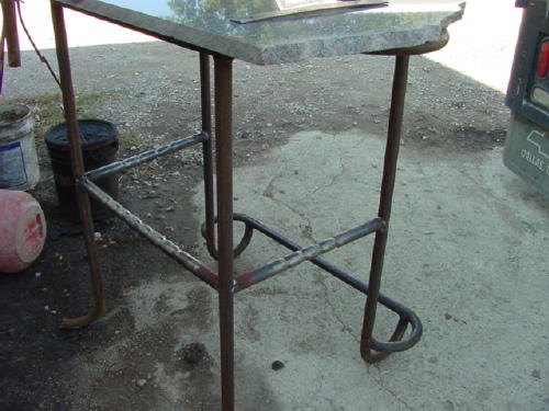

#24
I've got to finish up the stools. Finish welding up and cleaning all the welds on the table too.
I'm going to epoxy some stops under the table to fit snugly inside the frame. That will enable us to dismantle and deliver the table.
I will take some grinding wheels and shape the stone to my desired shape. Then it will go to the granite shop. They will router a bullnose edge and do a final polish.
I want the bullnose because it will compliment the pipe framework.
It's coming together. I like that. /forums/images/graemlins/grin.gif

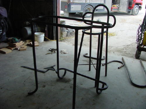

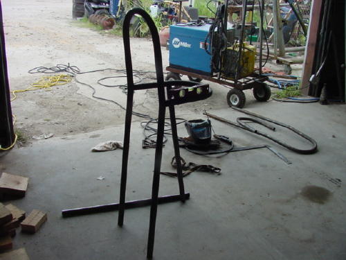

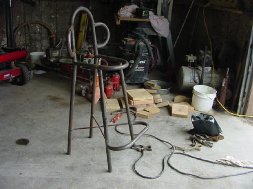

I finished one of the stools today.
/ Table project rock
#29
It's funny how these things seem to work. I start off with a concept and then the project sorta kinda takes off and I'm just along for the ride.
This isn't what I originally had in mind. But it led me to a better place. I like and need that.

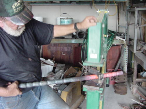

#36
Then it's to the anvil and my Uri hammer to do the fold over.
#37
That Uri hammer is about as good as it gets. My hands don't do it justice. But I'd kill if anyone touched it with bad thoughts within a block of their mind. /forums/images/graemlins/grin.gif /forums/images/graemlins/blush.gif /forums/images/graemlins/tongue.gif
