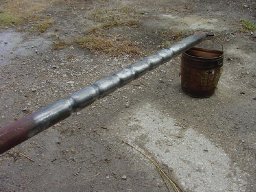

This is after I've wire brushed it.
Keep in mind this is what the whole frame will look like when it's been sandblasted and then powder coated a clear finish.

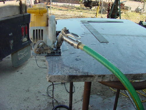

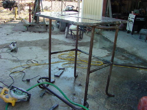

Here's how I cut three cm granite.
   / Table project rock
#23
Another view.
This is a framer's Dewalt worm drive with a diamond cutting blade. The blade cost more than the saw. /forums/images/graemlins/frown.gif But a regular circular saw doesn't have the grunt to cut like a worm drive will.
The water is important. Just as important is having GFI breaker real close when working a hundred ten and water. I've got to get me one of those. /forums/images/graemlins/grin.gif
What will surprise some folks is some of the best granite counter top craftsmen do it just like this. They'll have their sheets of stone delivered to the job site. Put up a temporary shade and go to work. And their work will be just as good as some of the stuff cranked out of the shops. Sometimes better.
No magic, just effort and patience, how do you think Rome was made?

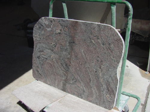

This is the rock at the granite shop after I rough cut it out.
That was last week. If I get the time we're going to have them do their magic while I'm there to photograph it. It might be this week or next week. That will take the granite shop and me coordinating our schedules.

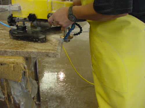

Here's the router that does the deed in action on another rock with a different bit that what we're going to use.
This thing is awesome.

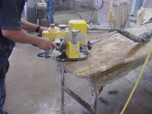

another shot

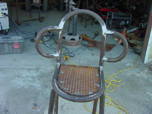

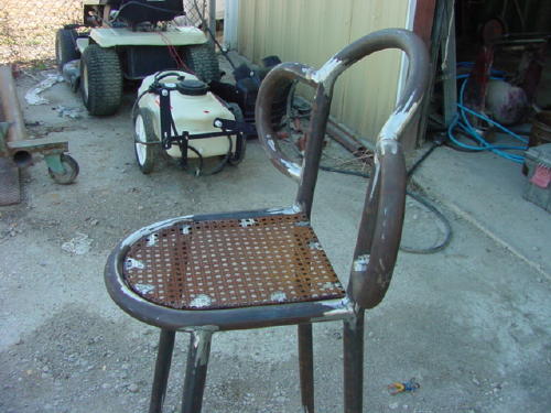

I finished one of the stools today.
#29
It's funny how these things seem to work. I start off with a concept and then the project sorta kinda takes off and I'm just along for the ride.
This isn't what I originally had in mind. But it led me to a better place. I like and need that.

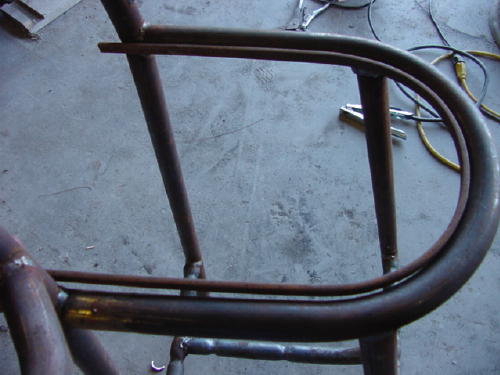

I thought someone out there might enjoy seeing how I made the seat cushion.
First I had to bend a piece of quarter by half bar stock to fit inside the pipe frame.
