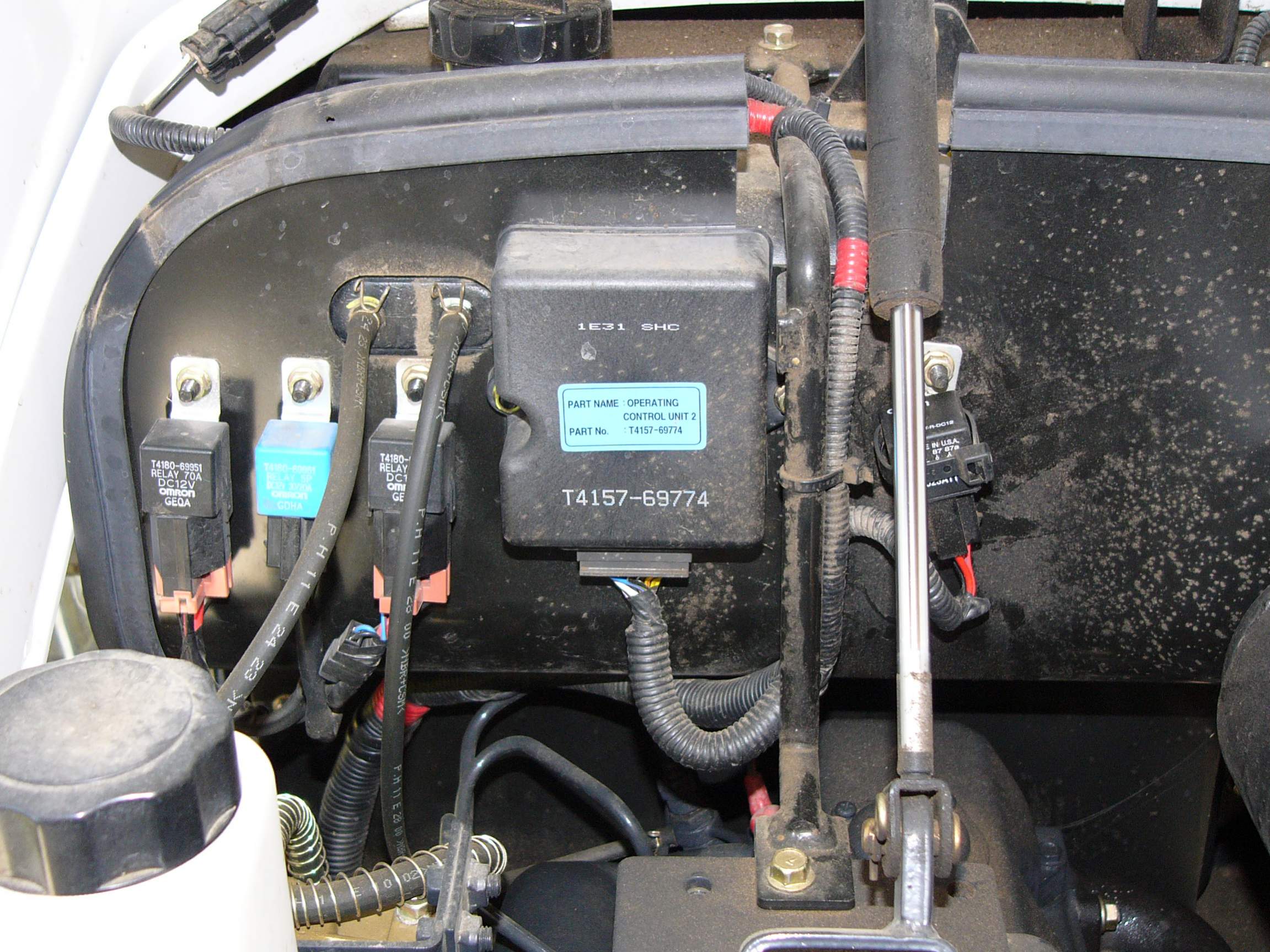

I'm not sure if your engine compartment layout is the same as mine. In the attached picture, it's
the first relay on the left. The attached diagram describes it as the ignition switch relay.

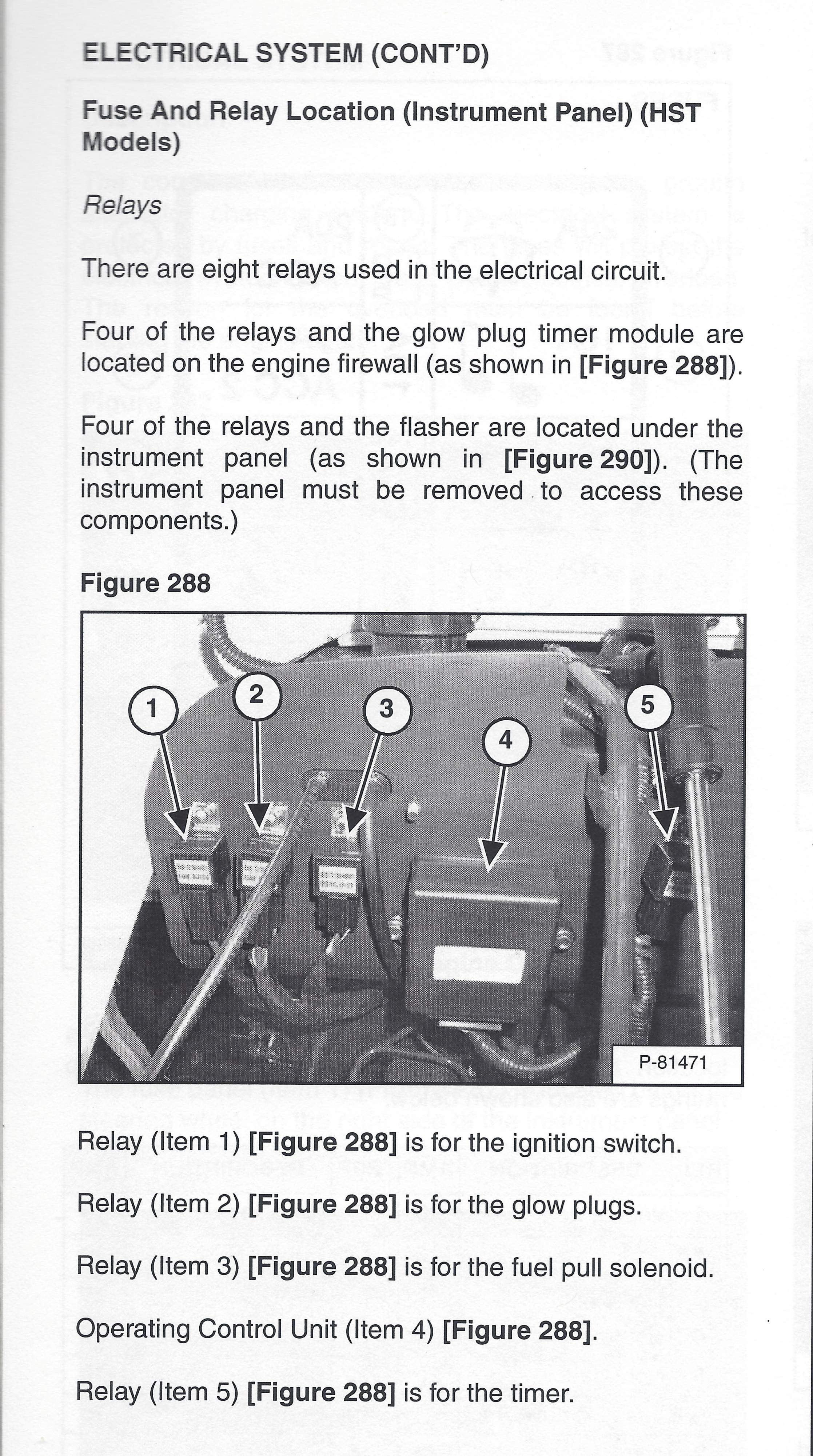

Thanks to the advice from the guys on this board I have found the problem and fixed the issue with the dash panel instrument lights on my CT450. Some lights that should come on didn稚, others that should not come on did and the tach worked only intermittently. In the interest of simplifying life for other CT owners, here is my experience.
The problem was a faulty relay as many suggested, but which one? The problem was compounded by the fact that both the operation & maintenance manual and the repair manual contain a serious error in the discussion on relays.
There are four relays on the engine-side of the firewall. Both manuals have mislabeled the function of these relays. I discovered this after I replaced the relay labeled 妬gnition switch which didn稚 fix the problem. After hours of screwing around, I compared the wiring schematic to what the manuals said, and Eureka the problem leapt off the page. The manuals were wrong!
As others have pointed out, there are four relays on the engine side of the firewall. It is important that we all are talking about the same thing when we talk about right and left. The manuals label these relays from the tractor痴 right-side or YOUR LEFT SIDE AS YOU ARE FACING THE FIREWALL FROM THE FRONT OF THE TRACTOR.
Here is the correct order and function of the relays followed in parenthesis by the erroneous order listed in the manuals. The order is from your left side as you are facing the fire wall.
1. Pre-heat relay (ignition switch)
2. Starter relay (glow plugs)
3. Fuel pull relay (fuel pull relay)
4. Operating control unit -this is not a relay.
5. Switched power (timer). This is the relay that most likely is causing your problem.
View attachment 403101View attachment 403102
I realize that this problem has been solved but I want to correct the post that I made.
As others have discovered, there was an error in the CT335 operator's manual. In the
diagram in my post, the Switched Power Relay is the far right relay, labeled TIMER Relay.
I didn't discover until recently (the last week) that the service manual shows the correct
location of the Switched Power Relay as the far right relay on the fire wall. Hope this helps
others that experience this problem in the future. I just replaced that relay after
experiencing the same problem again three years after replacing the first one.
