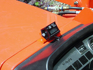

Installed the tiny tach today using information from this thread, worked fine, no problems and it works as advertised. Decided to use a piece of velcro to hold it to the dash instead of fabricating a plate or drilling holes, seems to hold fine. I painted the transducer grey to match the fuel injector lines as specified in the instructions, guess this is done to offer some weather protection.
Received the invoice in the mail today for the tach, unusual approach to ship the unit without actually receiving payment first but I sent off a check to them today, obviously if they didn't get their money very often, they would have stopped using this approach.
Thanks to all for sharing their install information and pictures as it did simplify and help make this about a 1 hour job.

Did you cut the transponder wire, or just coil it up, its about 3 feet too long? I have a gap when the hood shuts, the wires fit in the gap without drilling a hole in the black plastic. Any reason why you choose to drill a hole? The wire for the power fits through the space for the throttle cable, did you just fit it through the space or make another hole? And finally what size male spade did you use to connect to the loose connector above the battery?
Thanks for your help.
   / Tach installed on BX #29
I didn't drill any holes-- ran the transponder to the engine compartment through the hole for the throttle cable and just bundled the extra wire using a small tie wrap to hold the excess. There was also room under the grommet around the lever for the hood release to get the wires through to mount the control unit on the dash. No drilling, cutting or other modifications.
Don't remember the exact size of the spade lug for power, probably 1/8" or so, I had quite a few laying around just found one that fit. Good luck with the install.

Tom, just coincidently, I just installed my TinyTach yesterday afternoon. I just coiled up the extra line and wire-tied it to the wire harness under the hood. I made a small bracket out of aluminum to mount the tach on the fixed portion of the hood just in front of the dash. Yea, I have to lean forward just a tad to see the reading, but it's not something I'd be concerned with "constantly". Pic attached of the mounted unit.
