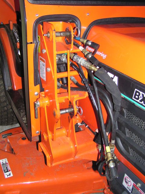

I have a Curtis Cab on my BX 2200 and LOVE it! However, you should be aware that 1.) It makes it much more difficult to remove the FEL or other attachments because you can not use the quick disconnect frame on the right side since the hydro joystick goes through the firewall of the cab. You must leave the hydraulics in place and remove the steel pin at the loader arm pivot point and the steel pin at the end of the cylinder. You must also add quick disconnects to the hydraulic hoses. 2.) In order to use this cab with a back hoe you would have to remove the rear canvas panel and then you would still have to deal with the cab roof. It hink it would be awkward at best.
Here's a picture of the right side with the loader off. You can see the two steel pins I'm talking about. They have to be driven out and they need to go back in in the proper rotation because the clevis pins that hold them in place also go through the shoulder of the hole on the loader frame. It's a pain in the butt, no matter what they tell you! /forums/images/graemlins/mad.gif
