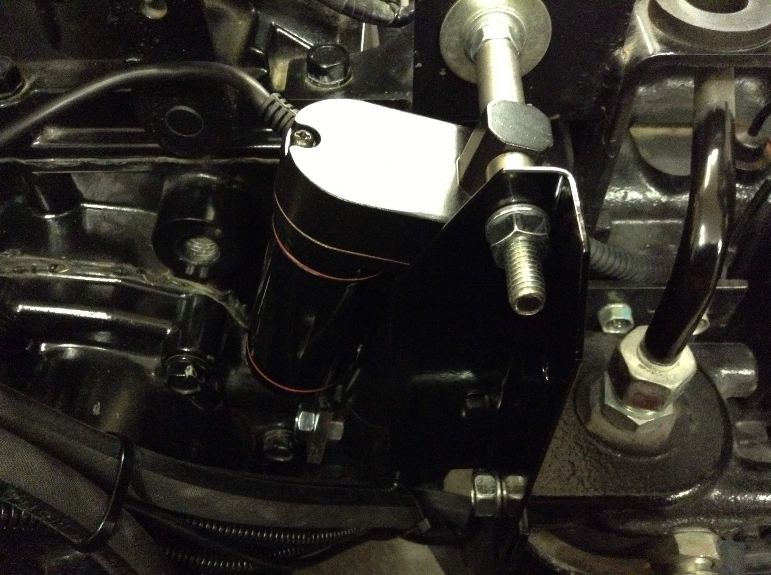

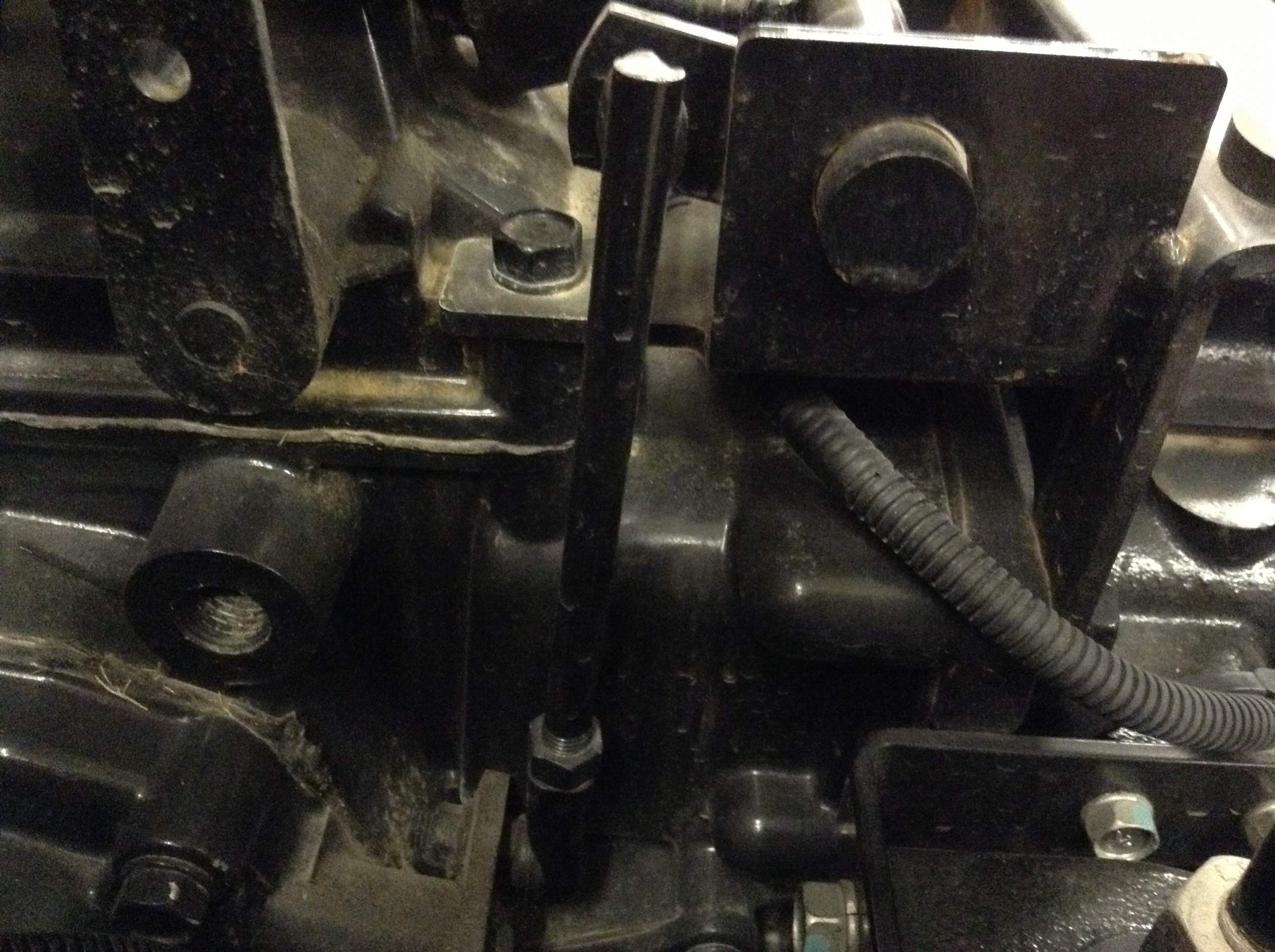

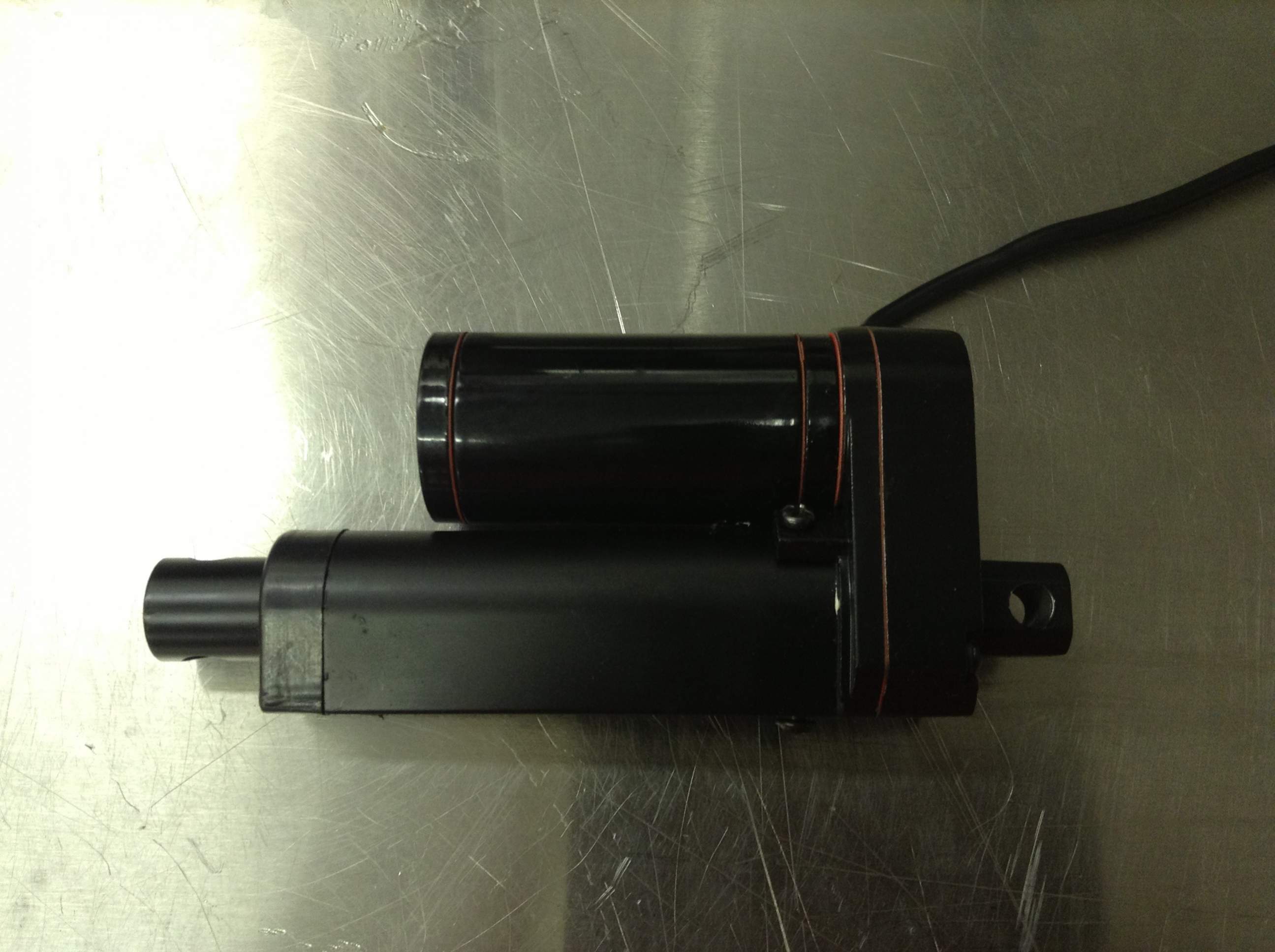

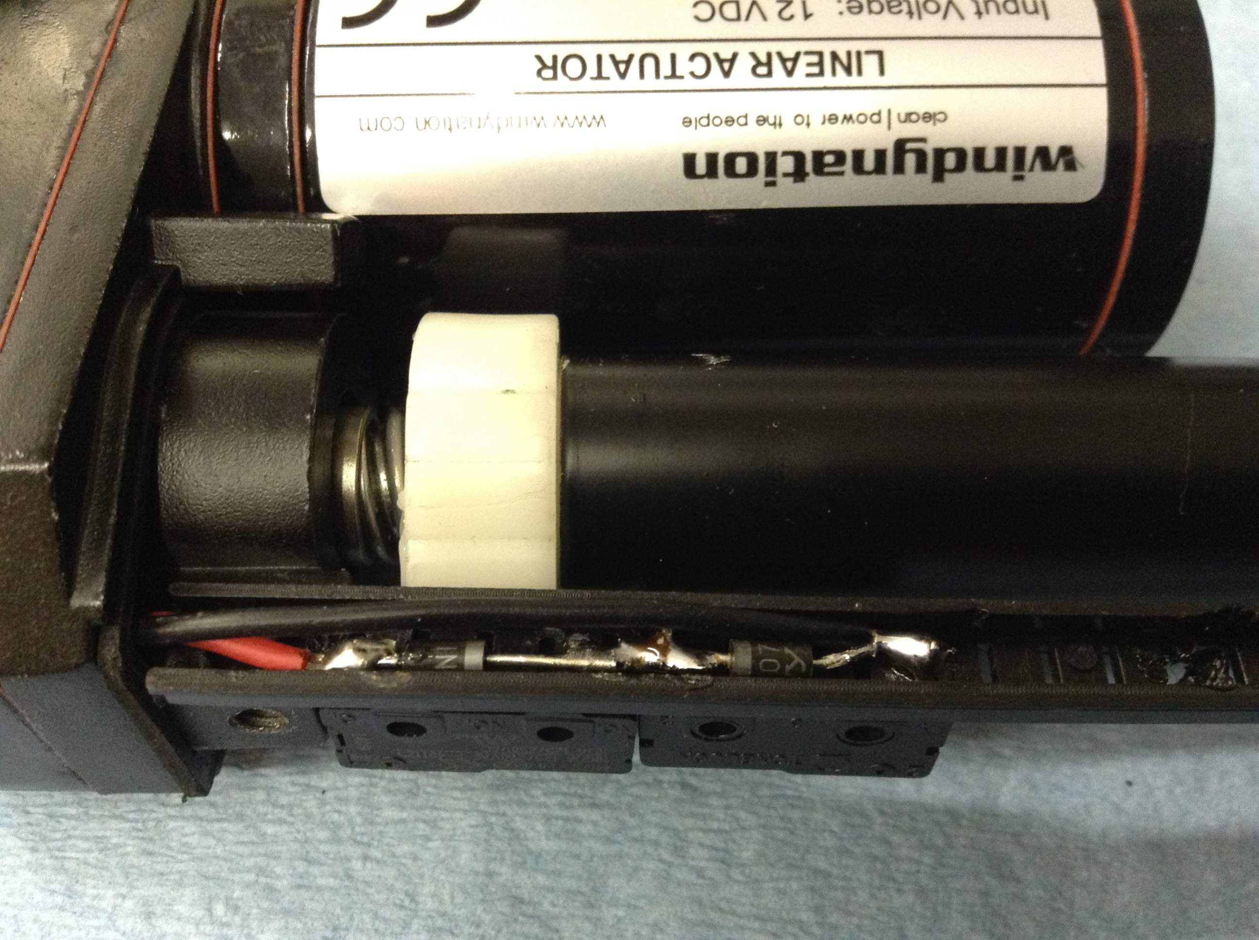

I finished the mounting of the linear actuator I am using for my diff lock. The actuator has micro switches internally used for limits, I had to relocate them due to the 2" of travel being way to much. They did not make it easy but I was able to solder them where I needed them, I now have 1/2" of travel instead of two. I made one bracket and was able to mount everything using existing holes/bolts on the tractor. I still have one fender to paint but I can cover this up now and move on. I have to wait for the switch and I ordered a winch controller to be able to run the actuator motor forward and reverse or diff lock on/off. It has quite a lot of power for it's size, I am happy with the results so far. Worst case, all the manual foot pedal stuff goes back on easily as nothing was modified to make the E-lock work and I have a $40 actuator to use for something else. This project really made me think as far as the mounting location, but it looks like it was always there now.
View attachment 404000View attachment 404001
That looks super Black. Just to be sure, you mustn't engage the lock with wheels turning (or at least not beyond "creep mode") and as soon as you do not need it, pressure for the lock should disengage. Not attempting to tell you something you perhaps already know but I once stripped the differential bolts off of my old tractor because I kept engaging with the wheels turning (sometimes wheels spinning real fast)
