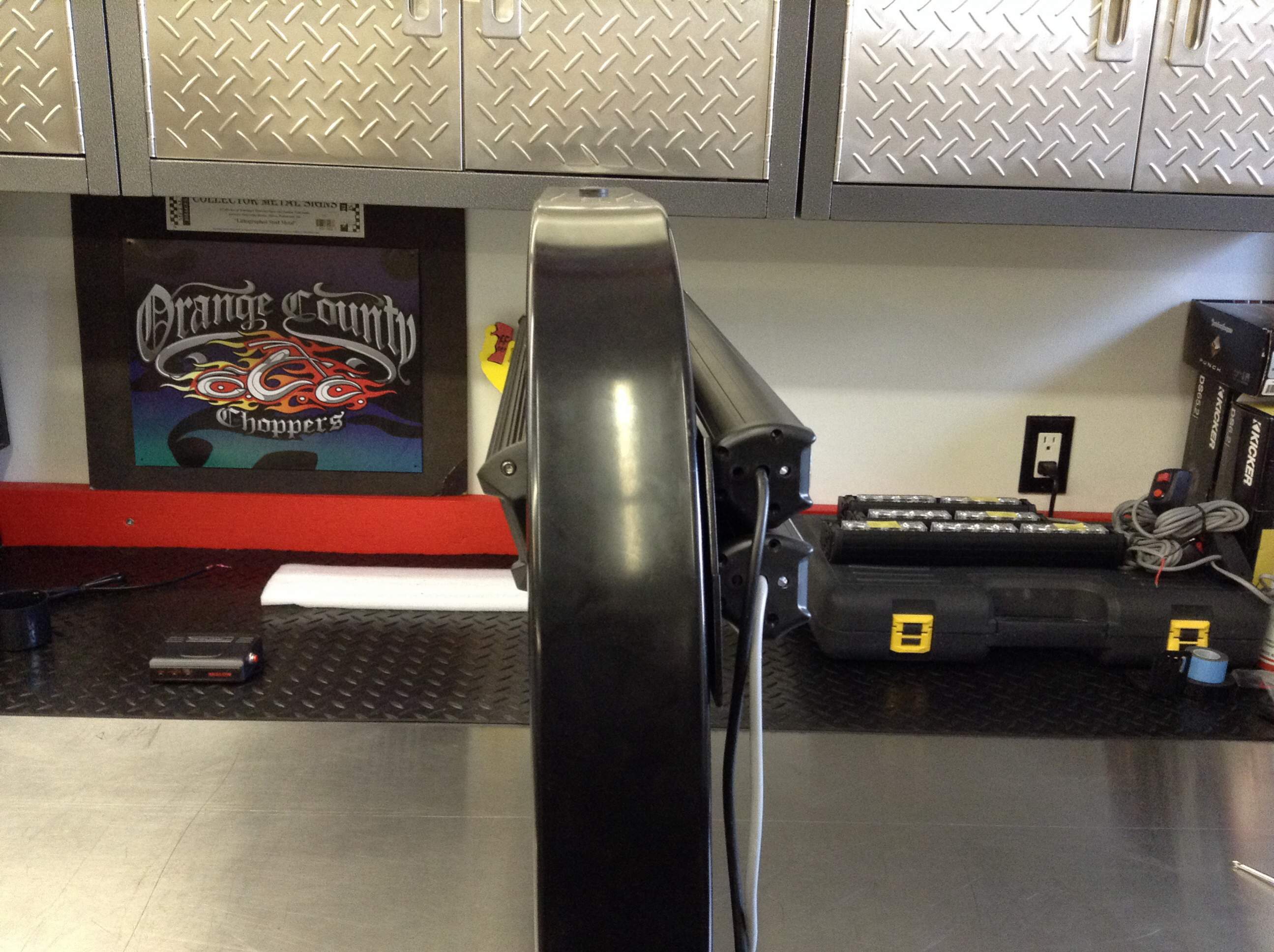

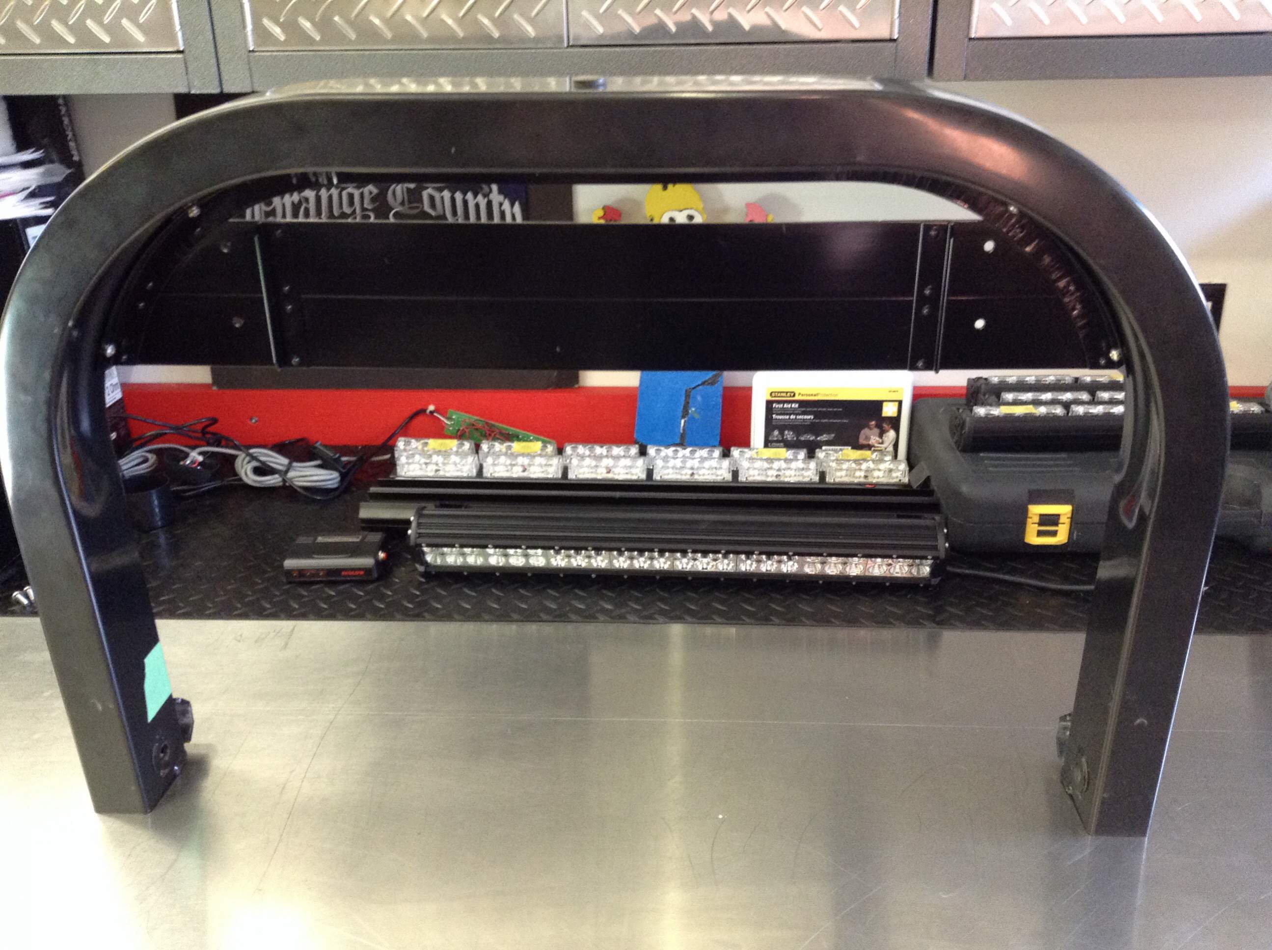

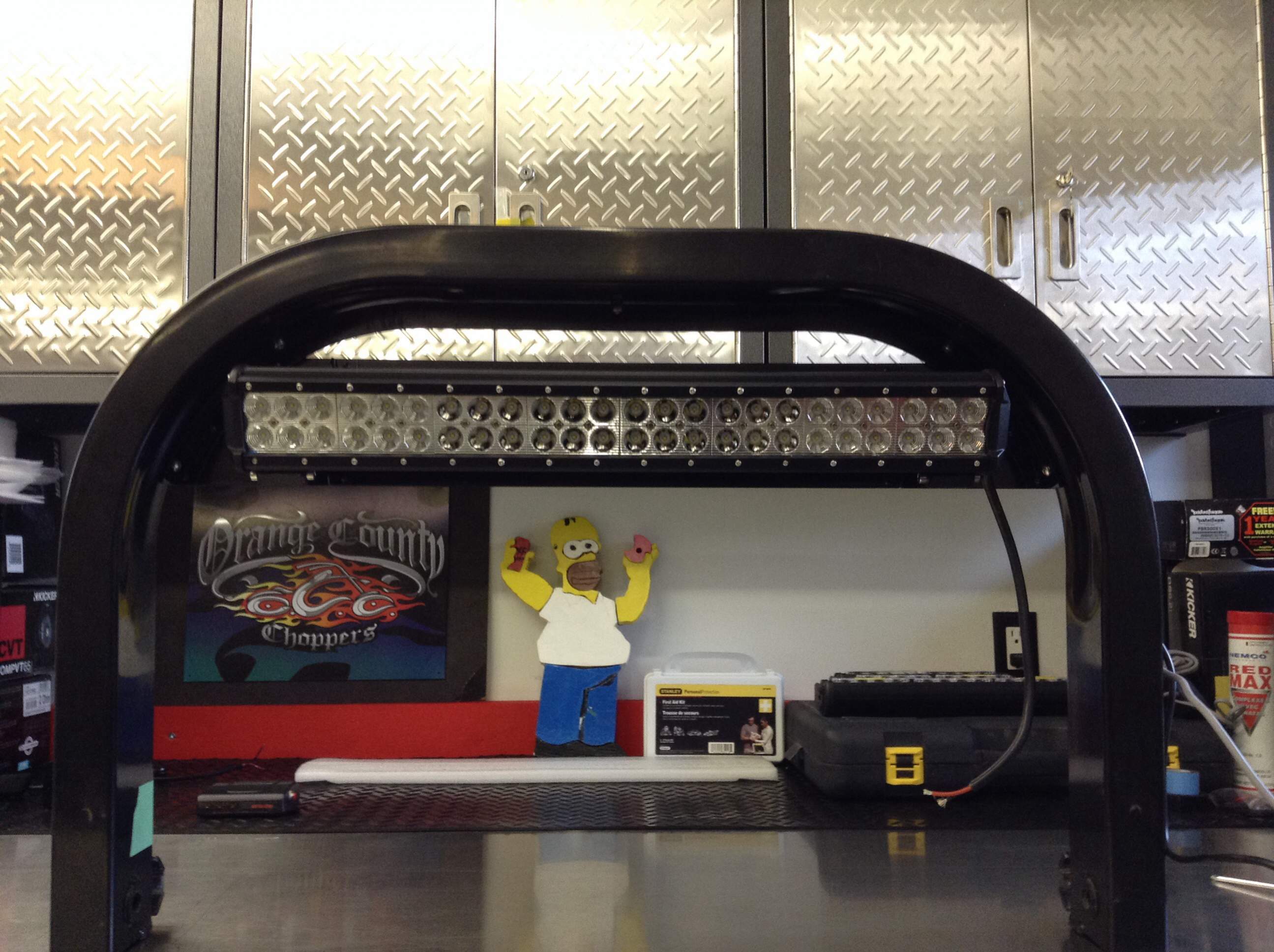

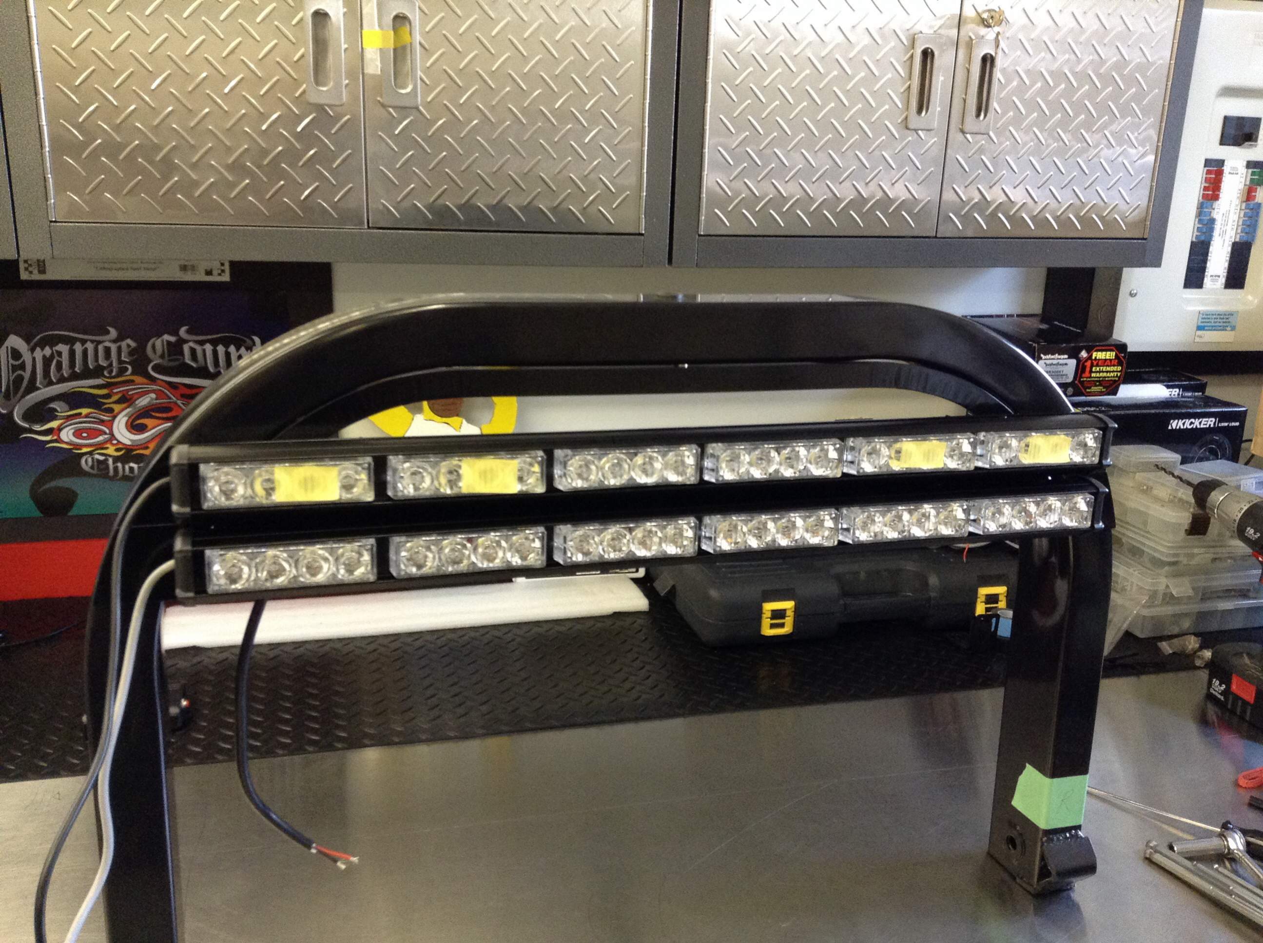

Here is the pics of my lights mounted up, I like how the LED light bar tucks into the ROPS. The top light bar on the back is the emergency strobe lights, yellow tape is just marking which lights are Amber as I have to re wire them for my controller. Bottom bar i am using for a work light, I will wire them to come on with my manual reverse light switch.

are you planning on lighting the local college football stadium?
   / Takin it to the MAX #87
We need to see that sucker at night now!! :thumbsup:

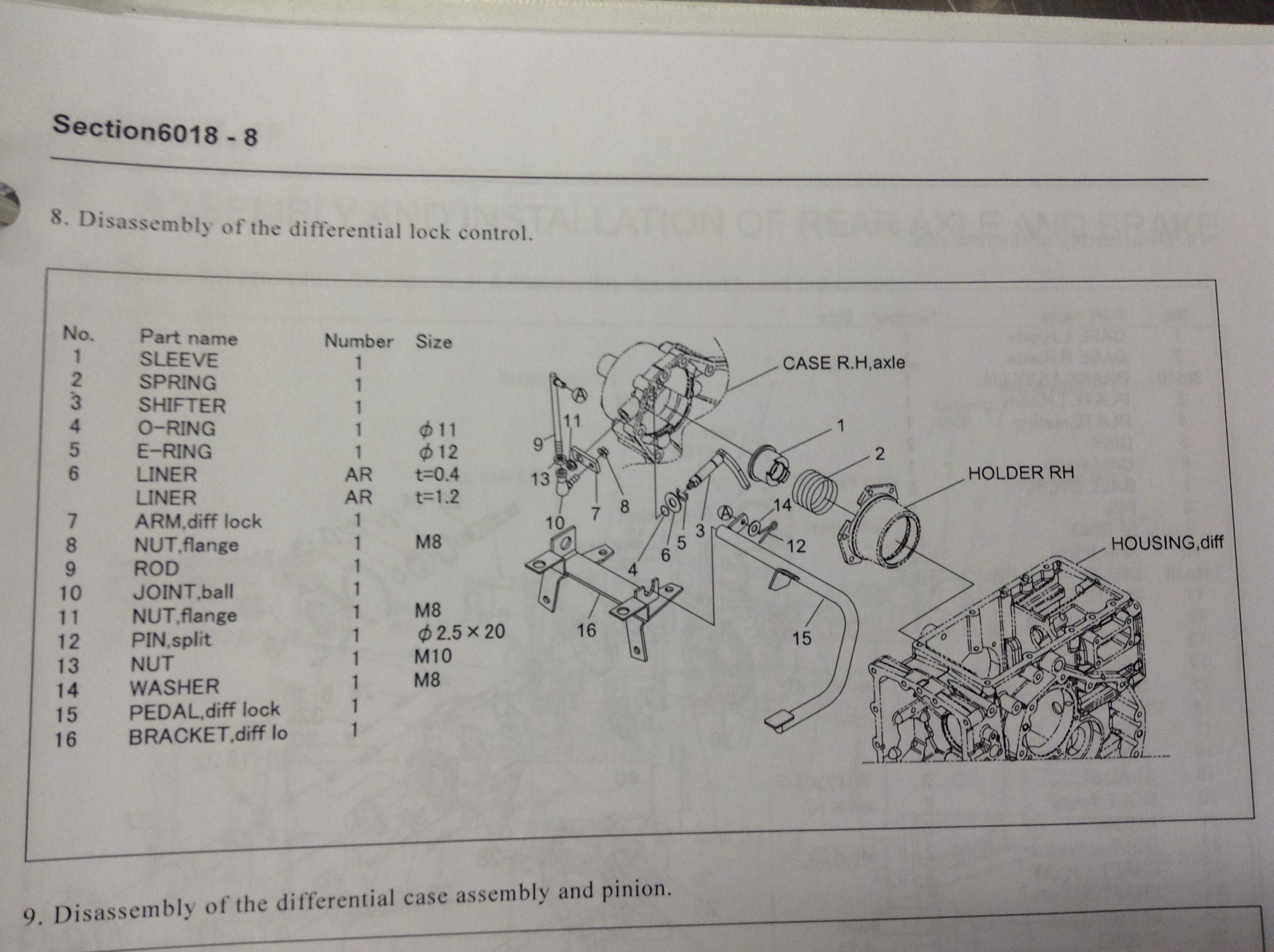

One of the things that concerns me with your locker actuator setup is if the gears aren't lined up perfectly when you hit the button. My Massey's foot pedal goes down about an inch if things aren't lined up properly, and then once I turn the tires a little it drops the last inch and engages. How will the actuator handle that? Will it force it and break something, or put pressure on until things line up without damaging it?
Even the electronic diff lock in my truck is spring loaded for that reason. The electric motor puts pressure on a coil spring to push or pull on the actual locker to engage or disengage. I would think you might need a similar buffer.

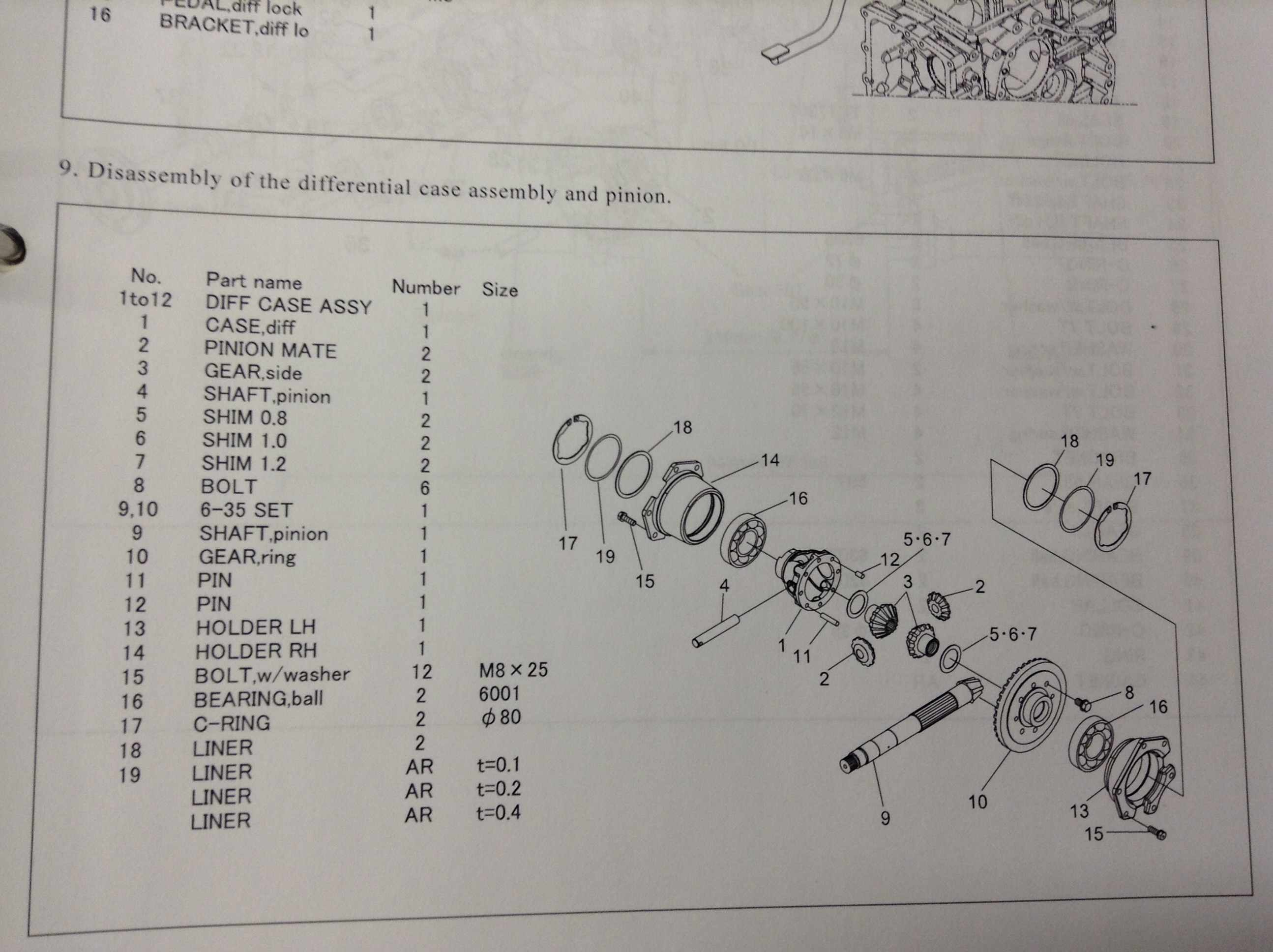

Here is all I have to go on out of the Mahindra 25 HST service manual... You can see the rod I replaced, the spring I need to compress, which is why I believed I needed to hold the pedal down to keep the diff lock engaged. The spring will separate the dogs item 1 in both photos when pedal is not activated. The linear actuator will try to run until the limit switch is reached, but seems to have a stall if overloaded. The dogs may not be lined up when I use the foot pedal, same for the actuator, and the tractor may have to move to engage fully in either case. The actuator itself I believe is the weak link here, not the internals. Keep in mind I have control with a switch, instead of my foot, difference being I will not have to hold the pedal or switch once fully engaged. The setting of the limit switches is critical, more to the life of the actuator itself as long as the travel of the actuator allows the dogs to fully engage, there should be no issue. I am also unable to accidentally hit the pedal with my foot now, it also gives slightly more foot room which is valuable on a Max25. I am not using a hydraulic ram here with thousands of pounds of force, only enough force to replace what I would have used with my foot...
   / Takin it to the MAX #89
Ok good. With the spring being internal I agree with your assessment. With the linear actuator pushing on the spring I would think you'd be ok as well.
