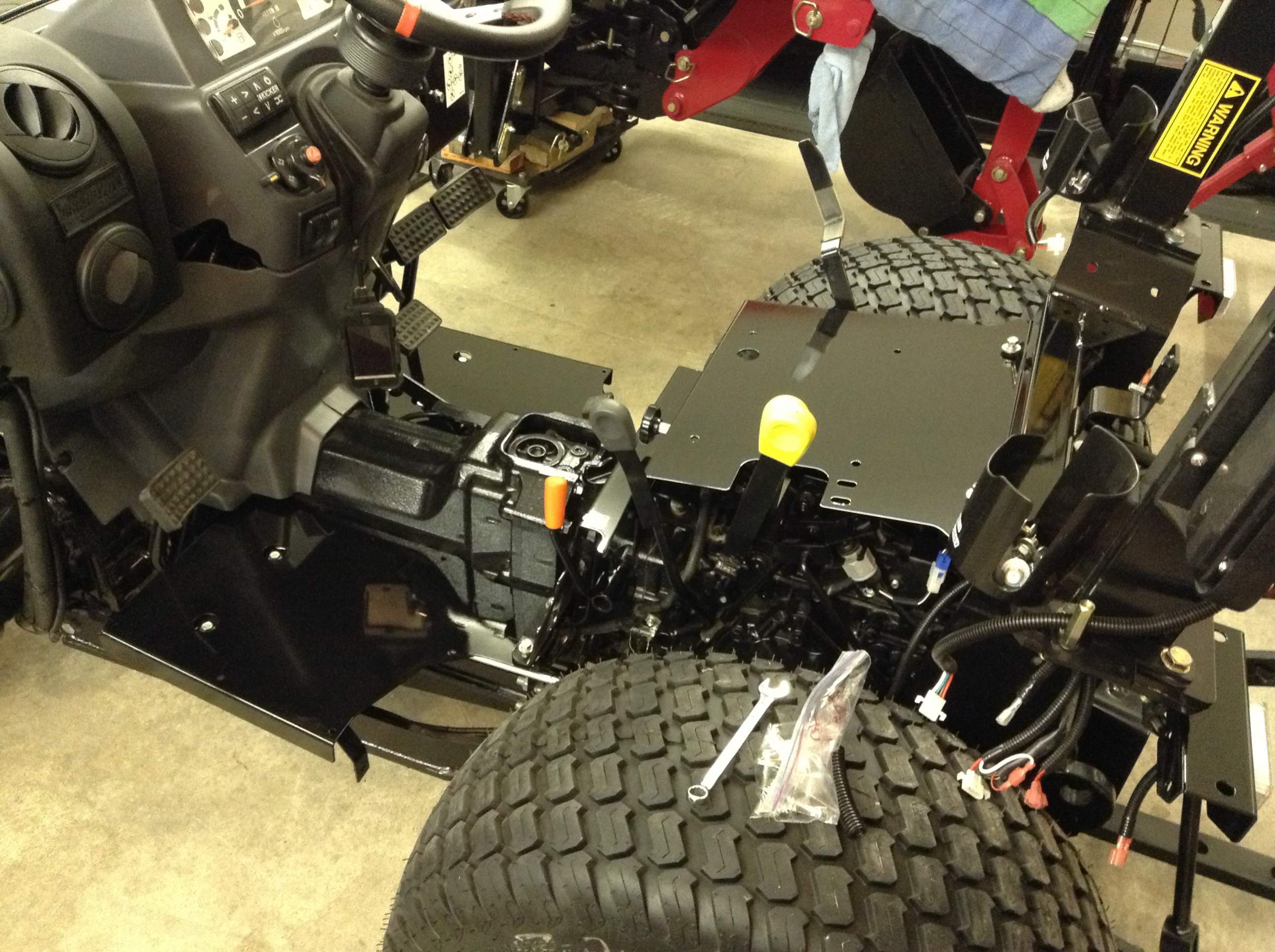

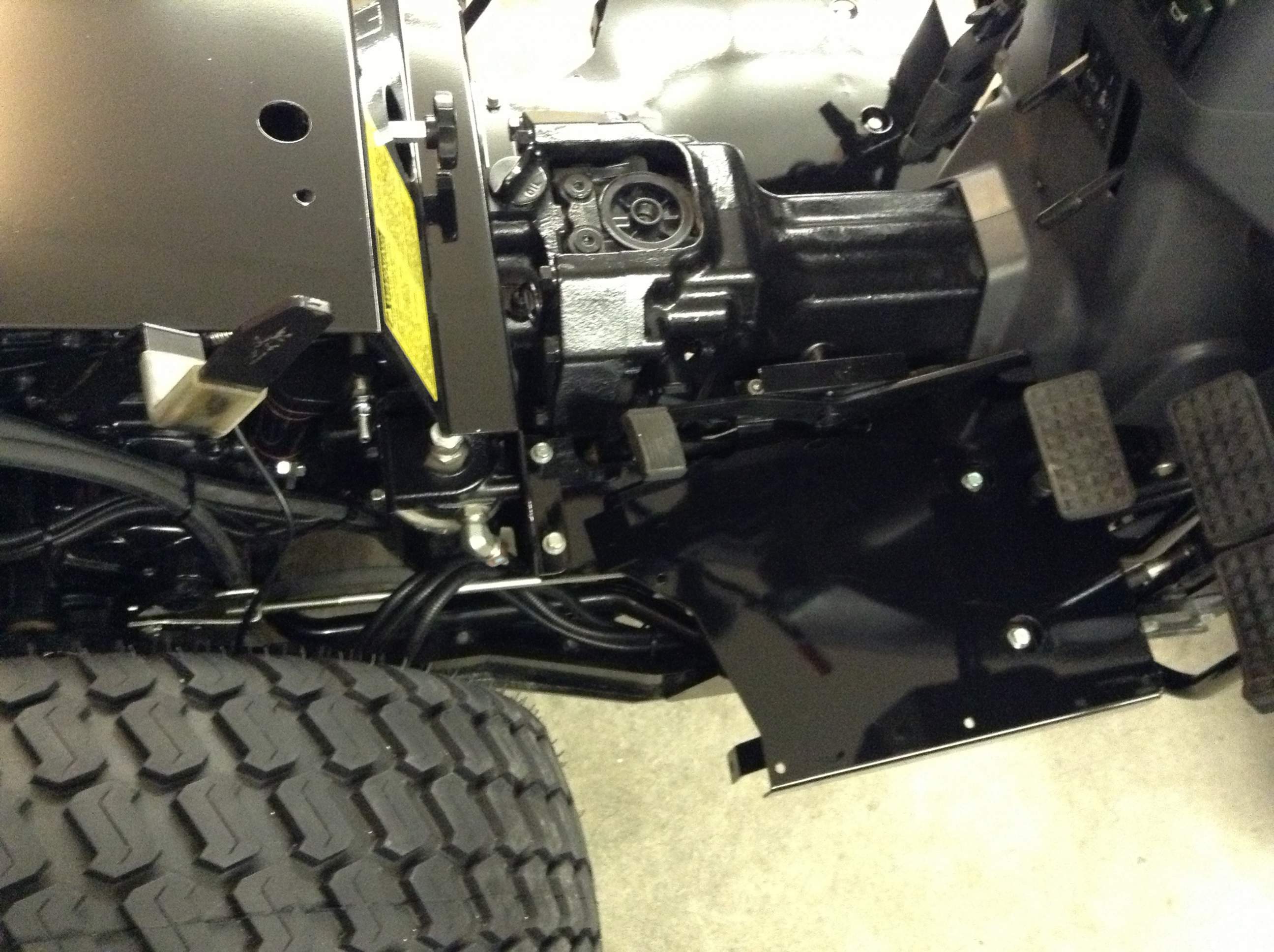

Thank you for sharing your experience, I wasn't planning on engaging the diff lock when moving. It just seemed silly to have to keep my heel on that lever at all times to lock the diff, I entered unknown waters here but hopefully it is now a set it and forget it thing. I was shocked how much effort it took to push that pedal, pretty serious spring in the diff. The linear actuator actually flexed 1/4" steel, I couldn't do that with my foot so power wise I am ok I think. I chose to go with turf tires in the snow and honestly my first time out with the Plow I never even spun a wheel in 4wd so this mod might be like that stupid loud air horn... It's there if I need it. Maybe a neutral safety switch should be used to be able to actuate the diff lock... Hmmm...

I still have one fender to paint and I will not be bolting them on until I mount and wire my lights on the ROPS so the complete pic's will have to wait. Here's a couple more teaser photo's and where I'm at today...

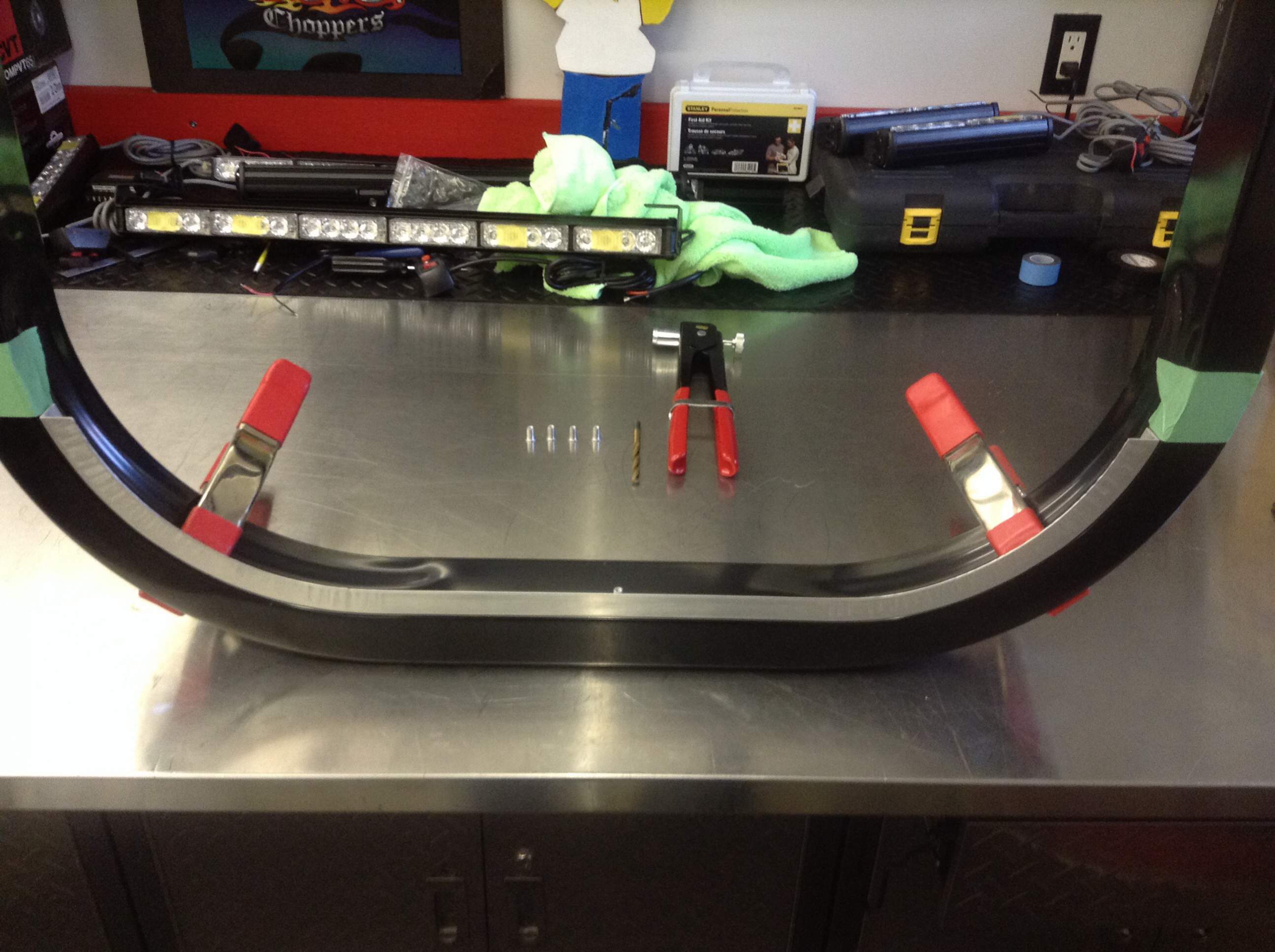

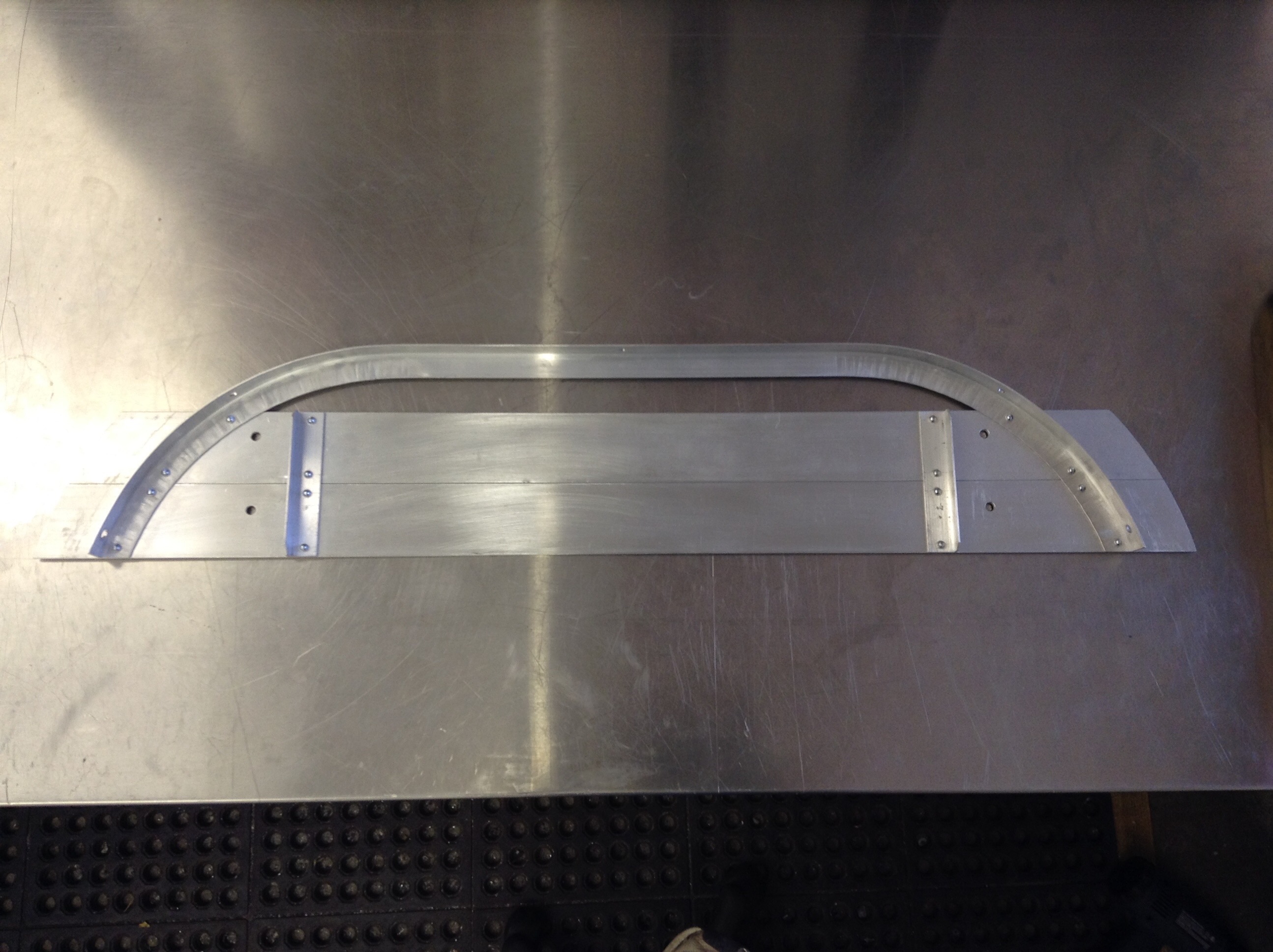

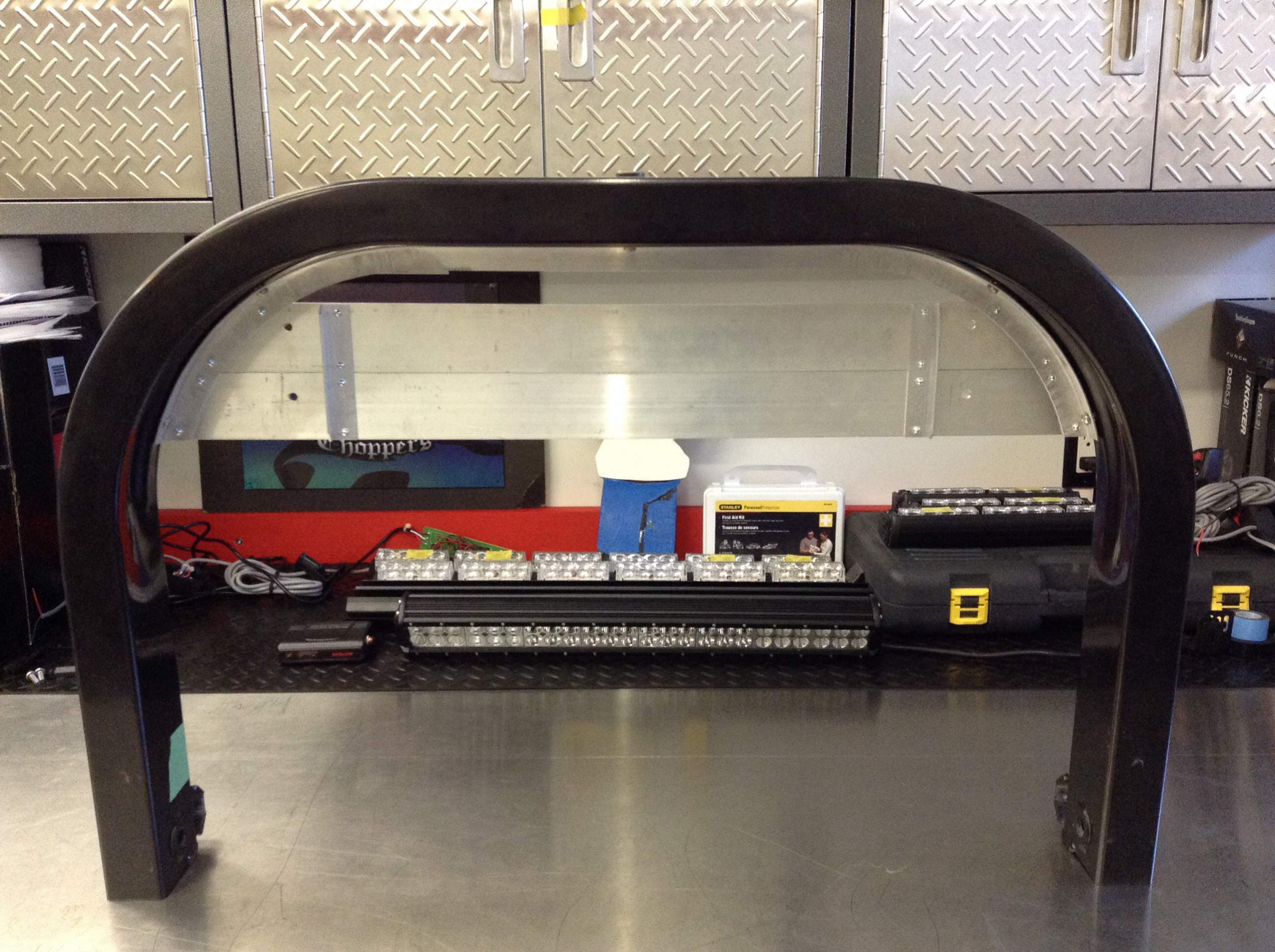

Here is what I decided to do with my light bar mounts, the lights themselves are pretty weighty so I needed something strong, but with a little stealth built in. I un- boxed my Princess Auto(equivalent to Harbour Freight) shrinker stretcher I bought about a year ago, assembled it, and made the curved piece. Took me about 3 hours on that piece, never having done it before, and I feel stupid cause I kept running over to the tractor and used a ladder to constantly check the progress/fit. Almost aerobic and the next morning it dawned on me to just unbolt the top of the ROPS and take it to the bench.... dummy. I will post a bench shot of the lights after the paint dries.
