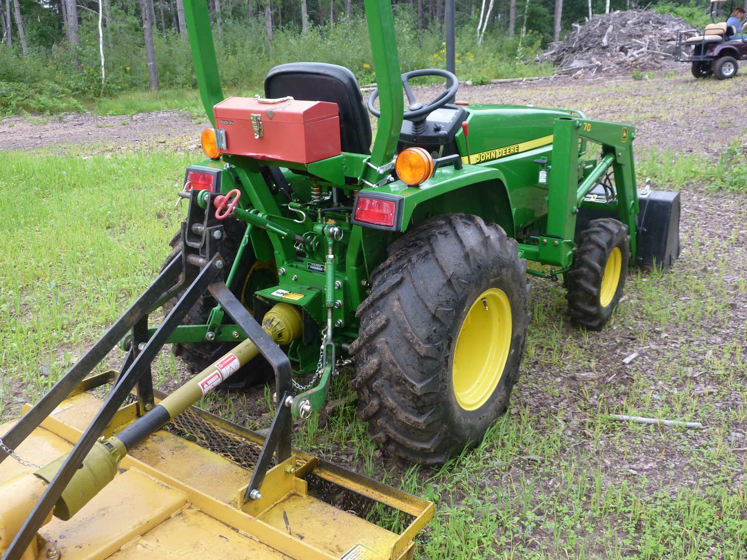

My KK rotary cutter came with a knee-action "pivot" affair to attach to my top-link. It allows the cutter to lift up about 10"+ to clear obstacles.....but limits the cutter from lifting too high. You can pick up the cutter...just like with a top-link.
I would think you could buy one of these brackets from KK.....and it may provide some solutions for others. I sure like mine....so I thought I would post this.
I wish I had a better pic.....also, it would be easy to make one of these.
My cutter has a pivot in the two rearward "down" straps.

On a side note: Those R1's look unusually large.

They look like they are the size of R4's, but the treads look like AG.
Yea...
I have the 3400 and the industrials for it and the 2800 have that look..
The ags are skinny...

Now I see that the rear treads seem shallow like R4's, but the front treads still look deep.
I think you are talking about the green tractor photo... and RT is talking about the orange ones?
