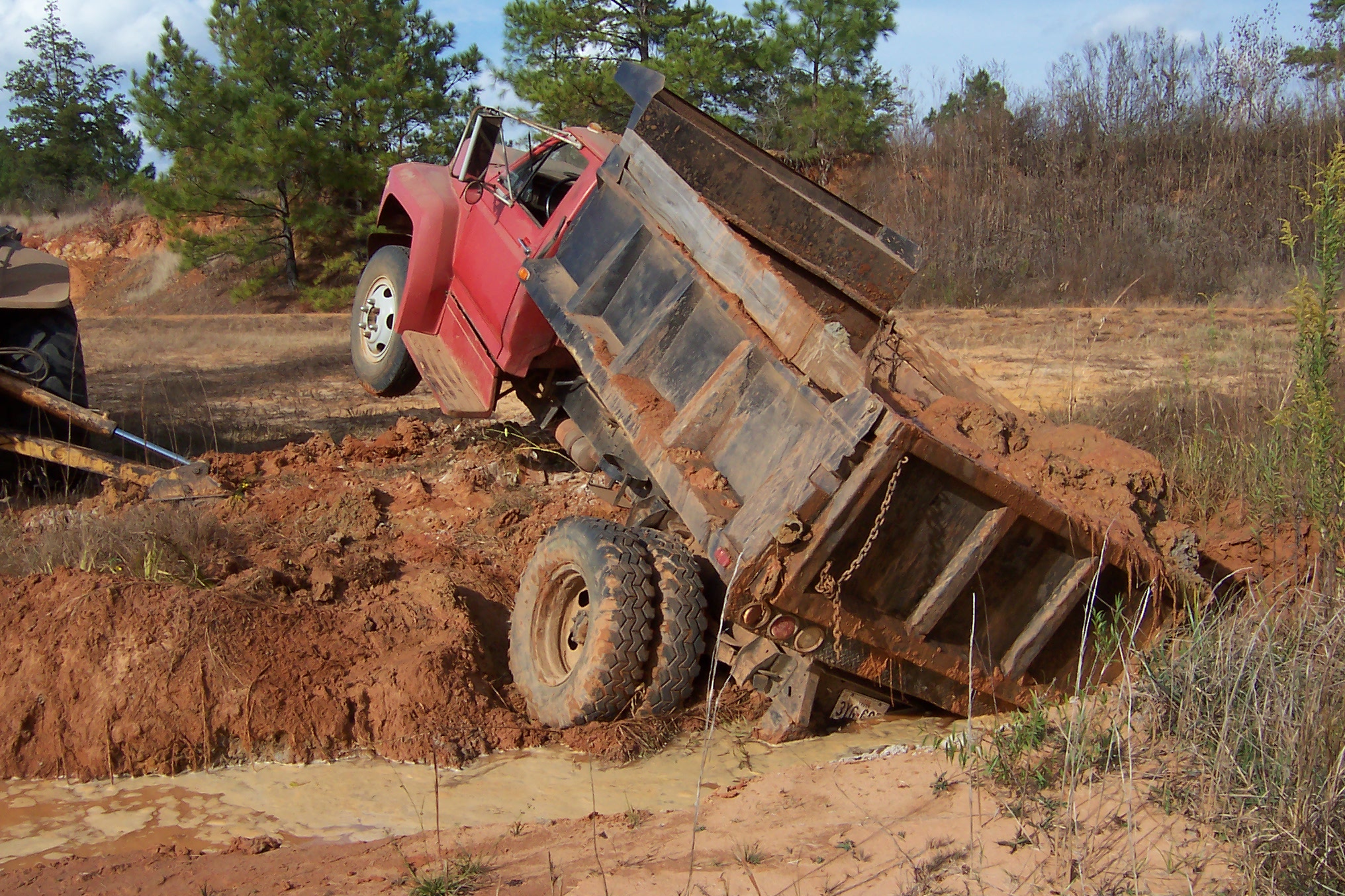

What I can share is some of my experiences with my Ford F-600 gasoline 5 yard dump truck. It's a single axle former city dump truck that I paid $3,000 for without plates or registration. It's strictly for moving dirt around on my land. With sideboards, I can add two more yards to it, but I tend to keep it to five yards per load.
The gasoline engine and manual transmission has plenty of power for what I'm doing. It's simple to work on and parts are fairly cheap. It sits for months, and even over a year between using it. When I do use it, it's pretty non stop all weekend and evenings to get enough dirt where I want it. Five yards is nothing, fifty yards starts to make a dent, 500 yards and you're getting somewhere.
My truck was designed and built to run on pavement. It's air filter was never meant for off road use, and eventually enough dust got through it to sand my cylinder walls. After rebuilding the engine, I added another air filter to pre clean the air coming into the factor air filter.
My dump bed lifts from a sissor type of mechanism powered by a one way hydraulic cylinder run off of a PTO that you have to put into gear, then rev the engine to get it to go up. This works fine until it breaks. Then it's a royal nightmare getting it all apart without any way to lift the dump bed to get to everything. I used my backhoe and bottle jacks to get the bed into the air enough for 4x4 posts to hold it up. Two on each side just in case one broke. It was one of the worse jobs ever getting it all apart. Fortunately my welding/machine show was able to straighten it all out and weld it back together for $500
If I was to buy again, I would get a dump truck with a single hydraulic cylinder that lifts the bed straight up. No scissor linkage!!!!
Look at the dumb bed. Is it perfectly smooth and flat? Or is it like my and bowed down between each rib so it will hold dirt that builds up after every load? After about ten loads, I have to get the shovel out and break all the dirt free. Then two years ago I bought a 4x9 sheet of heavy sheet metal and had them cut me another piece to make up the difference, and welded it over the existing bed. Just guessing, I think the inside of the bed is 5 1/2 feet wide. Now the dirt slides off real nice with just a small amount of build up at the corners that I pretty much live with when moving a lot of dirt around. I've tried different types of roll on paints with mixed results. Eventually they all wear off and your back to bare metal. Best thing to do is never more dirt with any moisture in it. If that's possible.
Lastly, if you are cleaning out mud, be sure to park it in such a way that you are not driving over mud or water that leaks out of the bed. Also be sure that if you slide backwards from lack of traction, that you wont end up in the pond.
