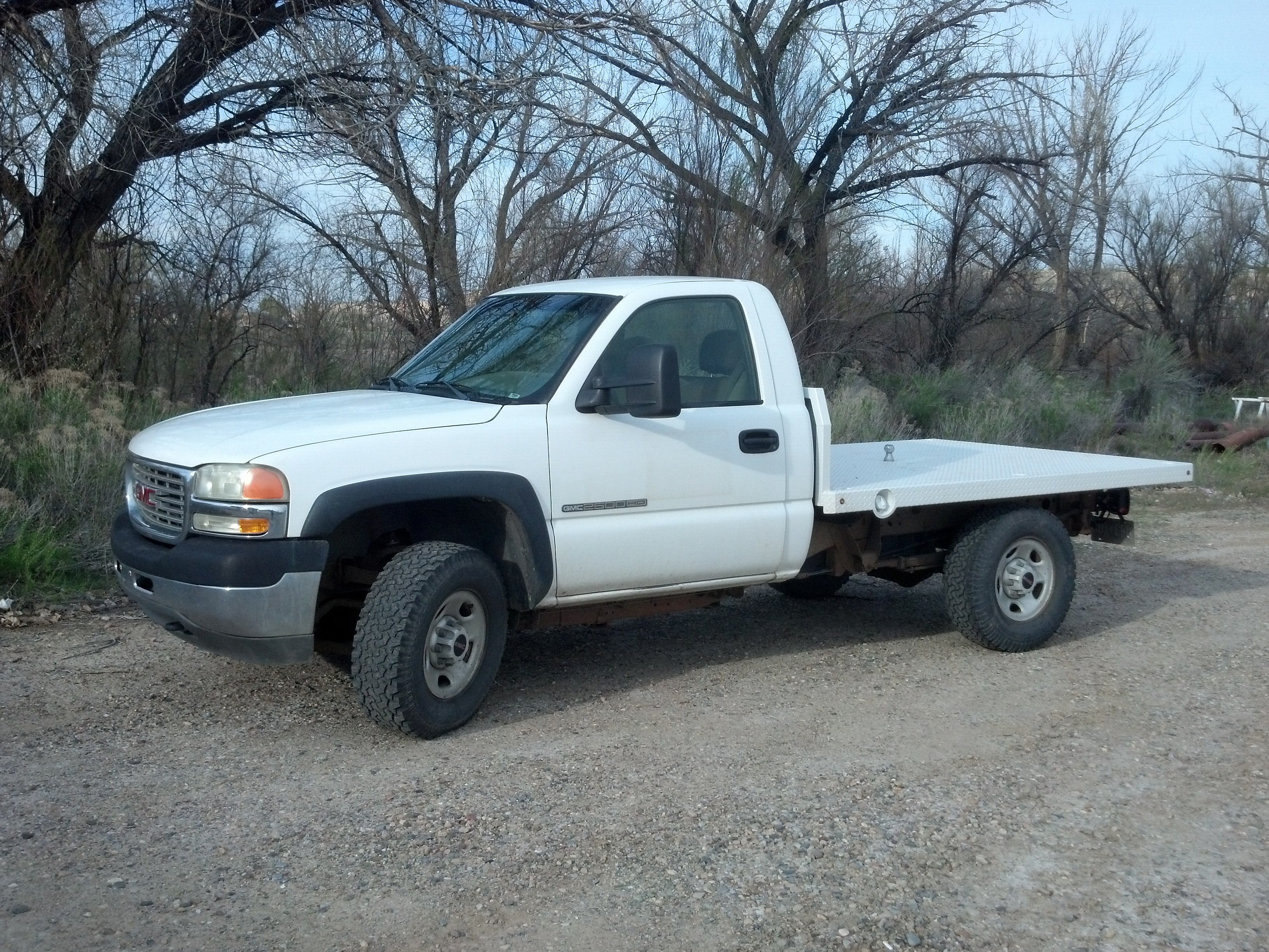

This thread has been really enjoyable, and full of good information. As I stated before, a dump trailer doesn't really fill my needs, but I have for now solved my dilemma...
I already own this flatbed, and was considering replacing it with a dump truck...

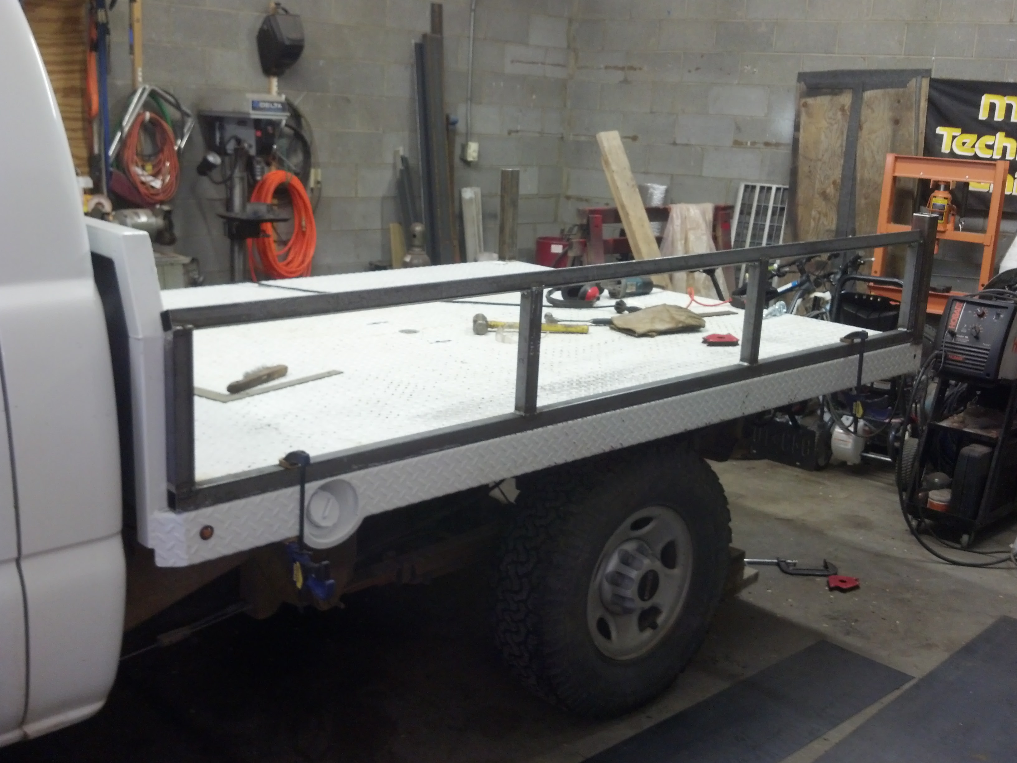

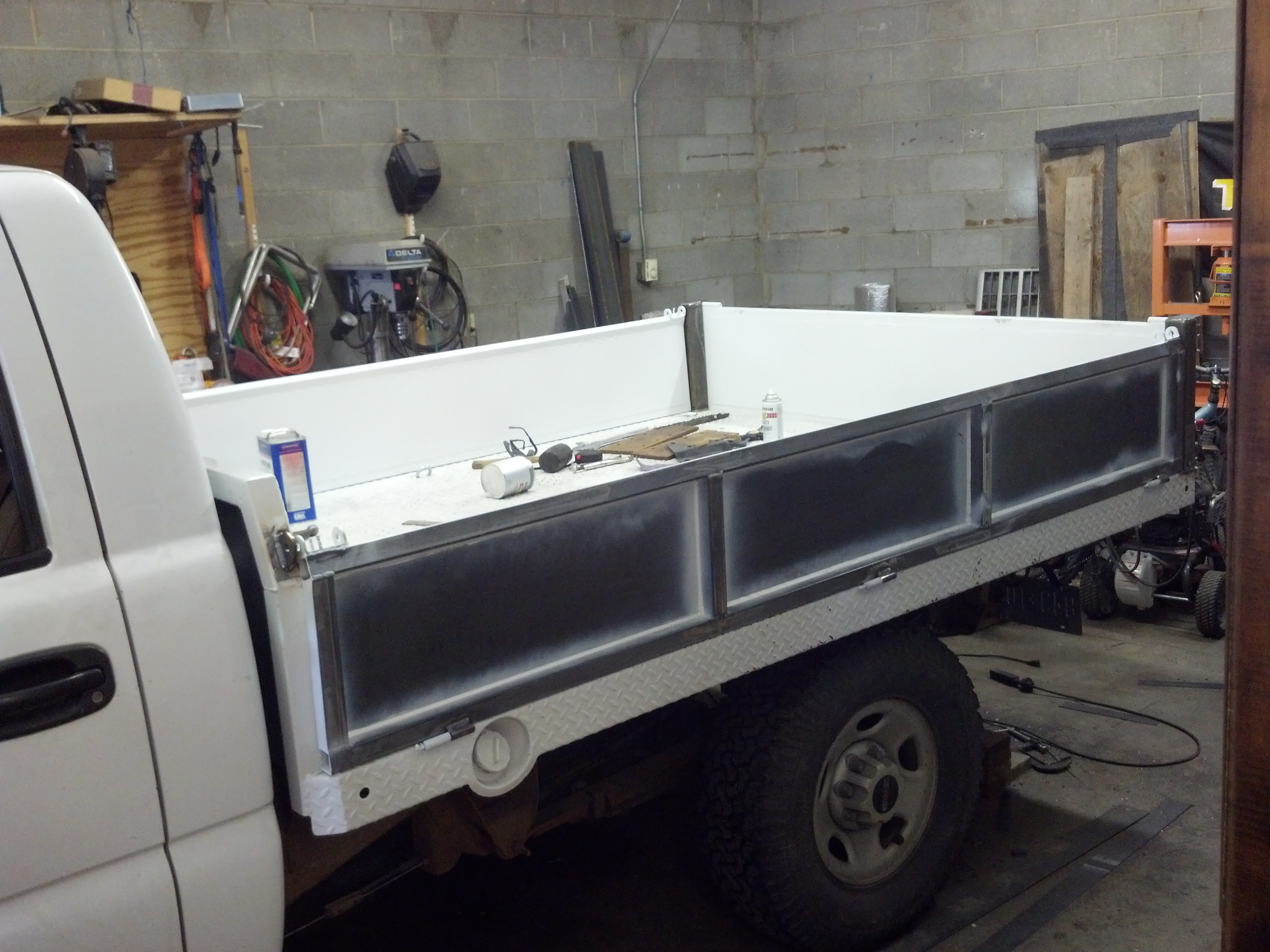

Instead, I'm converting it to dump, and adding drop sides and a two way tailgate...
I'll have to pay someone to haul in road base and gravel, but honestly, it'll probably cost me less in the long run than owning a capable dump truck (and maintaining it...) No CDL, no expensive registration, no DOT inspections, no unknown issues, and it's 4wd with low range. :)
It's not going to haul yards of gravel, but it'll work great around the property, and be fine for picking up smaller quantities of material. (Three gravel pits about 4 miles from our sub...)

Dude, that little pickup flat bed is NICE! A good flat bed / stake truck is a perfect thing to have. I have two! Use them all the time, well, the F450 needs battery cables at the moment, but they are good to have.

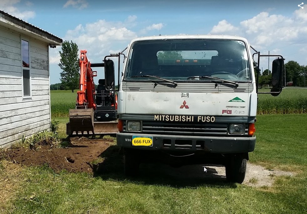

You're correct about trying to find a 4x4 Fuso, VERY rare and hard to find. I got super lucky with mine. Only had 90K on the ticker when I bought it. Needed a little TLC, but it's been an extremely good rig, sips fuel and can take one **** of a beating... I just can't get any more than 3 or so ton in it before I can't pull 5th. Poor thing is begging for mercy, turbo is probably melting when I have it loaded up.... Good thing there are not a lot of hills at all around here.
Her she is in "tractor" mode. I'll just drive that fugly thing around my property and use it as a giant ugly tractor.

When I worked for TRW, I tuned the traction control for the 2012's. (ABS/Traction/Stability control all from the same module, supplied by TRW.) I spent quite a bit of time driving them around. Our trucks all had the auto/manual trans, and I LOVED the way it worked!! Smooth shifting, and would "creep" when you released the brake, just like a normal auto. We never did get a 4x4, but I enjoyed pinning the pedal to the floor and cruising them around. The ones with the bigger engine were pretty quick, IIRC. Empty, that is... :)
Seems like a little FG Fuso would make an awesome plow truck too. I'm going to keep watching for a deal on an M1078... Quite a bit bigger than a Fuso, but probably quite a bit cheaper. More bang for the buck, so to speak. :)

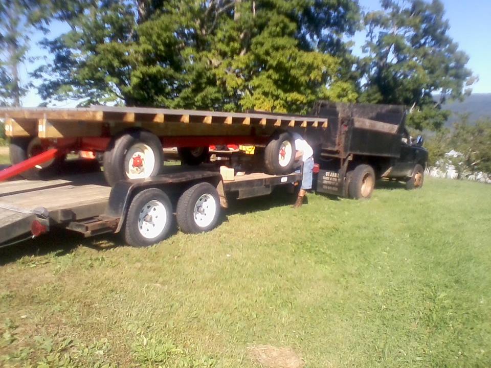

Ha here was one of more fun jobs...boss bought this restored hay wagon on a whim I had to go pick it up a 150mi round trip (boy did my back ache riding all that way in that truck)
So got to trailer a trailer on a trailer with that old truck ;)

My little dump-pickup is still rocking!
We used it a LOT to haul material (pretty much busted up and slightly damp clay) from the barn site down the drive for fill on the low side. I can get 5 heaping buckets of material on it before I start feeling bad that I'm overloading it... I have a 72" "HD" bucket, which is probably about half a yard. So 2 to 2-1/2 yards a trip... We also shuttled a lot of material from the back of the barn site to the front, where the fill will become my parking/turnaround area. Faster to load the dump and move it 150' 2+ yards at a time than to drive the tractor back and forth over and over and over... I bet we've moved easily 200 yards of material...
To make its life easier when we're working on the property, I pull the "4wd" fuse, then toss it in low range. Since it's an old school floor shift t-case, pulling the fuse just keeps the CAD from engaging the front, giving me 2-low. Works great for maneuvering around the property without all the binding from 4wd. Actually works well enough that I'm planing to add a switch on the dash when I get a chance...
It also gets to haul cold patch from Aztec NM up to Mancos CO occasionally as we fix up the entry road to our community. So far I've only picked up a couple 2k lb loads, but next trip will be 3k, since we'll be dumping and spreading, rather than shoveling it out by hand to fill potholes. Gonna have to figure out how to chain the tailgate so it doesn't just dump in one spot...
Had 120 yards of road base for the driveway hauled in by big truck a few weeks ago. About $100/load deliver charge, so $1k for delivery and ~$1200 of material. Now that I've got it fairly well groomed, it's a little thin out by the road. Rather than pay another $100 for a truck to deliver more, I'll just trip to the quarry at lunch a few times next week. Two or three lunches and it'll be fine. I'll probably pay for delivery when we gravel the 200' drive out tho the pole barn, but I suppose I could just make a trip a day for a few weeks if I wanted... It's 7 miles from my place to the quarry...
Since this was only a 3/4 ton truck, I did add a leaf to the pack. I had two #2 leaves left over from some spring work on my duramax a few years ago. Cut them a couple inches shorter, added holes for the slider pads, and slipped them inbetween the original #2 and #3 leaves with some new center and U-bolts. That seems to have done the trick, and it doesn't look so overloaded now, (even when it is...). :)
I did finally pile enough wet clay (out of a ditch that I was cleaning for the HOA) on it that it wouldn't dump backed up our drive, but my driver (wife) said she just spun around and it dumped fine with the front of the truck pointing slightly uphill. I think the hydraulics max out at about 6k lb... So that might have been a bit overloaded.
The drop sides are awesome for loading stuff, like the post hole auger and hydraulic skid steer attachment that I just rented, or pallets, or whatever...
No regrets as of yet, other than not taking any pictures of the work with my camera. I'll have to steal some from my wife. :)
