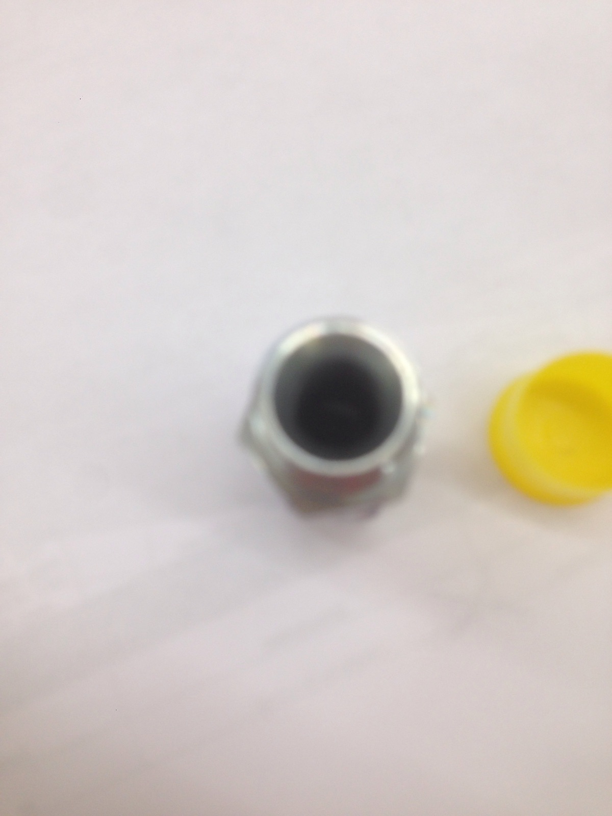

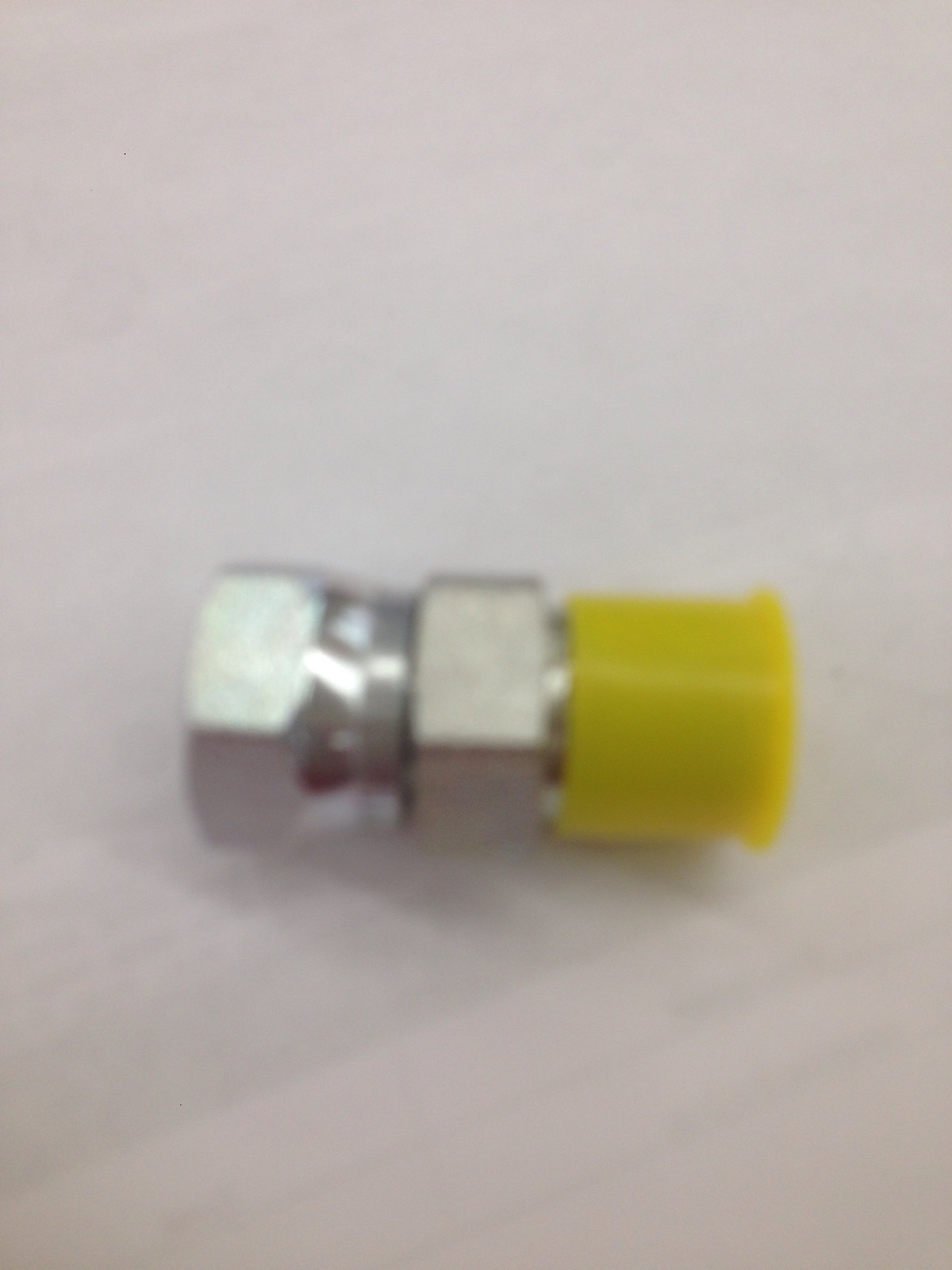

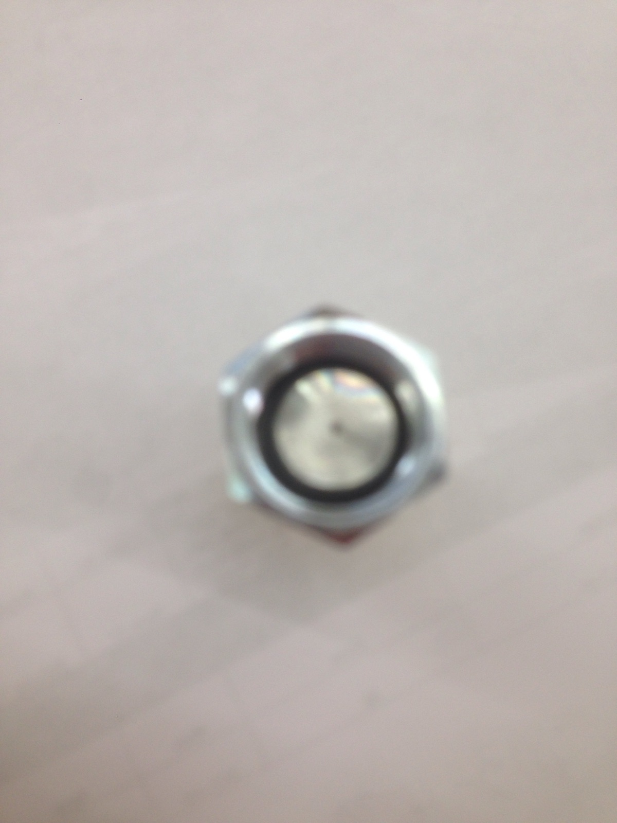

MechanicalGuy, unless there's something unusual about the rear remote valve your dealer installed, you shouldn't need an adjustable flow control fitting just to allow fine adjustments on your hydraulic top link. A simple "restricted orifice adapter" like this from Tractor Supply for $6.00 (Sku. no. 1256783) should slow the flow down enough for that. CountyLine 1/2 in. Male Pipe x 1/2 in. Female Pipe Swivel Restricted Orifice, 8MP-8FPXR-TSC at Tractor Supply Co.
Pics below, though not very clear.
You can get away with just one if you wish, but if you do, I suggest you install it on the hose to the cylinder end of the cylinder, between the male quick-connect and the hose. That will reduce the risk of cavitation as the weight of the implement tries to extend the rod. There's some debate as to whether a second one, on the hose from the rod end of the cylinder, adds anything, but the adapters are so cheap, I'd go ahead and do it while you're assembling things. I've done this on hydraulic top link and side link cylinders on three CUTS and it makes fine tuning very easy.

You can get away with just one if you wish, but if you do, I suggest you install it on the hose to the cylinder end of the cylinder, between the male quick-connect and the hose. That will reduce the risk of cavitation as the weight of the implement tries to extend the rod. There's some debate as to whether a second one, on the rod end of the cylinder, adds anything, but the adapters are so cheap, I'd go ahead and do it while you're assembling things. I've done this on hydraulic top link and side link cylinders on three CUTS and it makes fine tuning very easy.
View attachment 628457View attachment 628458View attachment 628459
that would get me going with an orifice. CHeap too. thanks.
