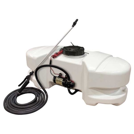

Haven't used it myself but has decent reviews and affordably priced.
Carry in the FEL when needed if you have one.

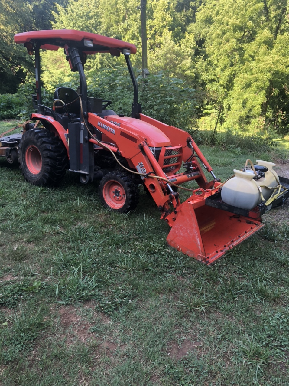

I use a
Master SAO-H3-015B-MM 15 Gallon Economy ATV Broadcast & Spot Sprayer-Everflo 2.2 GPM, 16 Foot Coverage​
sprayer which operates off of 12v clip leads to my Kubota B2150 battery. The leads that come with the unit are very handy/nice and give me an on/off rocker switch that I can hold onto from the seat of the tractor. Place the tank/sprayer/pump/unit in the bucket of the FEL and tip the bucket such that the spray head is aimed just right toward the driveway below. I chose a single head rather than some array of heads because of simplicity and avoiding trying to keep multiple spray tips clean and open all the same at the same time. You can vary the width of spray coverage by raising or lowering your bucket containing the sprayer with the tip sticking over the edge of the bucket. The wide spray pattern of this unit works great on my gravel driveway at a vacation place. Like you I have chronic nuisance issues with grass and weeds growing up in the gravel.
I use 2% glyphosate diluted mixture (diluted from the 41% concentrate bought at Tractor Supply.) That may be overkill on strength. I find 15 gallons covers a roughly 250 ft long circular driveway about 3 times depending on tractor speed. Also includes a couple of wider parking areas. You pretty much just have to do trial and error of tractor speed versus the fixed spray rate of these sprayers. I've been doing this for 3 years (summer seasons) now and have it down to a routine which is very effective.
The problem is inflation and the crazy prices ! In 2020 I paid $189 for this sprayer via Amazon. Now they are asking over $300. I think there ARE several other models down closer $200 but not sure of the nozzle arrangements or how good they are. On top of that , 2.5 gal of glyphosate 41% concentrate at TSC was $54 last year and is now $135 !! You just have to shop around and grab your billfold for protection.
In your situation with a 1300 ft (that's a quarter mile) driveway you would be spending a lot of $ at current prices to do that with the same method I described. Still, it depends on your time and circumstances. If the whole 1300 ft needs it that is probably the right way to do it. You might very well get by with a lower % glyphosate and not doing 3 redundant passes. I realize I am doing overkill.
The sprayer above has both the broadcast 16 ft spray pattern nozzle and feed as well as a separate hose and wand that you COULD use for manual spot treatment of problem areas. With that long a driveway you might want to broadcast spray the more "uniform weedy areas" and do the manual hose and wand for parts of the drive that have just spots of weeds/grass.
I used to use a hand carried 2 gal tank with a pump handle and wand which took forever to spray the entire 250 ft driveway (not spots.) Extremely tedious. Very happy now doing it in about 10 minutes per pass or less with the 12v / 15 gal rig and the small tractor.
