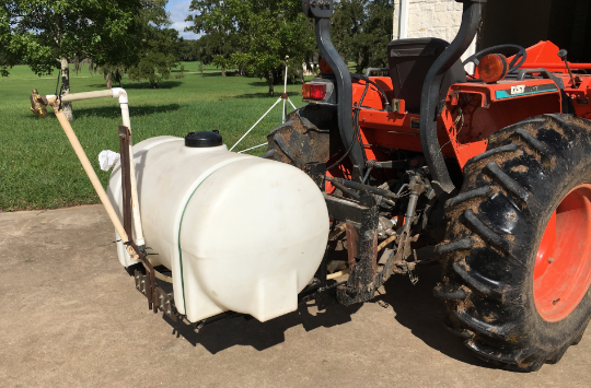

Some ideas. This is the setup that I dreamed about for years.

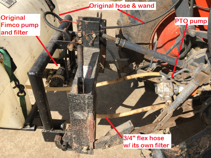

I started with the 25 gallon Fimco sprayer from TSC for the bed of my Mule. Legs broke after a while, so I salvaged the Fimco pump and wand and bought a 65 gallon poly tank from TSC. Custom added that setup to my non-FEL tractor with pipe that bolted to the frame - only required 2 bolts to install/deinstall:

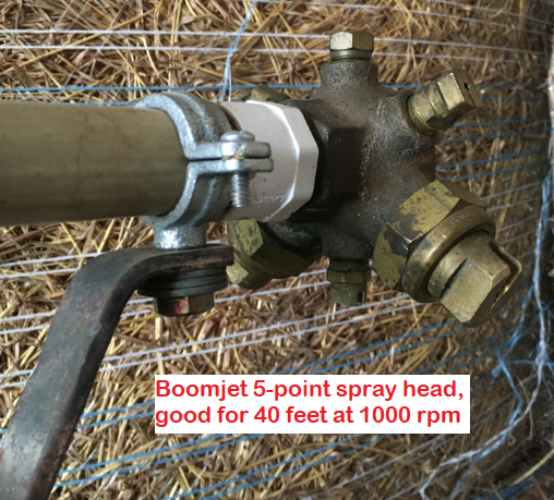

Sold that tractor and moved the sprayer to a larger Kubota with FEL. Modified the setup to utilize the 3 point in back instead of using the front. In addition to the electric pump, added a PTO pump and boomless spray head that will do 40 feet. Had to redesign the Boomjet spray head support a few times because the brass lead was too bouncy and rough on the PVC piping:
Detail:
Since the above pictures, I have added a second bigger Fimco pump that will run parallel w/ the original Fimco. Allows full pressure at the wand and each pump can be independently turned on/off. Wiring goes to an electric weatherproof port behind the operator seat, facing the 3 point.

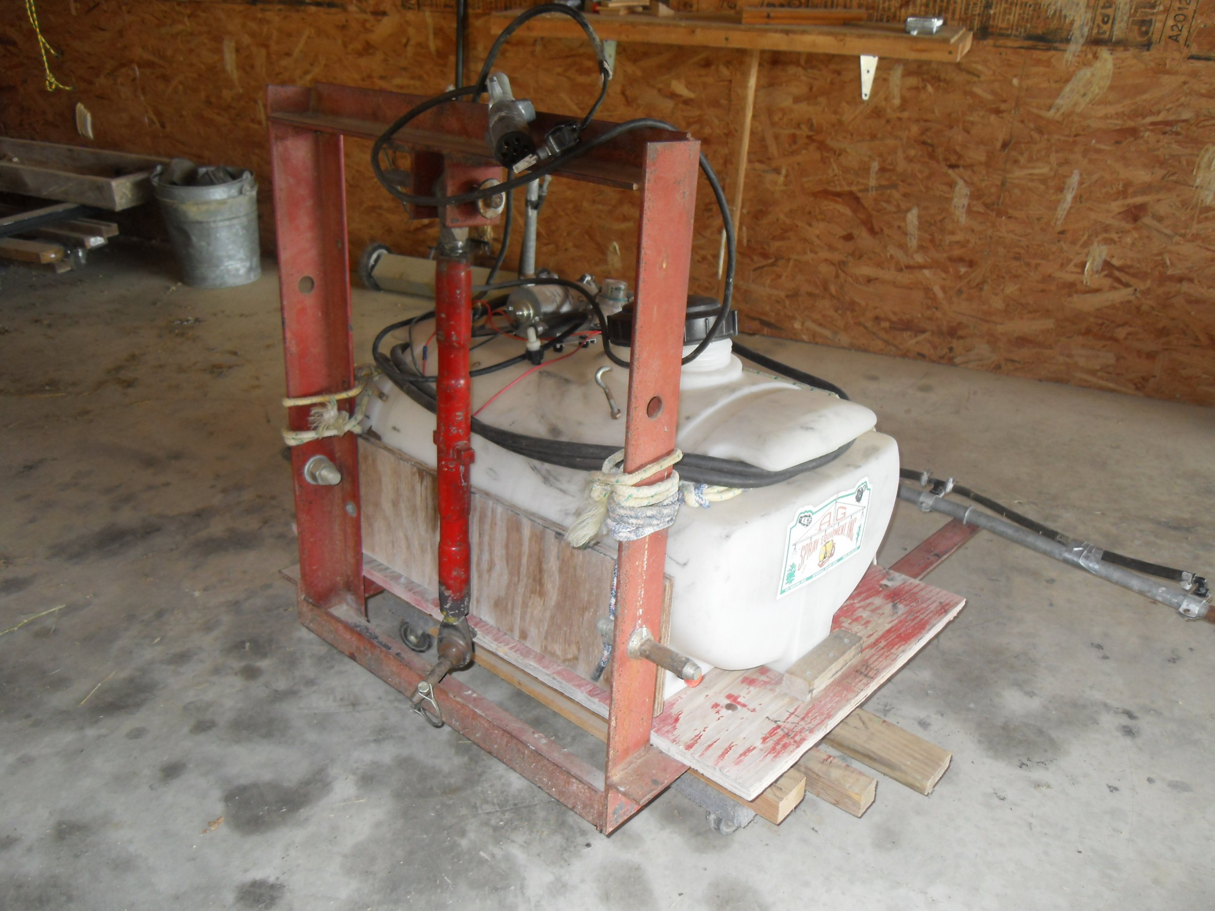

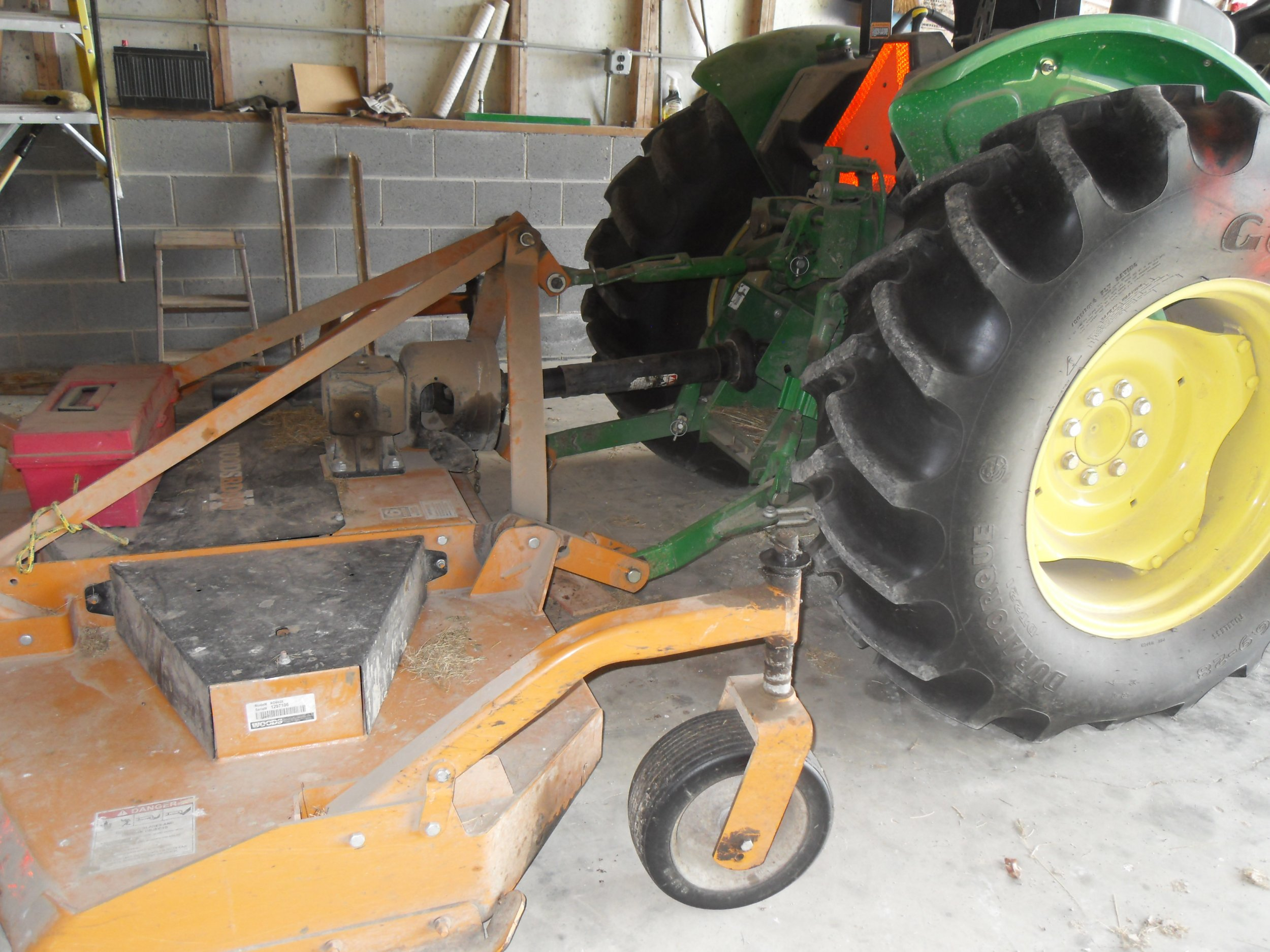

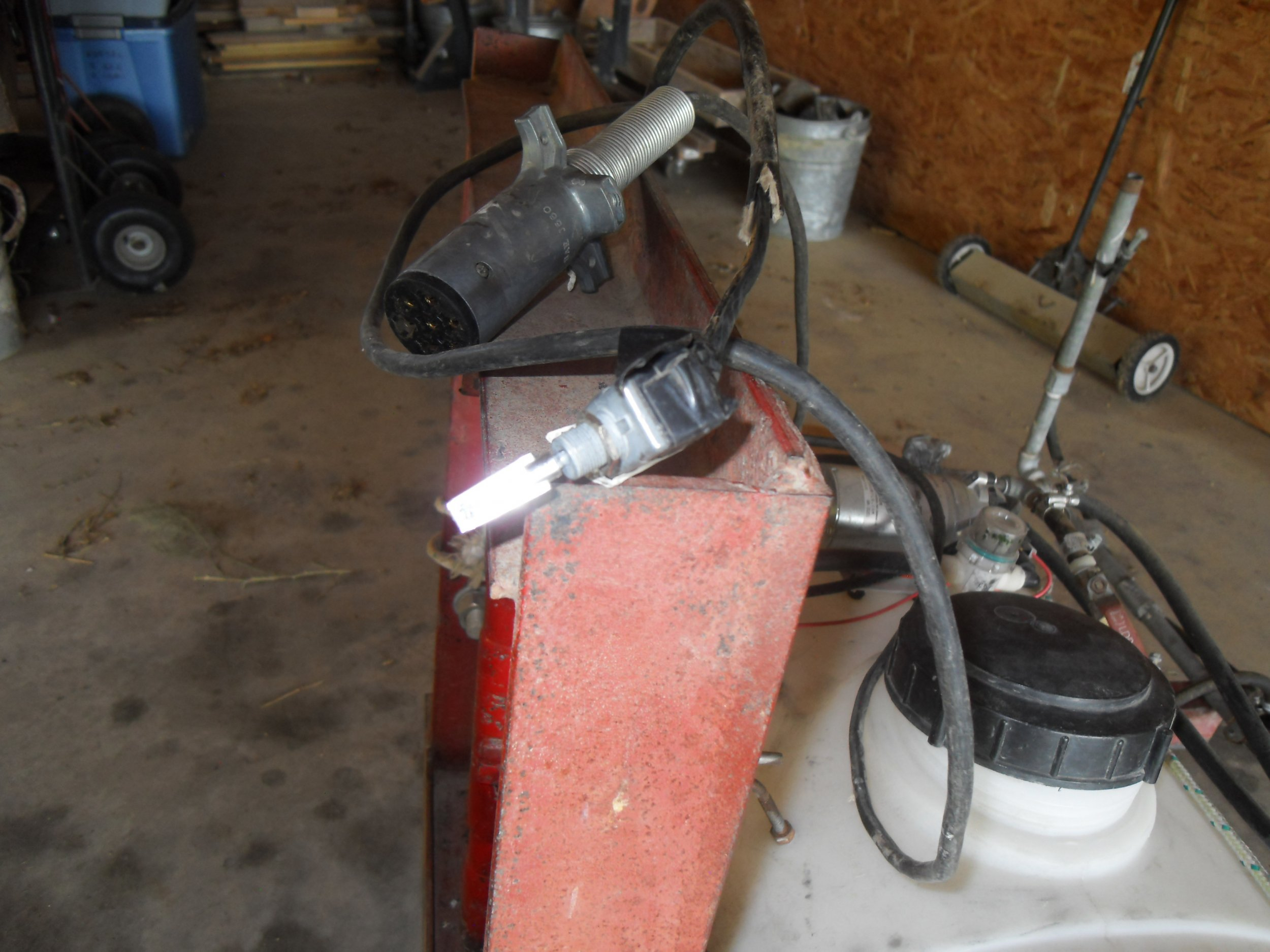

I have been wanting to replace the sprayer setup my husband made years ago. He set it up so the width could be half wide(changed manually), for spraying the sides of our gravel drive, which including side roads is 3/4 mile. The sprayer is 5 ft. wide. I like how it is powered from the back of the tractor(do not know what it is called, it is a plug-in, shown in picture, perhaps called a 7-pin connector)) and there is an off/on switch that goes from the sprayer over the seat to my right side(switch shown in picture). It is set up on a carry-all, which is kept on a piano dolly to move around. It is easy to maneuver, easy to connect to the tractor(pictured), and in the late fall I put in inside a covered building so the pump does not freeze. I have read the specs about your recommended sprayer on the NorthStar site. My questions: could this sprayer be set-up on my carry-all and be used similar to my current setup? Could this be setup to run off the back power source? To change from full width spray to either side or center spray, can that be done from the tractor or must it be done manually? The current sprayer is getting the job done but I am waiting for it to fall apart any day. Any suggestions appreciated.
The above post was supposed to be mainly for the CloverKnoll Farms posting.
Just read some reviews on this sprayer. Some do not like the size of the nozzle, saying they are too large. And the tank does not spray well when the water level gets low. Comment? Just curious, at what gear do most people spray at(gravel drive) and what rpms? I have been doing 2nd-1, 1500, does well enough but seems to take forever. 2nd-2 seems a tad too fast.
