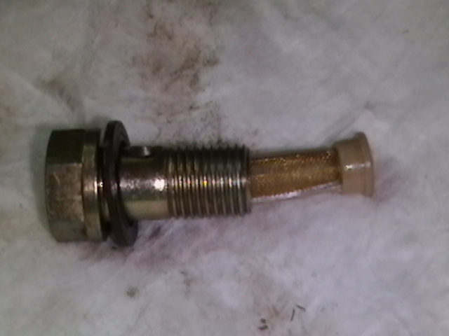

Just for the record my Taskmaster 425A has only the spin on fuel filter. No sediment bowl, line runs tank, shutoff, IP, fuel filter , IP then injectors.
Correct. The banjo fitting in the lift pump suction has a screen in it. That is your primary filter (such as it is) (there also may be a screen inside the tank). The spin-on is the secondary filter.

Thanks Bob, Have never had that off and did not realize it was there. Must be a little bugger.

Yep, most certainly is, and they can plug up pretty quickly sometimes. :)
