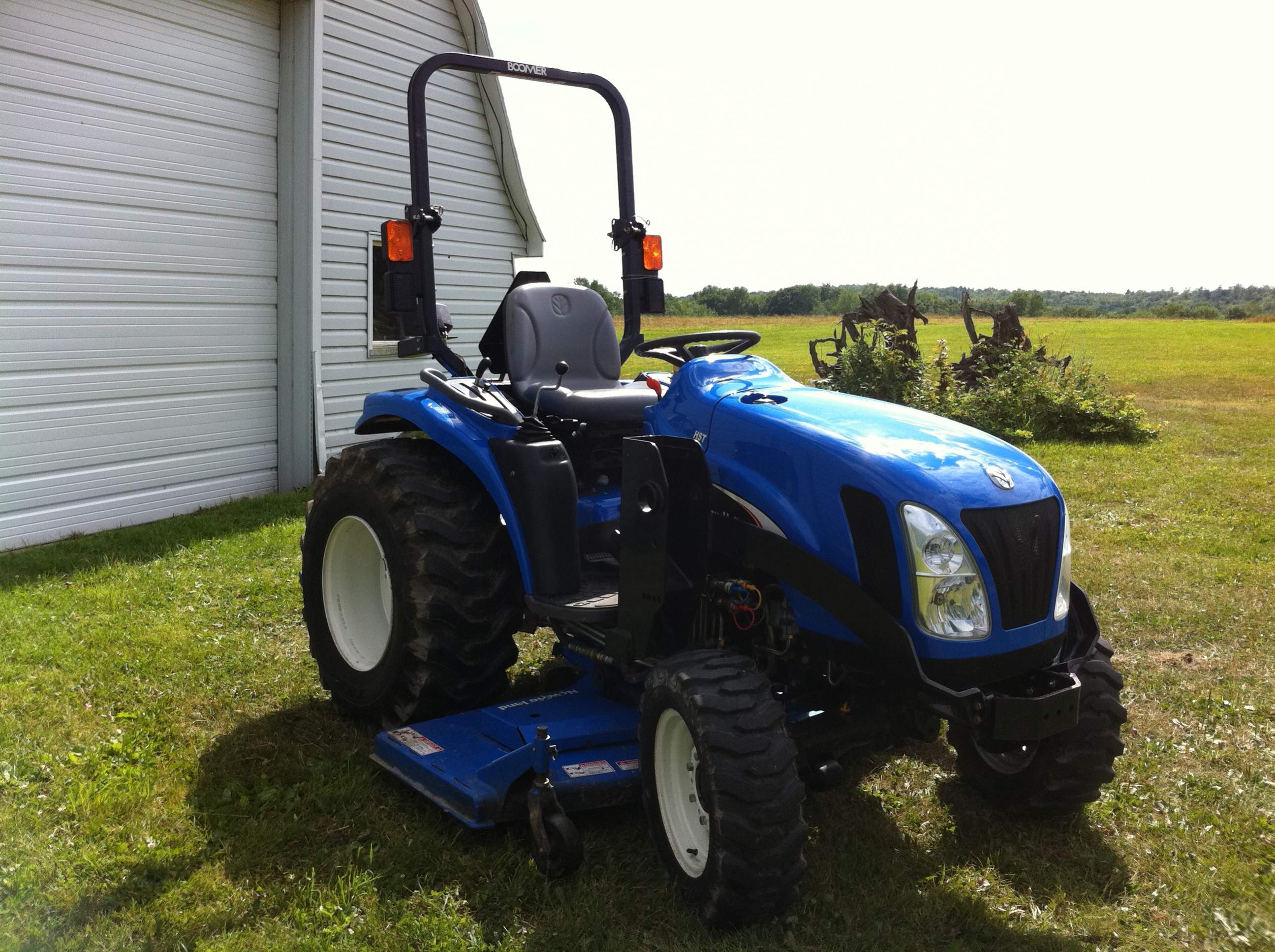

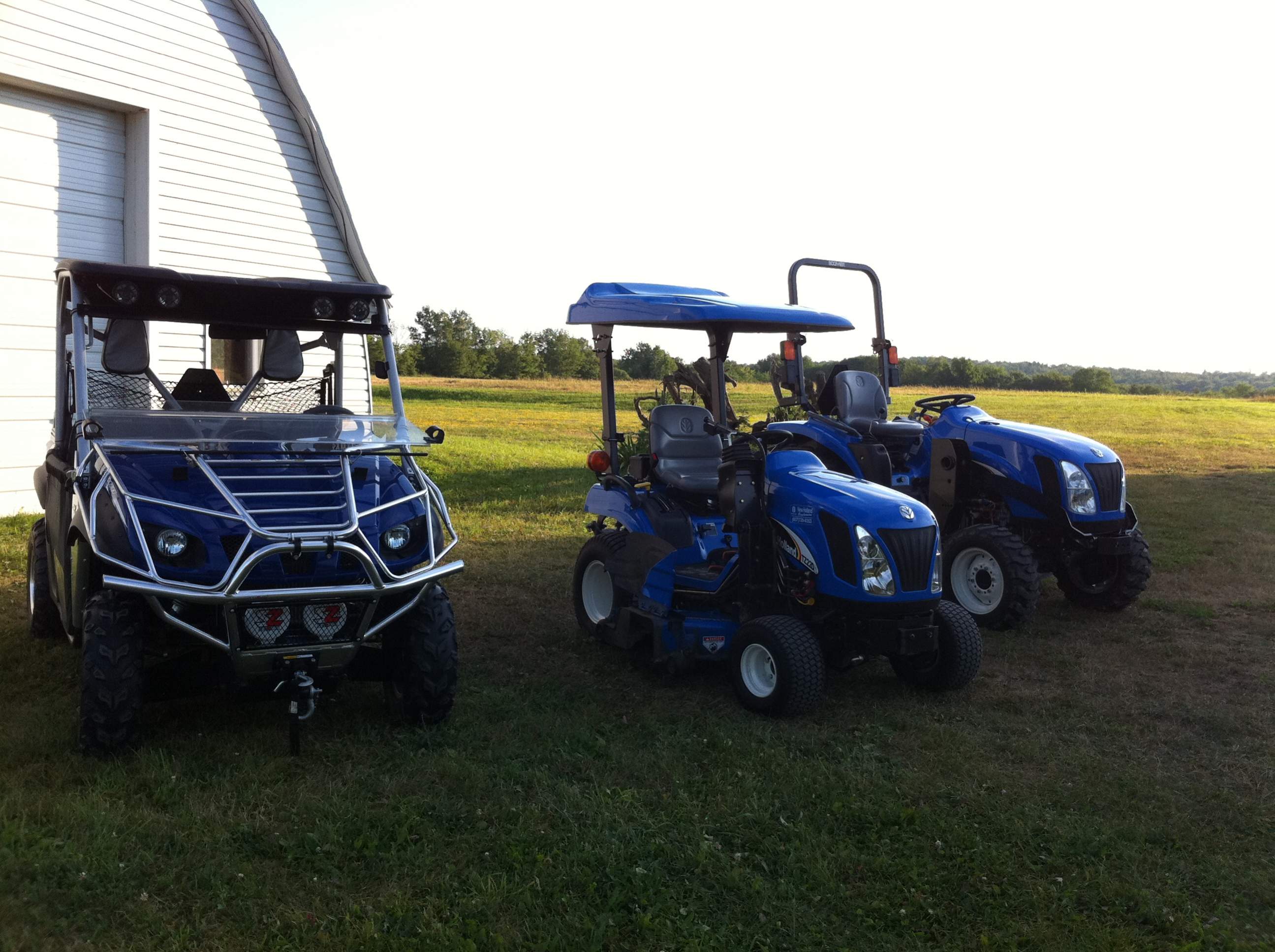

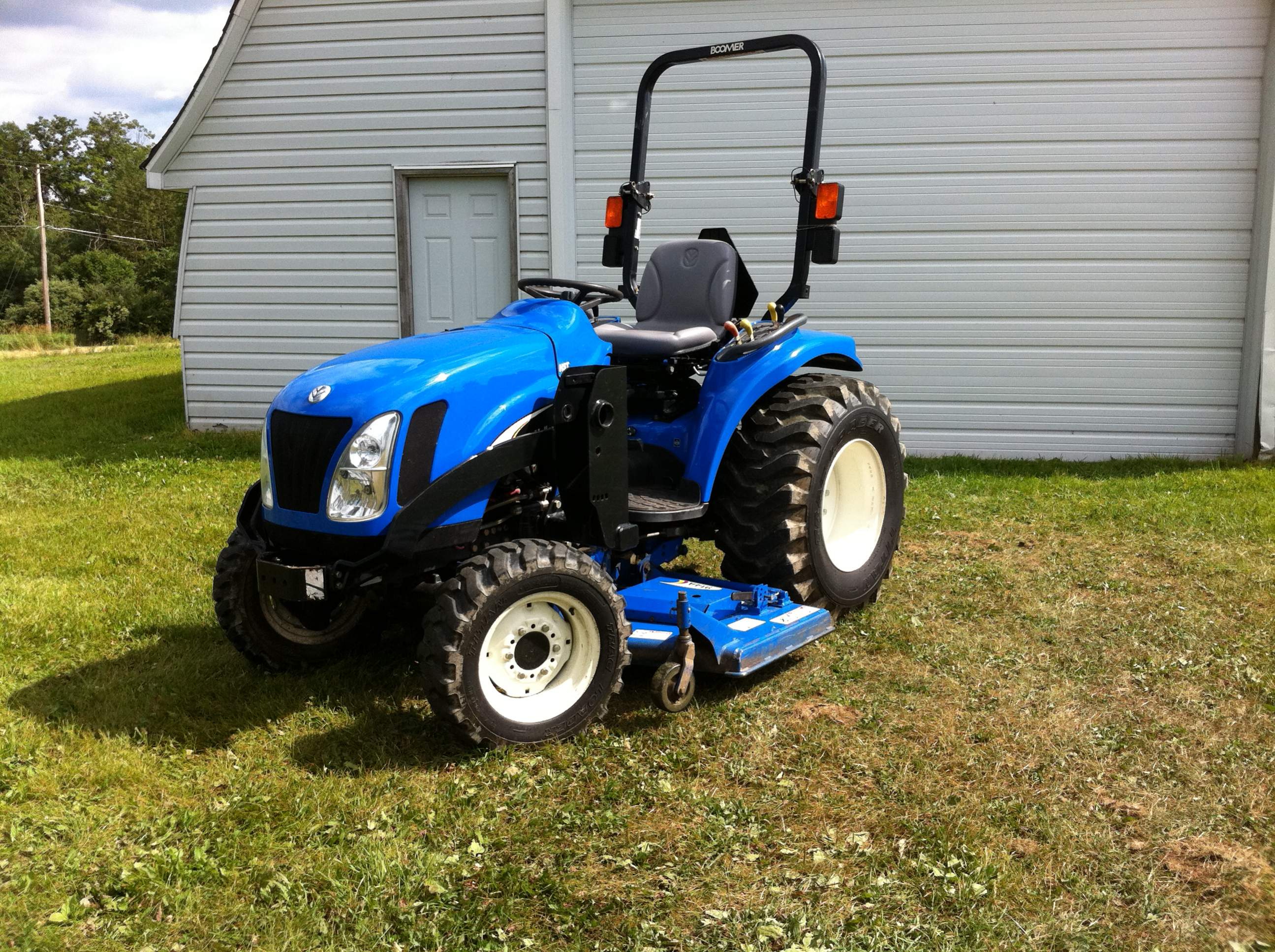

Elvis, I have to NH tractors. A TC34DA and TZ22DA. Both have 72 and 60 inch mid mount mowers respectively. We use the tz for under low trees and around brush however the TC34DA mows about 8 acres weekly in the summer. The 34 is fitted with an FEL and BH but both are left off for mowing. We have a couple of trickly little hills and grades and frankly done correctly I am very confident but careful vs dareful with tractor. We have 4wd with super steer, industrial bar tires and have no discernable markings in the lawn and have good traction on the hills. I have also used 4wd on mildly soft lawn with no damage. I love these tractors they have NEW HOLLAND mowers .

I'm not sure what super steer is :)...
Super Steer was on the NH Boomer series tractors. IIRC, the entire axle turned as well as the steering knuckles. That resulted in a very short turning radius.
Super Steer wasn't available on the TC-30.
