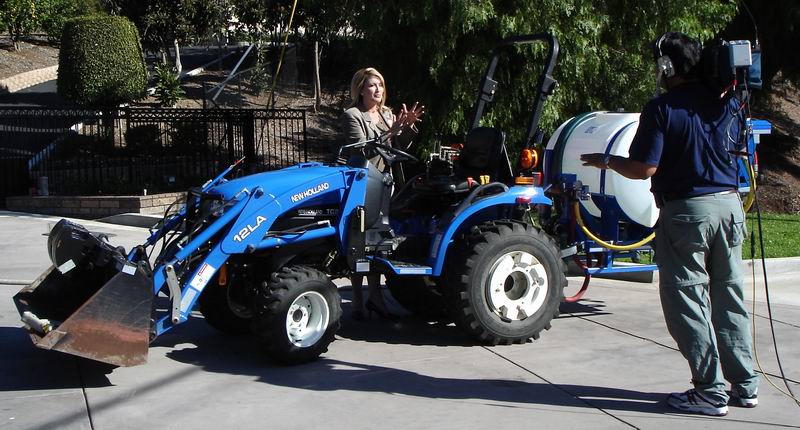

Cool! I made it national. Now I am up to 17 minutes of fame.
We had someone stop by saying that a major tractor manufacturer might be interested in the rig. I am holding off mentioning whom but some of you may guess it. I was asked if I could get the weight down and lower the cost of production. Also if I could make it safe for use by a home resident who also uses thing like a brush hog or heavy backhoe attachment.
I have already shared lots of details on the fire rig with many here but I could write a book on exactly what I had to do. It really is not a spray rig in the typical sense. I can’t see anyone using 30GPM at 290 PSI to spray Roundup from a hand nozzle. I do see it being used for irrigation, dust control, cleanup and spraying of large orchard trees.
Many of our fellow members could benefit from this type of attachment.
If you care about the safety of your home, crop, preserve. Then maybe it’s worth building one or buying one. To me it seems like cheap insurance when your home could go up in flames while your tractor just sits there uselessly.

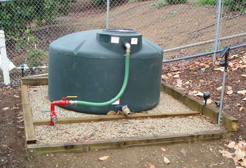

Wvhillbilly, thanks for your professional insight on fire fighting. Our engine was built to Class 7 wild land specifications. In matter of fact it is on the upper range. And you are right; we will go through our water supply real fast. That is why we have installed 3 full flow wild land hydrants on our property. All are capable of flowing over 30GPM. In addition we have a 550-gallon tank in case the water supply dries up during a wildfire situation.
We do not live all that far from the station 15-20 minutes MAX. It has more to do with the 911 system that routes our call to the wrong county and the winding road that would make a direct route to us. Basically the fire depart has to take three legs of a rectangle to get to our place and beyond. So why not lend them a hand on my side of town. (they really could use a second station)
The drill for us is that we (wife?) calls 911 I move the tractor into position she pulls the hose and gives me the thumbs up to start the pump (150 PSI) then I go hook up to the hydrant and hopefully get back prior to going through our water supply. I then take over the hose and my wife increases the pressure to 200-250 PSI at the nozzle. She then backs me up and coordinates with fire or law enforcement when they arrive.
The attachment goes on and off with little pain but is not something you want to do in a panic. We leave it on when we don’t need to use our regular attachments. And since we have the orchard we end up spraying a lot of water most of the time.
Our fire rig attachment was really built to take care of brush fire dangers. And as a first response to any fire. Fire is really serious business and has it’s danger associated with it. But like our tractors that I consider dangerous pieces of equipment. Training, practice coupled with common sense is really all one can do to keep one’s self out of trouble.
I have attached a picture of the water tank and home made hydrant system.
LAGEORGE

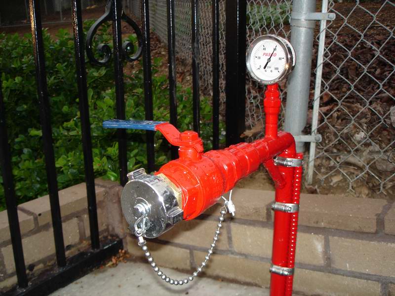

Picture of the lower hydrant with pressure gauge (kind of low at 60 PSI)
It’s coupled with a 1 ½ inch NST male tread hose connector.
