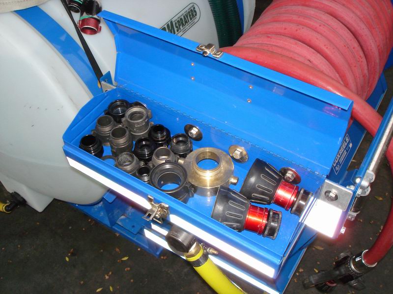

I added a small cheap “blue painted” tool box to the side of the reel to hold all those Forestry type fittings and adaptors that one would need to gain water from various sources including a garden hose /forums/images/graemlins/shocked.gif. Also I have additional nozzles that allow me to vary GPM as water supplies allow.
In wild land fire fighting it’s all about the pressure!
Nozzles range from 6 GPM to 30 GPM at 100 PSI (I use 150 PSI as my target pressure at the nozzle)
Fittings range from ¾ GHT to 2 ½ NST mainly aluminum ones are used.

</font><font color="blue" class="small">( HA HA on that parts list, you were poking fun at me, yes? )</font>
No, really.
It would be neat to see at least a major component or supplier list.
Most of us are ignorant of these types of attachments, but always eager to learn.
For example - where did you find the fire hose nozzles? Or the tank? Is the tank just a skid mounted sprayer that you modified?
I'm sure the whole community wants to know! /forums/images/graemlins/blush.gif Please enlighten us. /forums/images/graemlins/cool.gif

Ok, here are the major players for my project.
PBM Mfg. in Calif. - Custom built “3 point fire sprayer” with Hypro D115 PTO pump, 110 gallon tank, Cox hose reel painted New Holland Blue!
Cascade Fire Equipment - adaptors, fittings, suction hoses and lots of ideas! great catalog
National Firefighting Equipment - adaptors and clothing ECT.
Banjo Corporation - 3 way valve and hose fittings (tank)
Cordova Fire Equipment – makers of Forestry nozzles and fittings
Wildfire Equipment – Forestry equipment sales
Red head Brass LLC. - Custom adaptors (real nice stuff!)
Darley.com – huge fire fighting site including equipment sales and very custom fittings and great 1-inch booster hoses! /forums/images/graemlins/cool.gif
Grainger – stainless steel fittings, nipples (1 inch and 1 1/2 inch)
Lowes Home Improvement – OK full flow valves ¾ inch up to 2 inch in size
The John M. Ellsworth Company, Inc.- brass fittings and stuff
homefirefightingsystems.com – inspiration! /forums/images/graemlins/smirk.gif
National Wildfire Coordinating Group (NWCG) – government construction specifications for forestry gear
I also had to get out my one and aquire additional pipe wrenchs and learn a lot about plumbing. Also used lots of Teflon tape and pipe dope.
Now you too can go out and build one as well. /forums/images/graemlins/laugh.gif
