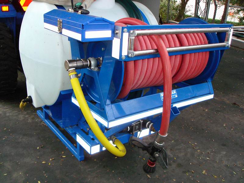

I added a small cheap “blue painted” tool box to the side of the reel to hold all those Forestry type fittings and adaptors that one would need to gain water from various sources including a garden hose /forums/images/graemlins/shocked.gif. Also I have additional nozzles that allow me to vary GPM as water supplies allow.
In wild land fire fighting it’s all about the pressure!
Nozzles range from 6 GPM to 30 GPM at 100 PSI (I use 150 PSI as my target pressure at the nozzle)
Fittings range from ¾ GHT to 2 ½ NST mainly aluminum ones are used.

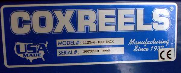

Is your reel motor driven (electric or hydraulic) or manual?
The CoxReels web site link was very helpful - with google all I had found were resellers that only carried bits and pieces of their line. Their products seem like very high quality.

Ok, here are the major players for my project.
PBM Mfg. in Calif. - Custom built “3 point fire sprayer” with Hypro D115 PTO pump, 110 gallon tank, Cox hose reel painted New Holland Blue!
Cascade Fire Equipment - adaptors, fittings, suction hoses and lots of ideas! great catalog
National Firefighting Equipment - adaptors and clothing ECT.
Banjo Corporation - 3 way valve and hose fittings (tank)
Cordova Fire Equipment – makers of Forestry nozzles and fittings
Wildfire Equipment – Forestry equipment sales
Red head Brass LLC. - Custom adaptors (real nice stuff!)
Darley.com – huge fire fighting site including equipment sales and very custom fittings and great 1-inch booster hoses! /forums/images/graemlins/cool.gif
Grainger – stainless steel fittings, nipples (1 inch and 1 1/2 inch)
Lowes Home Improvement – OK full flow valves ¾ inch up to 2 inch in size
The John M. Ellsworth Company, Inc.- brass fittings and stuff
homefirefightingsystems.com – inspiration! /forums/images/graemlins/smirk.gif
National Wildfire Coordinating Group (NWCG) – government construction specifications for forestry gear
I also had to get out my one and aquire additional pipe wrenchs and learn a lot about plumbing. Also used lots of Teflon tape and pipe dope.
Now you too can go out and build one as well. /forums/images/graemlins/laugh.gif

The reel is manual but I could use the workout any way. Electric would be real nice but adds weight and cost.
An additional note, it is almost mandatory to have a hydraulic top link since the geometry of the 3-point lift changes radically as you lift the rig higher off the ground. The hydraulic link allows you to keep everything water level.
LAGEORGE
PS: Call COX Reels, they will help you find a place where one can get the stuff. The quality is good enough for my purpose.
