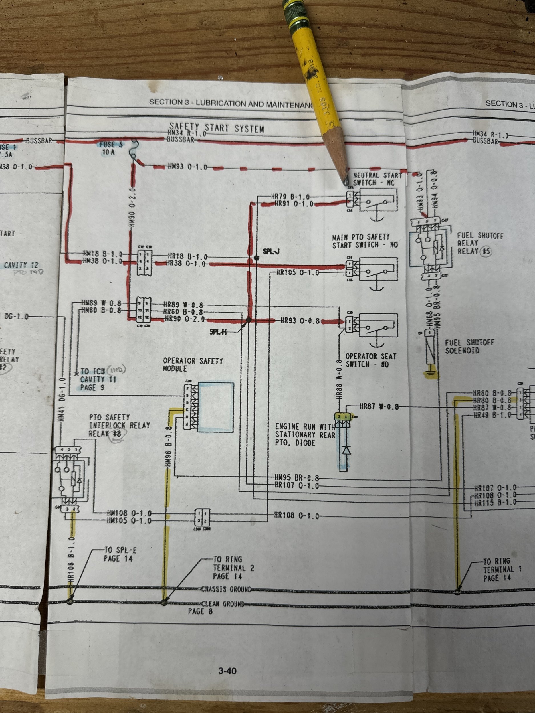

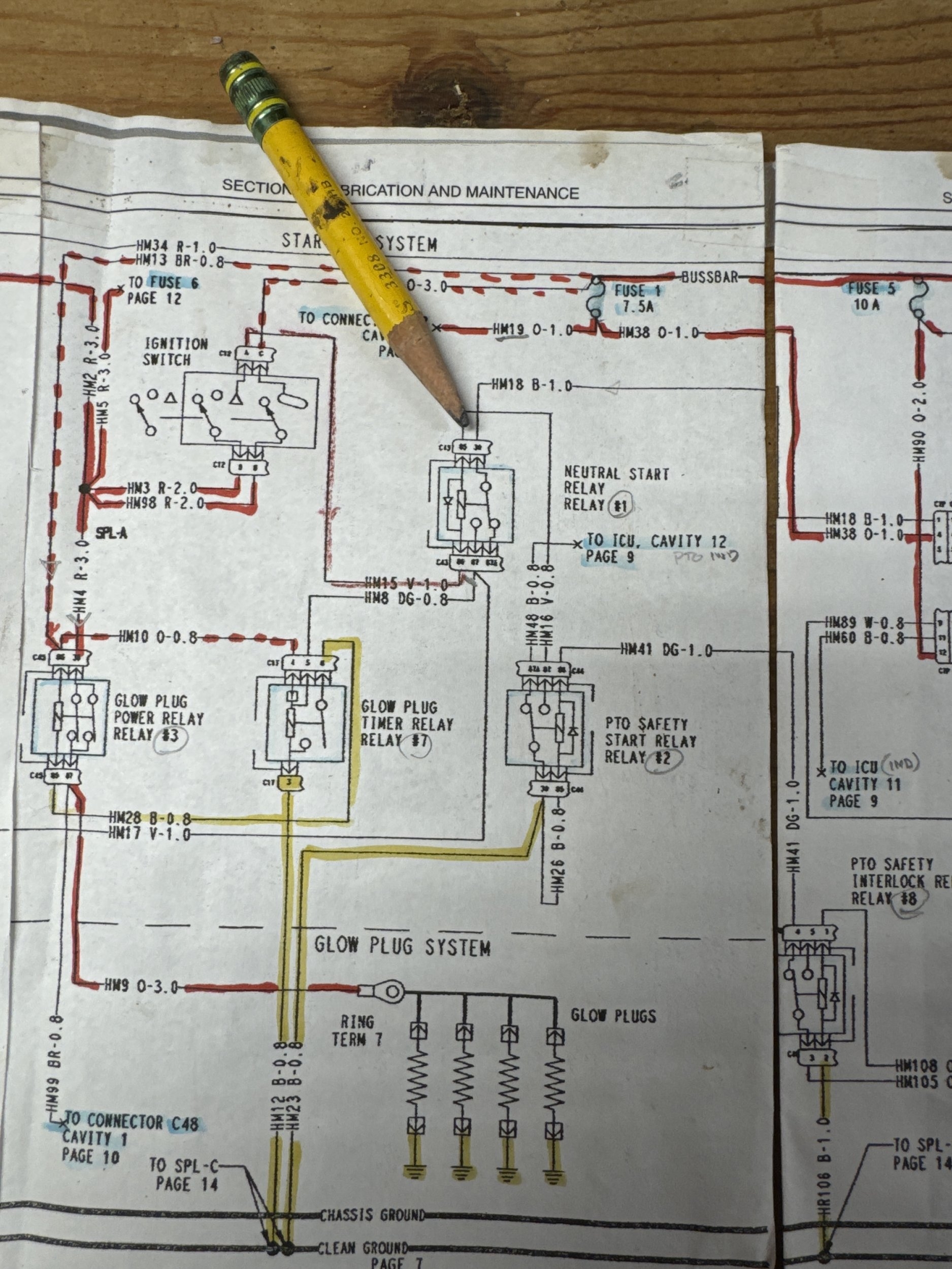

hello everyone. first, i have read and re-read every post of tc29d's various starting issues. however, none have solved my starting issue. second i have checked, rechecked every fuse with a ohm meter to make sure they are good. third, all of my safety switches are working (seat, pto and neutral). each have 12 volts coming in and going out. fourth, i have checked voltage at the solenoid (hm17) and there is no voltage when i turn the key.
with all that said, i suspect the issue is related to the fact that i have no voltage on pin 3 in either the neutral starter relay or pto safety relay.
i do have pin 30 voltage on the glow plug power relay (pin3) , the glow plug timer relay (pin 4) and the fuel shutoff relay (pin 4).
does anyone have any idea why i am unable to get a voltage on either neutral or pto relays?
when i turn the key, what for the glow plug light to turn off, turn to momentary start, i hear a click in one of the relays but tractor acts as if there is no battery.

agree with your statement. but it was tested under start attempt and the battery stays steady.
there is voltage at every location you'd expect before, after turning key to on position and after turning key to start position. except pin 30 on the neutral start relay. so when the key sends voltage to pin 87 (which it does when in the start position) and the relay clicks closed (which it does), there is no voltage on pin 30 to transfer to the solenoid like it should to start the tractor. yet, there is voltage on both sides of the neutral safety switch when key is turned to on position. connectivity between the neutral safety switch and relay has been tested for continuity and it checks fine. i am super confused!!!!

#11
last pix pencil shows where there is no voltage. one above it shows where there is voltage ...

just to close this out. it turned out that a 3" wire with a plug in style connector was bad. the connection was broken under the rubber coating covering the wire and connector junction. unbelievable that is was that simple. took me three weeks and repeated attempts to tract down the problem. but, its fixed!
