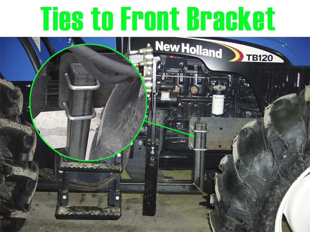

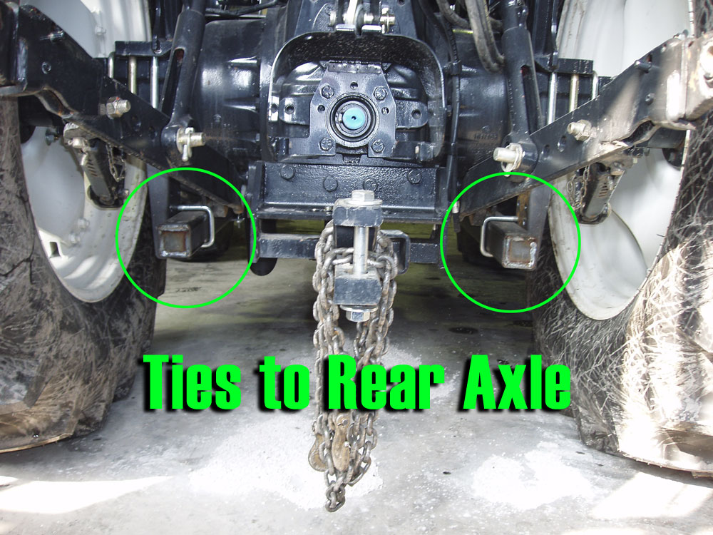

You guys have no idea how true this statement is!!! We deal with this everyday, it is extremely difficult to compare "apples to apples" in the loader market. The most common example we see is when the breakout force is advertised instead of the working capacity of the loader. Other include: lift capacity measured at 59" from the ground instead of full height or measurements closer to the tractor (at pins) without an attachment...
We suggest not to get confused with the numbers game, but really take a look at the construction, fit, features like quick attach or easy grease pins, and how the loader is mounted and dismounted from the tractor.
I've attached some photos of a Rear Axle Kit, I had to look quite awhile for an example on a NH tractor, this tells me they have very well built frames.

I don't think I would worry about a rear axle kit on a TC 30 or any NewHolland that did not come with one for the factory Loader. Without an engineering back ground on NH equipment how would you know you are helping or hurting a already good design. You could install braces alot of places but you may create other problems and transfer stress where it was not designed. I am not a expert at all but I would do a lot of research before I bought a aftermarket Loader that mounted a whole lot different than the Factory. Also after searching I cannot find any other Broke TC 30's besides the ones on Compact Tractor Review and I belive this is one complaint posted many times and with a BH which could add a lot of stress if used incorrectly. Remember Thousands of these have been sold over the last ten years.
