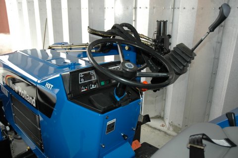

ok...here are the newer pics i promised...
View of dash and FEL controls.

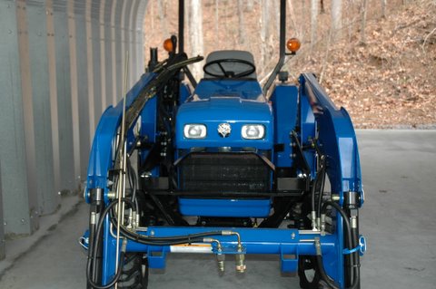

View from front showing 3rd function connections.

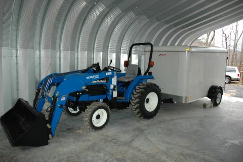

Last pic...
Parked after hauling utility trailer into building.

Congratulations Gumby! Thanks for the pictures. I love the location of your house. It looks like the kind of place you will always have a job for that beautiful new tractor. I'm also envious of your building. That is a very nice addition for keeping your tractor out of the weather and providing a place to do work and maintenance. I bet it's impossible to wipe the smile off your face. /forums/images/graemlins/smile.gif
